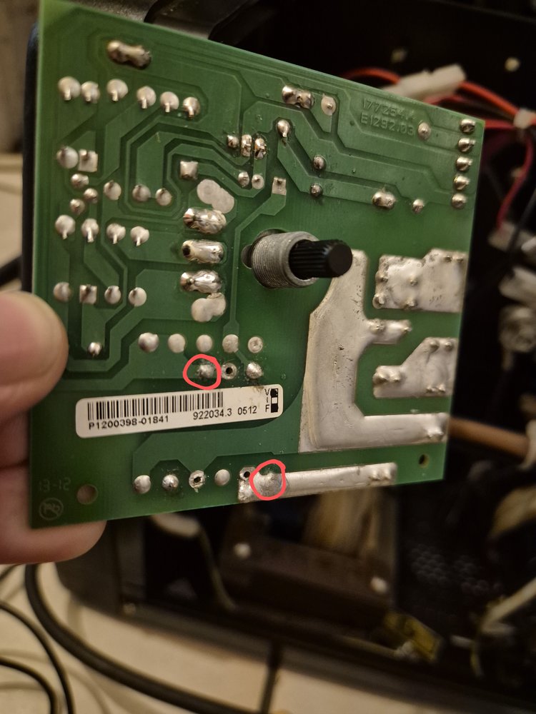

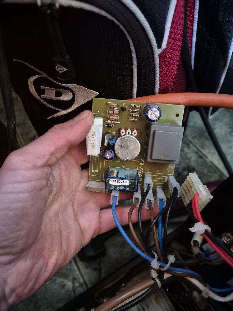

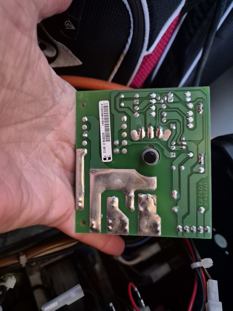

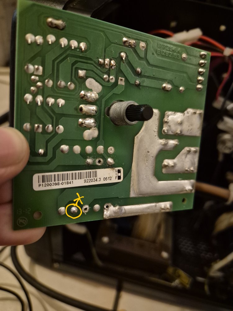

Please help, I feel like I have tried everything and close to giving up.
I borrowed a Clarke 130EN from someone locally and after a few weeks of working perfectly, it suddenly stopped working.
The machine powers on and the fan (turbo) engages but when pulling the trigger, nothing...not even the relay clicks.
I have power to the PCB, and replaced the transformer as I couldn't get continuity across the primary.
If it remove the cover from the relay and hold down the switch, everything works.
If i put an external 12v to the relay, it switches.
It seems like I am not getting the 12v to the relay that I need, but I can't seem to understand what provides 12v to the relay
Ah man, I feel dumb right now. I just noticed the left primary terminals is also in a different hole which isn't even connected to the track.
