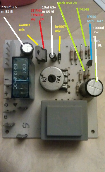

I still don't feel happy about that reading you are getting on the secondary winding of that transformer, to be honest.
You are getting a very low reading where I would expect you to be getting around 20 - 30 ohms on that secondary.
When making a reading on his secondary winding on a similar transformer here:
http://www.mig-welding.co.uk/forum/showthread.php?t=30536&page=2
mini mad got 32 ohms. If he was doing everything correctly, that would suggest yours should be somewhere around the same range, I would expect.
