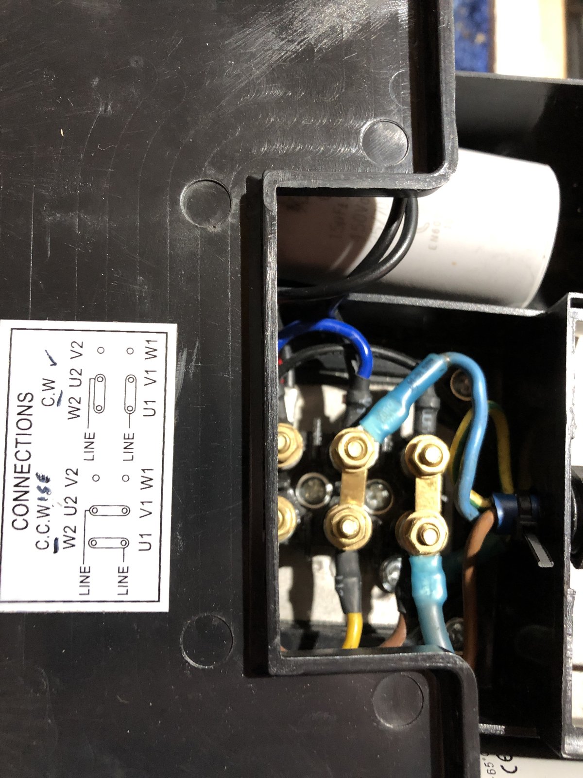

Is that how to wire it what’s line mean power inWhat else do you need? You have all the information on that plate.
it how I was told in machine martYou've got the power on the wrong terminals FFS. Look at the diagram LINE is your incoming power wires go.
That's the reason I bought it it was going to be too much hassle for me to reverse the old oneAlso note, CC counter clockwise CW clock wise rotation
Only if you sit on itThat thing is an electric chair the way its wired![]()
its not 3 phase at all its 240 vThis is it without any wires connected
Honestly I asked in the shop so he took the cover off and said brown to brown blue to blue and yellow to yellowI hardly think anyone would tell you to connect the earth to a winding![]()
Thats what i was wondering? i am guessing no rcd anywhere, so the earth was just working as a second neutral connection.Just to be sure, you have wired the earth to the casing of the motor?
Do you have RCD protection on the supply to that? It should have tripped out before!
