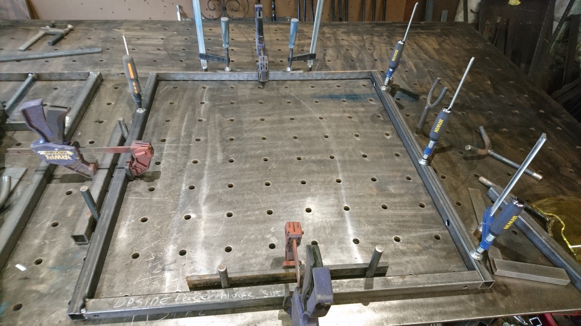

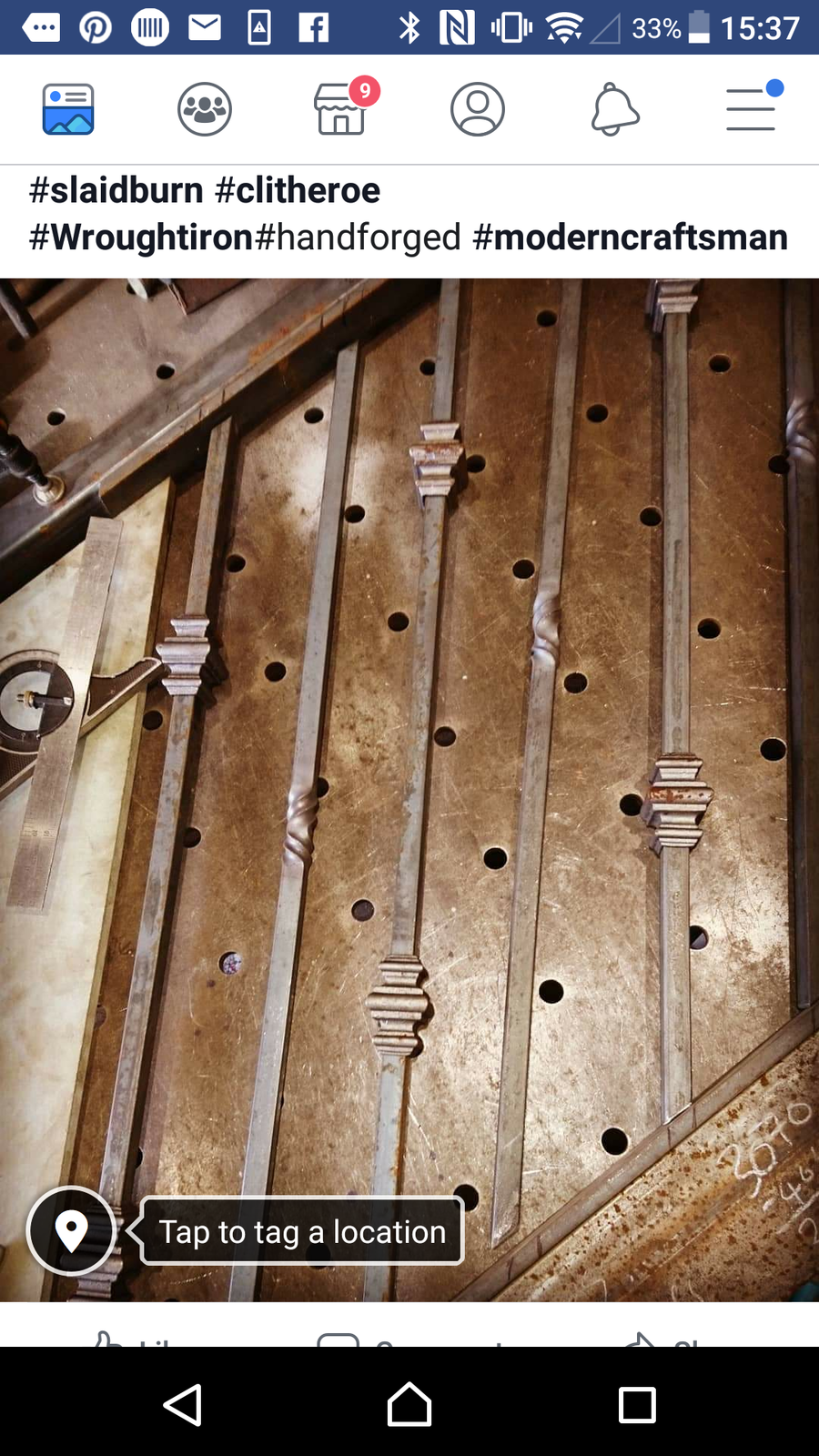

I have loads of cheapish f clamps they are very useful and i modify many for use on the bench by adfing a 16mm peg. View attachment 170415

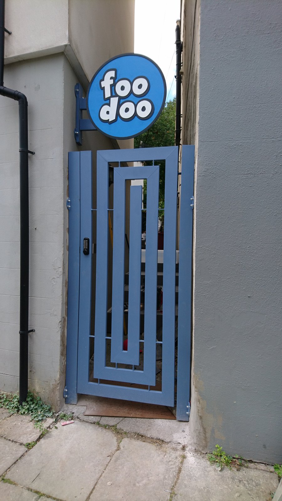

Yes i hardly used them in the past. However i am a total convert nowadays. To be fair i can lay out an entire gate say without a single tack. Remember i aint even laying a square on it because of my peg system bench.Thats a lot of clamps on one little frame![]()
A lot depends on what you make. However i seriously wouldn't want to make another of these without the bench and clamping system. Remember if it was a batch (something i rarely do is another the same let alone a batch ) the time saving would be immense (could mean puttingbin a cheaper bid than a competitor or making substantial extra profit)I was in the store last week, and had a good look at the clamps section up the end there. I must admit, I was quite impressed by the feel of them, and a decent range for day to day use. I nearly bought some, but spent my dosh on other stuff instead![]()

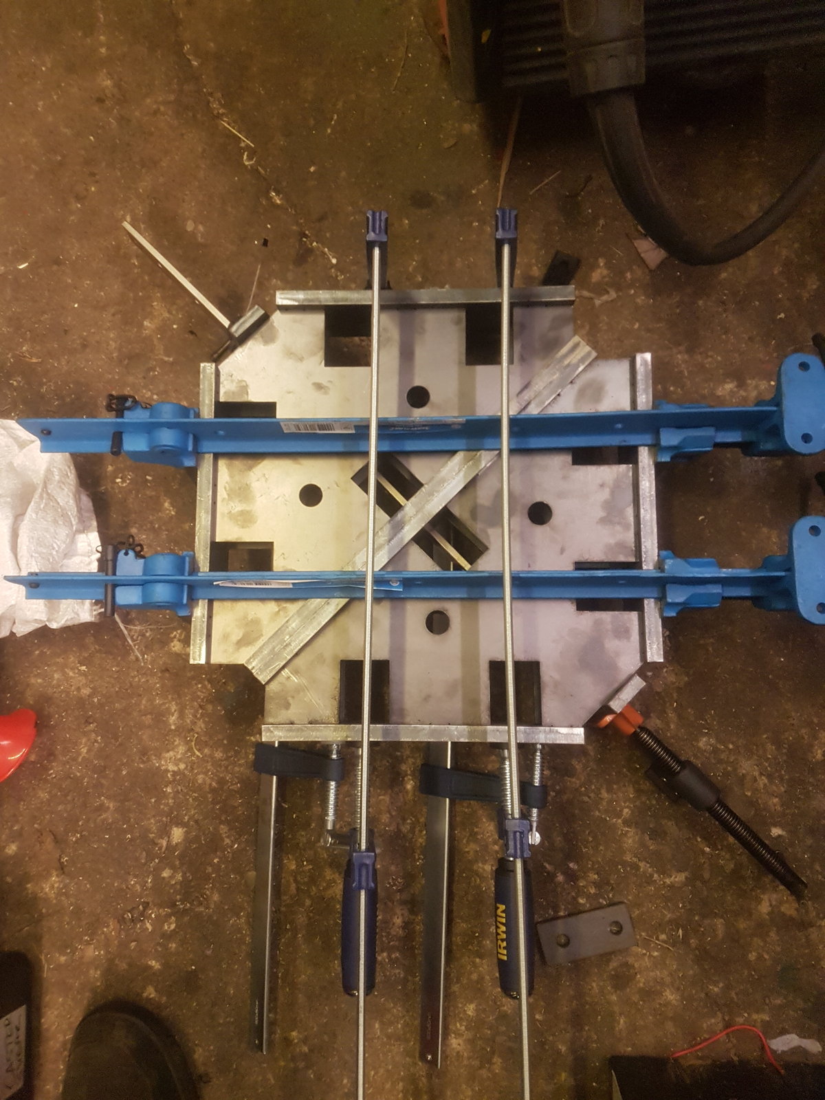

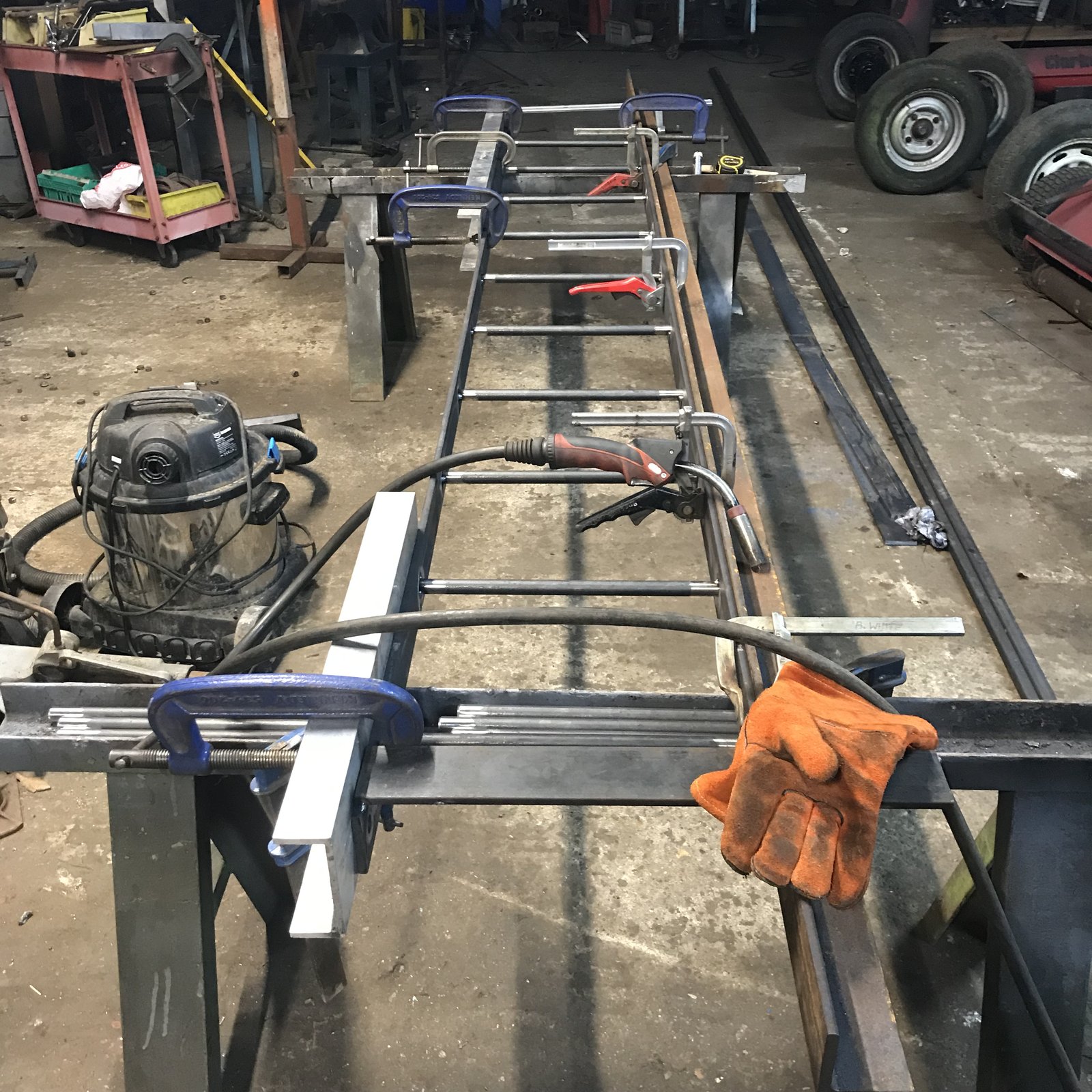

If thats not s ladder your gsps sre waay big lolRight mixture of clamps here. Kennedy Extra Heavy duty, Bessey Quick Clamp, Roebuck copy of bessey, Bessey c Clamps, Bessey F Clamp
This is on the list of roundtuits that I never seem to get done.I have loads of cheapish f clamps they are very useful and i modify many for use on the bench by adfing a 16mm peg. View attachment 170415
Yeah it’s a ladder mate haha.If thats not s ladder your gsps sre waay big lol
