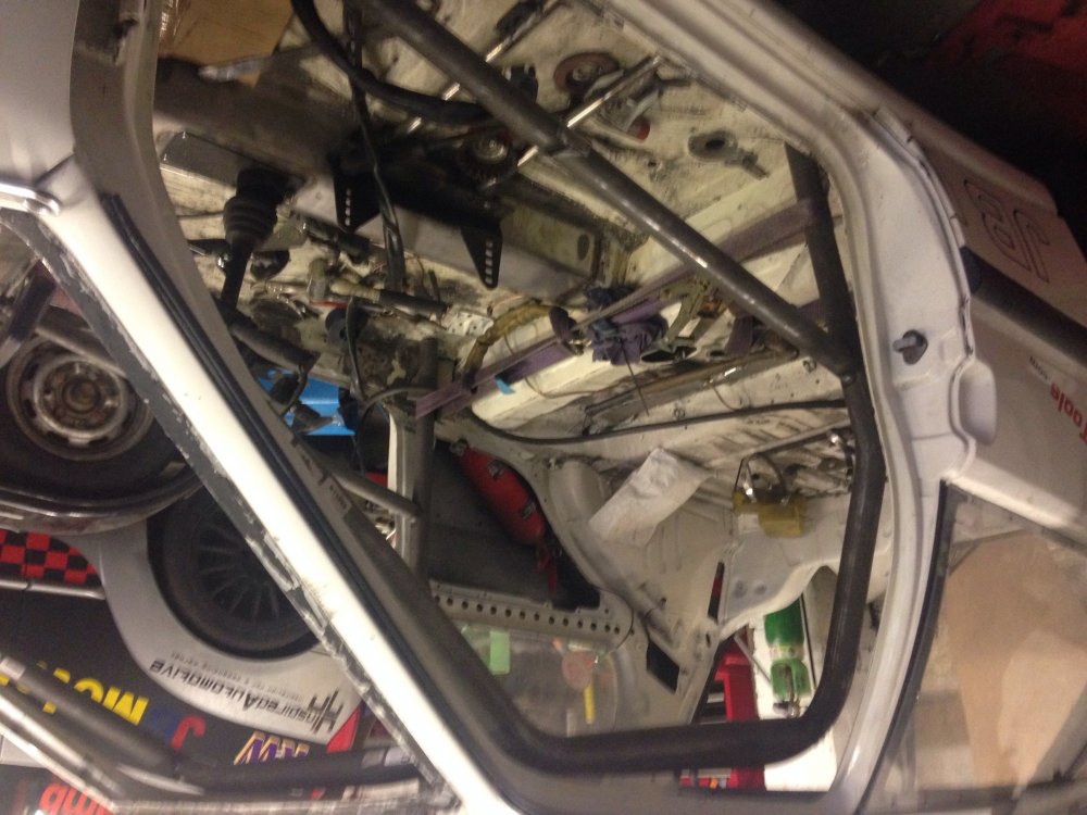

Good job you fitted the roll cage with the car being upside down.....
Bit of plastic drainpipe and some chrome paint. At least it won't come out and smash your skull in like a show cage if you do crash it.
Actually hate show cages with a passion, you'd be better of spending the extra 50 quid on a proper half cage, all or nothing I believe tho! Ha ha

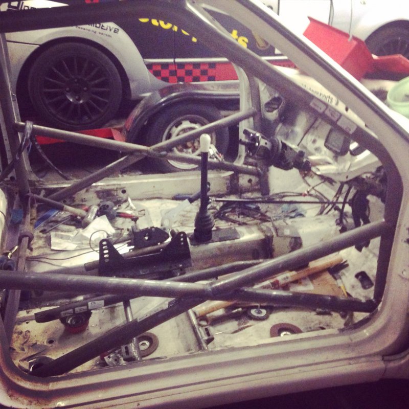

Making progress later today I hope too![]()
Hillman - not great to be honest, the a pillar bars don't line up as in the pic above, I contacted CC who's senior fabricator suggested I tack it into position on the main hoop and use the door bars to stretch it into line. With the help of my mate, who isn't that small, we tried that last night, to pull it straight is quite a long way and we need a hydraulic ram or something, we didn't get anywhere near by hand. I'm not sure having it under that much constant stress will do it any good either really.
so today im going back to them and seeing if they can sort something for the weekend for me, as I've booked it off work to fit this damn thing :/
you look to be making better progress though!
Not many do fitOr a cage that fits![]()
its universal =Or a cage that fits![]()
that means u have to make it fit
