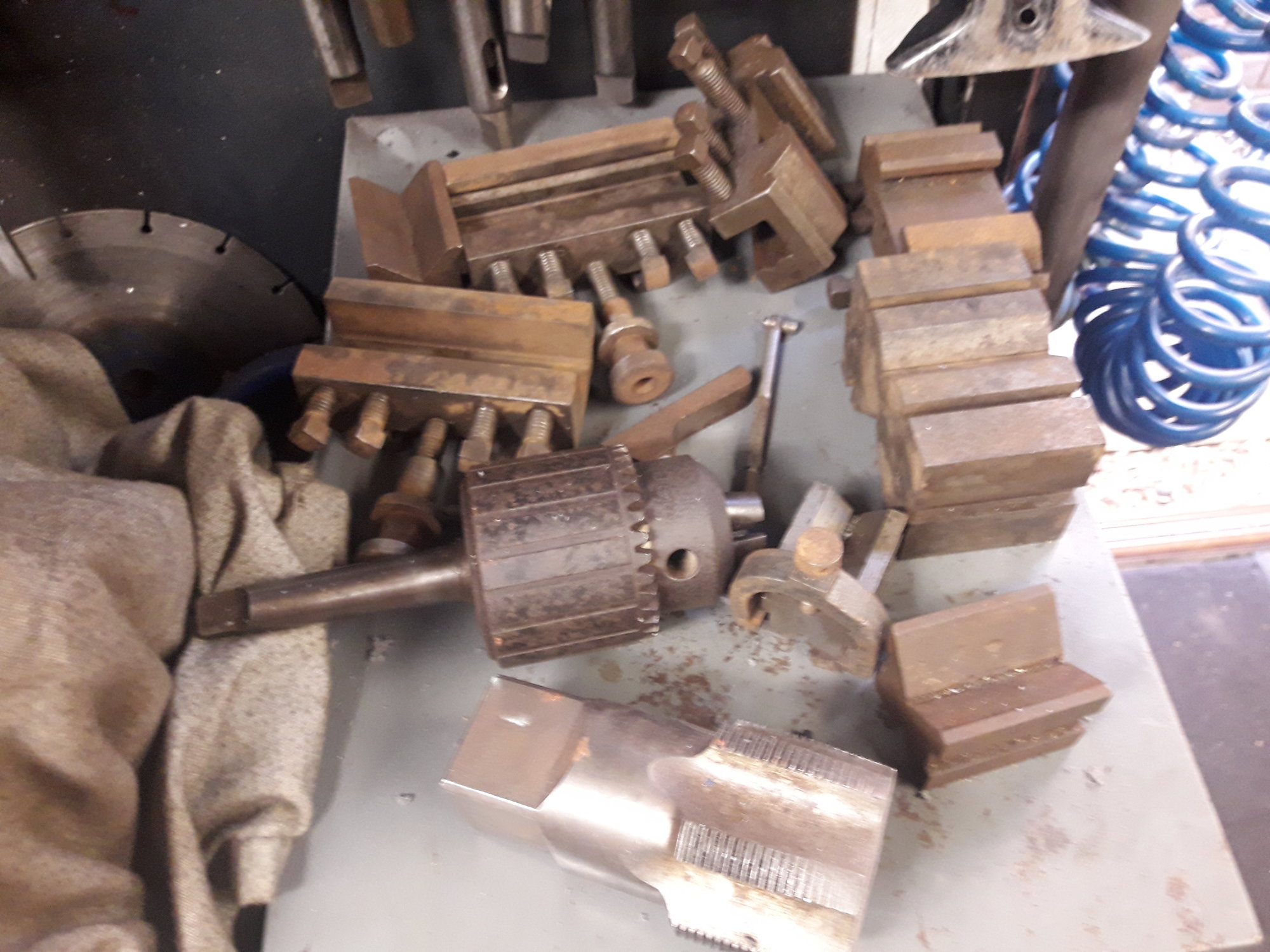

lchris21 Member Messages 2,010 Location South Wales May 28, 2020 #61 ukracer said: What was it like before it went in? Click to expand... ....see post a couple above

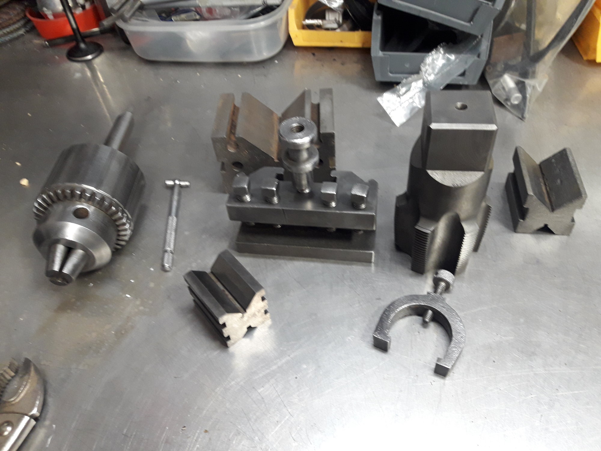

lchris21 Member Messages 2,010 Location South Wales May 29, 2020 #62 All in all not too bad. 48hrs or so in the bath. Quick scrub and wire brush they are sorted.
Screwdriver Member Messages 10,957 May 29, 2020 #64 ukracer said: Can you do collets? Click to expand... Usually the issue would be with removing any coating. Chem black for example will fade with citric but stainless or chrome plate will be fine, it won't touch it so yes, collets should be fine.
