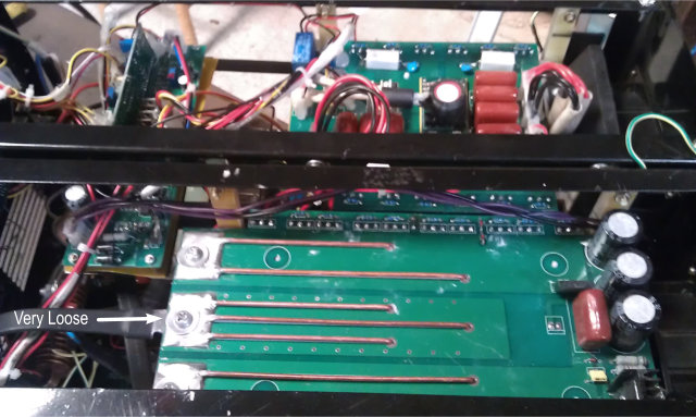

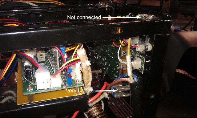

On taking the case off the first thing I noticed that the main earth wire was not connected as the screw fastening it to the chassis had come out, all the other chassis earths were loose in fact almost every nut and bolt in it was loose.
The spade connectors to the main switch were very loose, considering the current going through that switch it’s scary.

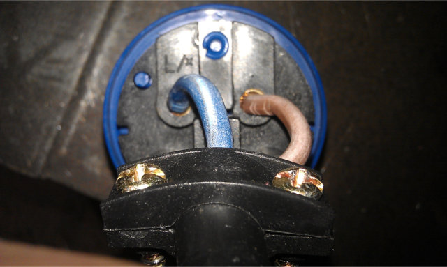

Best of all is that this welder came with a 16amp plug fitted - well I think the photo says it all. Now, I am not sure if these things are polarity specific but why colour code the wires if they are not.
After all this with some trepidation I switched it on, it works - at least on DC tig I will let you know about the other functions when time allows.
For the record I am not an electrical expert but neither am I clueless but to my mind as it was delivered this welder was dangerous.
