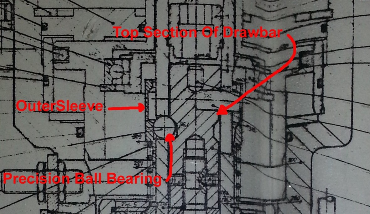

    The Chiron has belleville washers but not that many and I was surprised at the amount. Couldn't work out how it could clamp so well as it did then I got my hands on some drawings and it uses precision ball bearings and a hardened sleeve to lock the drawbar in place. It is very tight tolerances for the adjustment but after 30 years it was still perfect.

    Here is a pic of the drawbar, because of the design it means relatively low pressure air can operate it instead of needing hydraulics.

    What meant was The washers seemed to fail regularly, I was always changing them. All set correctly. Its to long ago to remember if a modified setting was released

    Ah ok, sorry I misunderstood :D
    I was thinking they maybe just used hydraulics to hold clamped.
