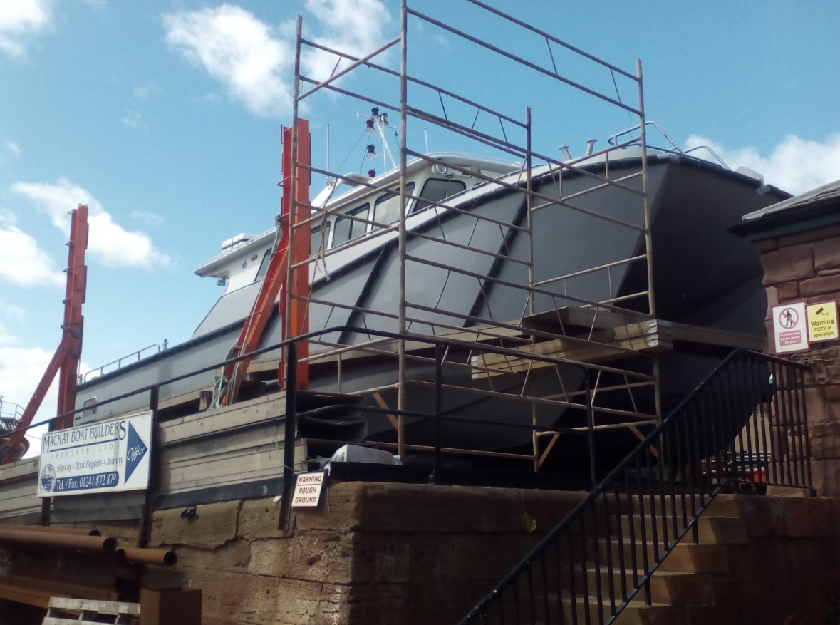

Most of the Cats I fit out/work on are GRP but that one was all Aluminium. I believe it was built in Australia, whether it came over here new or was bought second hand I am not sure. It is used as a survey boat and is owned by Forth Ports.nice cat ... very tough and purposeful looking . I worked off a multicat installing a water turbine at one point and it was just so handy.
