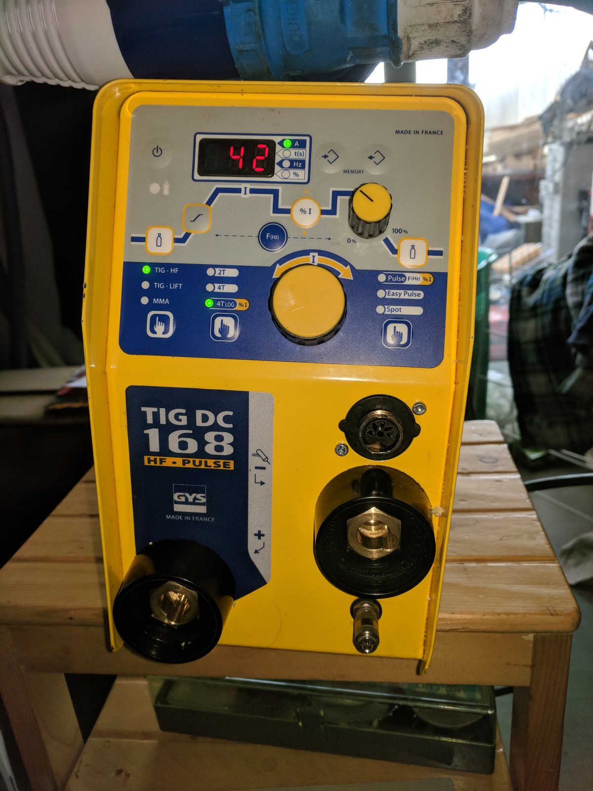

You need a gas cooled tig torch wp17 with dinse to rectus 20ka, A gys plug which tom can sort you out with easy as pie. Should get a torch sorted for that cheap enough.Just (hopefully) picked up a gys168 off the bay.(thanks again for headsup - you know who you are!)
Doesn't appear to be cables with it, but not too much over budget.

Stick it in MMA and Strike up which will tell you the welding side of it’s good.This arrived this morning:
No leads, but it powers on, and the amps adjust. So far, so good.
It's *mint*.It’s very clean

I'm nipping over to a mate of mine.Stick it in MMA and Strike up which will tell you the welding side of it’s good.
Stick it in tig and find out which two pins control the switch. @Tom Orrow L will know.
Short them out and listen for a click and a buz
If it does all that it’s probably fair to say it’s live and kicking.
TIG 168Stick it in MMA and Strike up which will tell you the welding side of it’s good.
