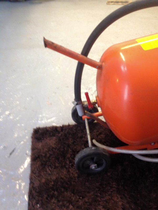

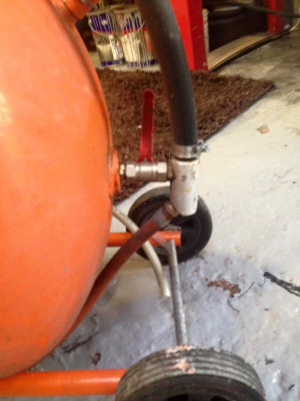

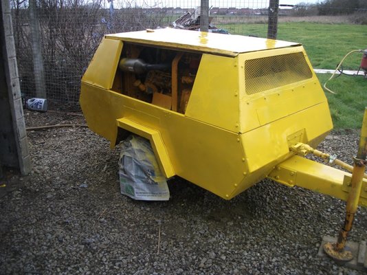

if I was u id just change the blast nozzle on the cheap pot to a carbide one and try it out then if your reasonably happy with it change the metering valve . use -- -one 14cfm comp and if its just to say usable buy another and work your way up -- 2 comps and an uprated - pot wont be more than 400 quid
Already got a 3mm carbide nozzle for it but will probably need to go bigger when I uprate the compressor, I did have a bit of a brain fart today though, would it be possible to drill out the 3MM carbide nozzle to something bigger like a 4mm when the new compressor came?
The pot constantly blocks I can't run it for thirty seconds without it blocking, it drives me utterly bananas sometimes. This is why why spending money on it now to get the back of the problems.

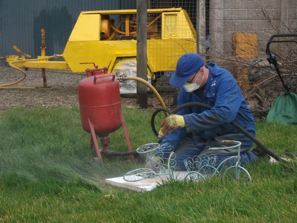

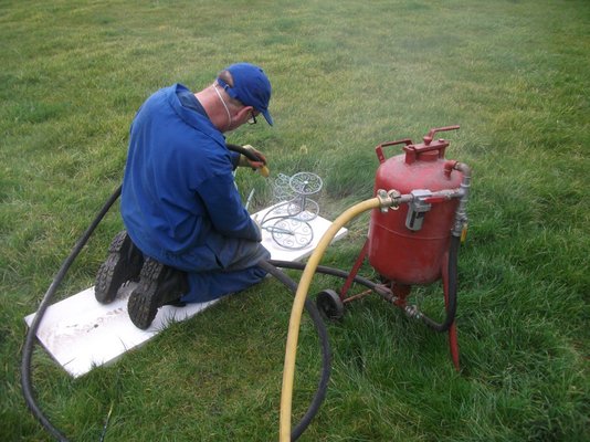

score some points . I haven't used the pot and set up for a few years as Ive been using the smaller one , I forgot how powerfull it was so was only in overalls face mask and an old pair of specs and thin ish gloves . god I got peppered I was using 1.5mm grit , a bit 2 coarse realy . ok for blasting oil rigs
next time I use il wear me air fed blast helmet and gauntlets .
