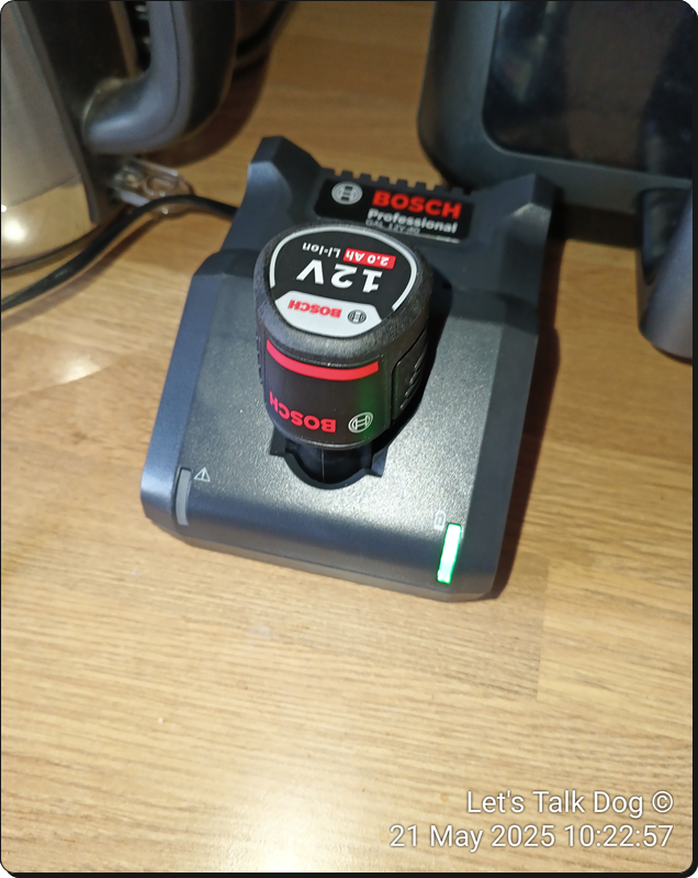

Here are the pieces I used... Bosch 12 volt battery with an appropriate Bosch charger.

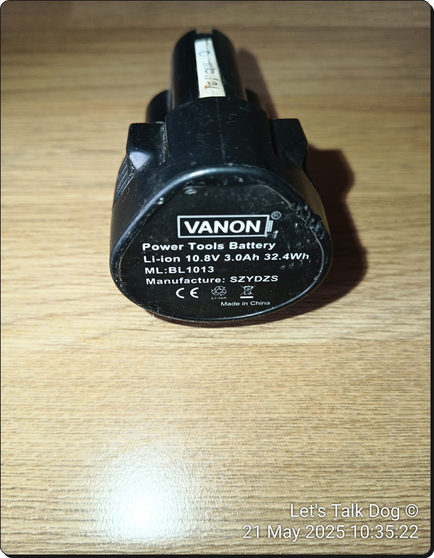

While I was at it, I grabbed a Makita (10.8 volt) battery out of the drill. Not fully charged, been sitting a few months (but not an original Makita battery).

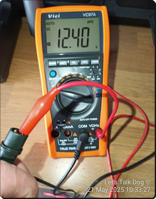

The results ...
Bosch

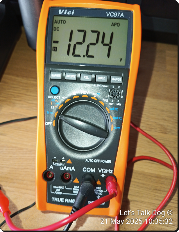

Makita
I'd guess they've got 4.2 volt 18650 cells, allowing for over-charge protection components, reporting 12.4 and an older used 12.24.
