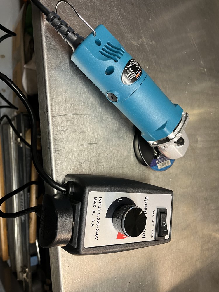

Have the same. Don't use it a lot but it has been handy. Can use it in the engine bay in bits the big grinders can't access. The Katsu one is fairly lightweight which is a bonus but the cord could do to be a bit longer.I have the Katsu version. It has come in very handy a couple of times with restricted access.
Same here, tiny/light thing and although corded it is useful for tight spaces and small stuff.Have the same. Don't use it a lot but it has been handy. Can use it in the engine bay in bits the big grinders can't access. The Katsu one is fairly lightweight which is a bonus but the cord could do to be a bit longer.
Now will have to find best cut off discs for it![]()

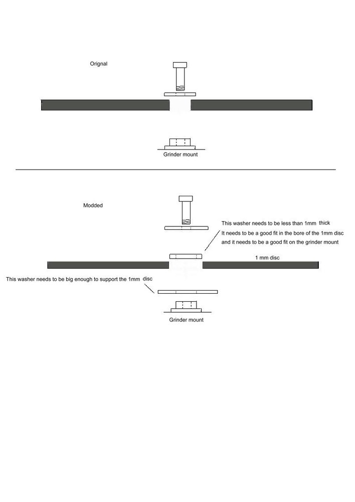

It would be handy if you could fit worn down 4 1/2 inch discs on it.
It's quite easy to do using 3 suitabled sized washers.

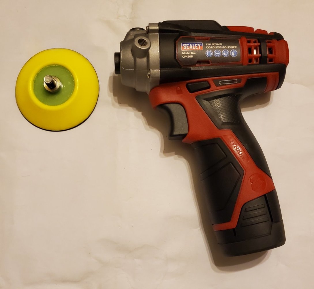

Is that thread M8 ?I bought one of these wee beasties a while ago, I wonder if I can get an adapter for Roloc discs?
I got the same version of that from Milwaukee and had a roloc adapter off ebay ?
