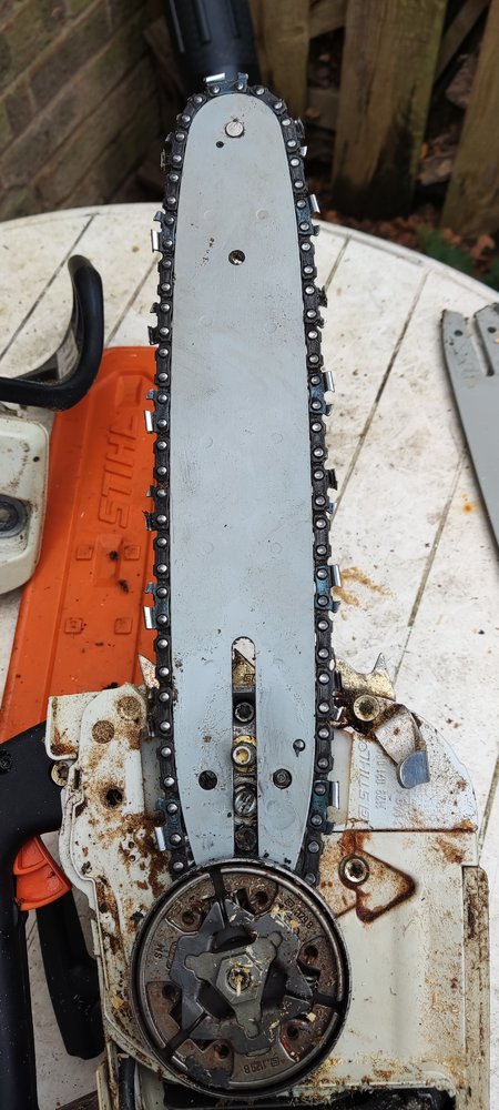

Its worth keeping saws clean. I always take the casings off and blow out all the crap, a lot of overheating issues are down to dust build up in and around the flywheel/barrel/carb. Bars get deburred, cleaned oil ways blown out, chains get inspected when sharpened then dipped in engine oil. Always thought it gives the chain/bar a head start on the lube front while the chain gook wakes up and takes over.
Bob
Nope ... left hand thread iirc ...I suspect its a pain to swap sprocket?
Coil of cord in spark plug hole or an impact driver will shift it
Make sure the piston is up so that the cord doesn't get stuck in the port.
I've made that mistake once ! had to remove the exhaust
550xpFriend tried this on a quad bike engine. It was funMake sure the piston is up so that the cord doesn't get stuck in the port.

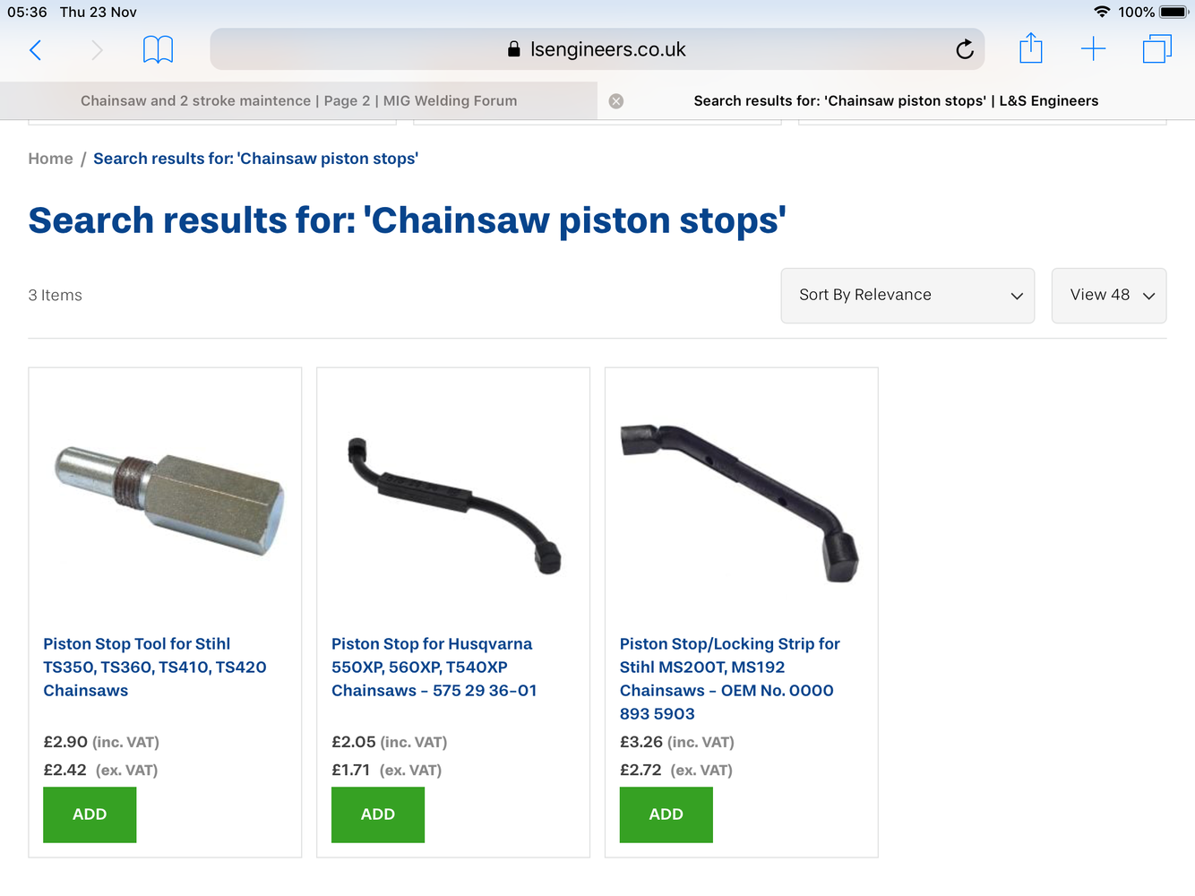

Funnily enough I now have one .I use a proper piston stop, a metal one too. Makes the job easier and I’ve not damaged a piston yet.

I think I will leave sprocket alone for now. Is a piston stop something I can buy from dealer? I do not want to damage it!

Just use a piece of ignition cable, as stopper.
Proper tool is only a few pounds, we all like to have toolsJust use a piece of ignition cable, as stopper.![]()
