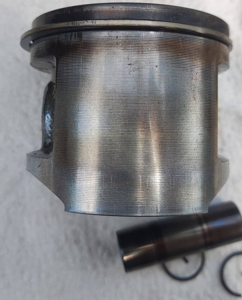

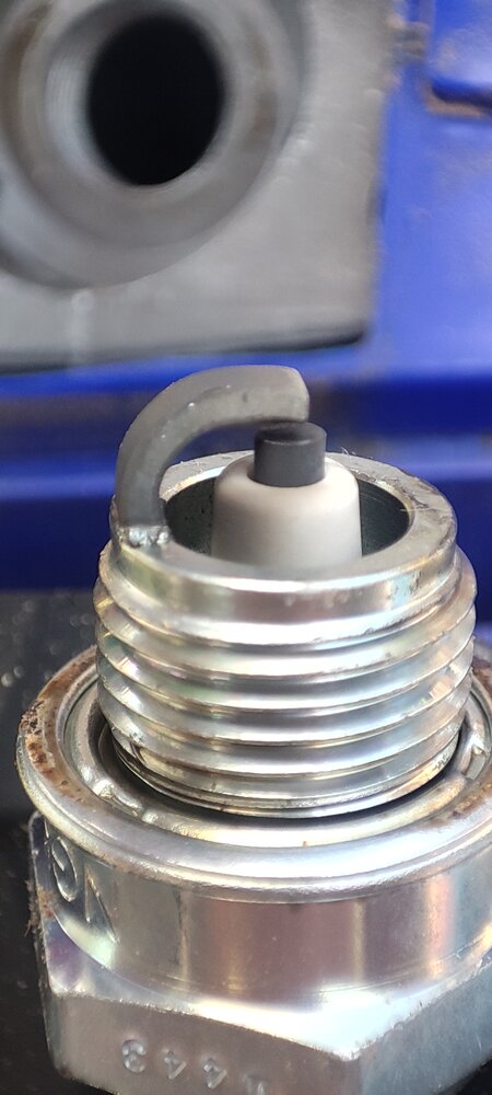

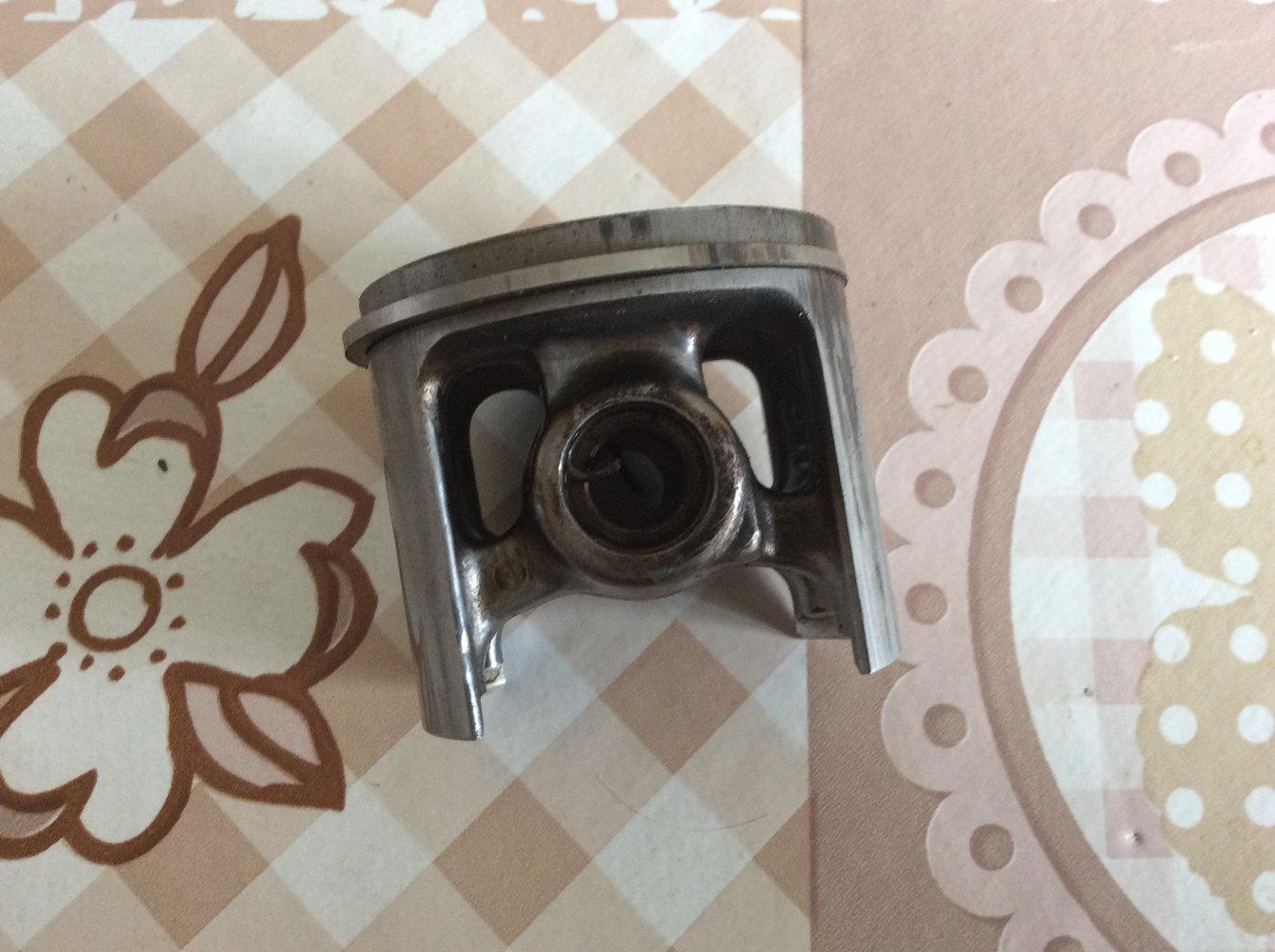

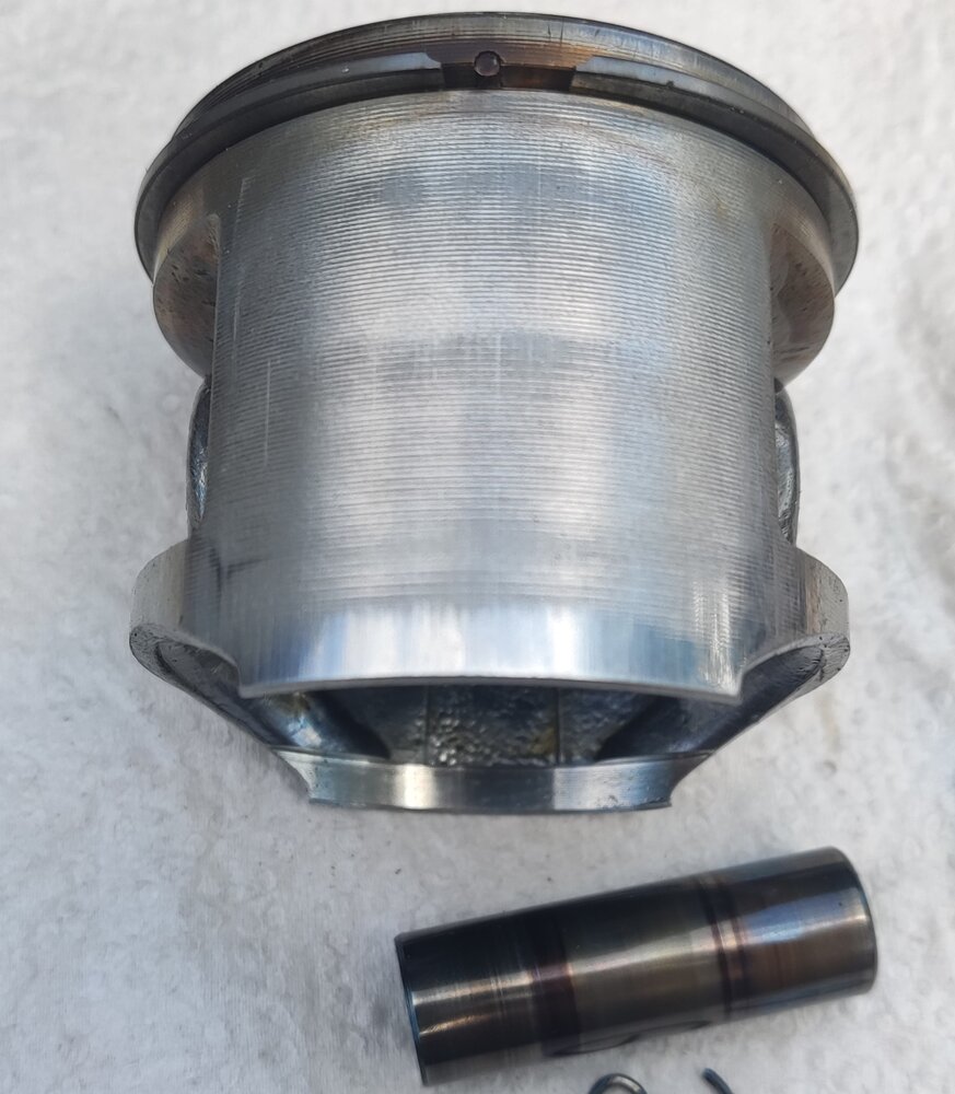

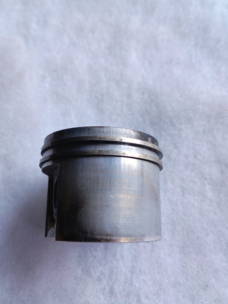

Likely due to short runs, I imagine it would have cleaned and burnt off a lot of it with a bit of use. Perhaps my mix was a bit rich on oil.
I refused to buy ultra as they do t have any closeup pics of the bottle and appear to have a spec misprint on all the sites selling it as Jaso-FB in which case its poo!
My oil is all Jaso-FD which is highest standard and should be way more than adequate.

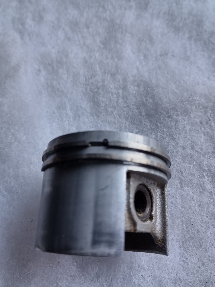

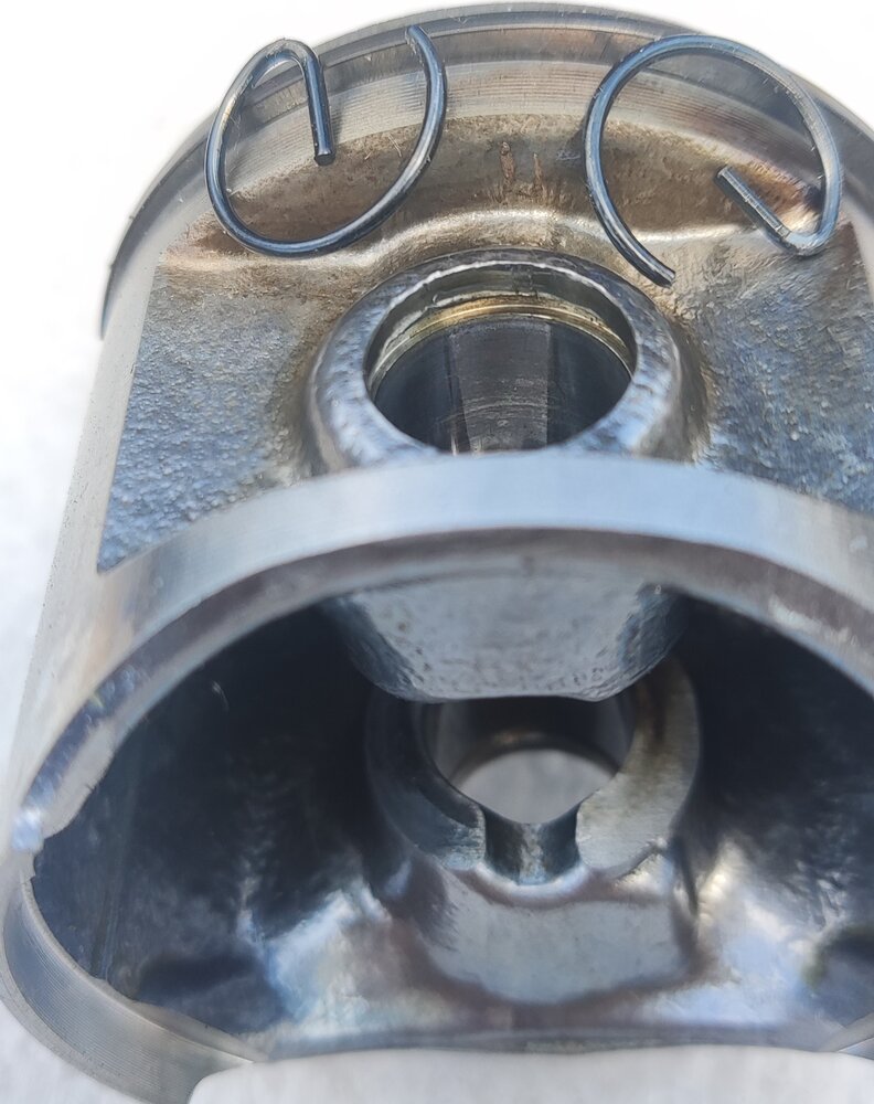

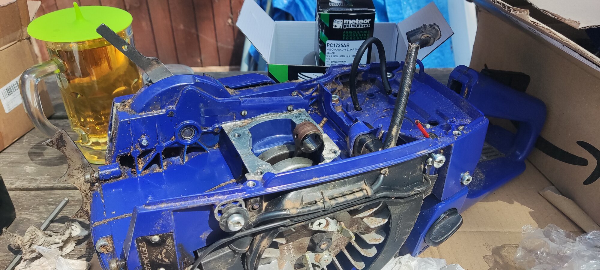

Appears I should check the squish on the original and the new one. It appears 20 thou/0.5mm is the ideal amount of squish?The pock mark's in the cylinder head look like pre ignition OR very poor casting, looks worse in the squish band.
Did it have a base gasket and is the ignition adjustable?

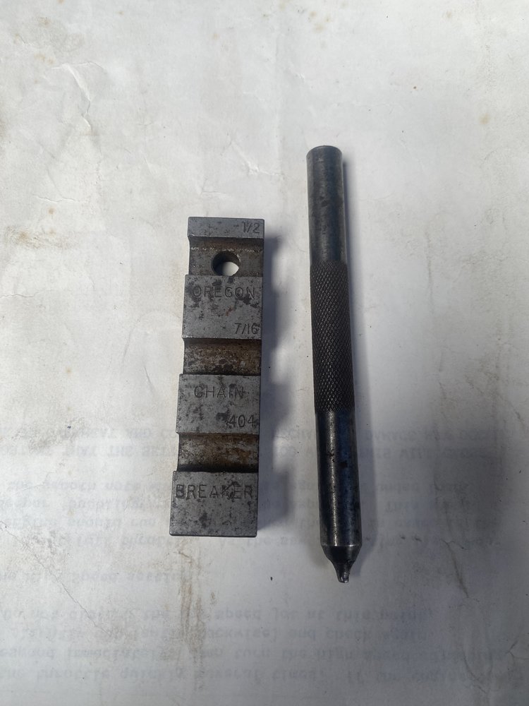

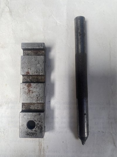

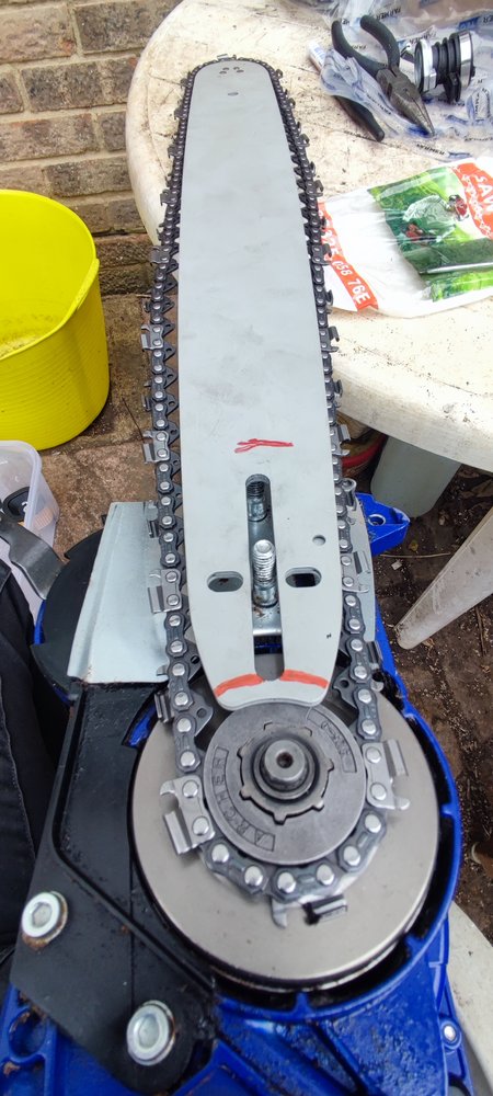

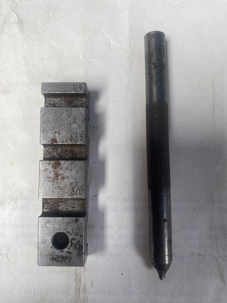

Have a photo? Is it same sort as a motorcycle chain braker? I have a DID style one.I use a basic chain breaker, the punch that comes with it and a hammer. Been doing chains this way for over 40 years, a spinner makes a tidier job though.
