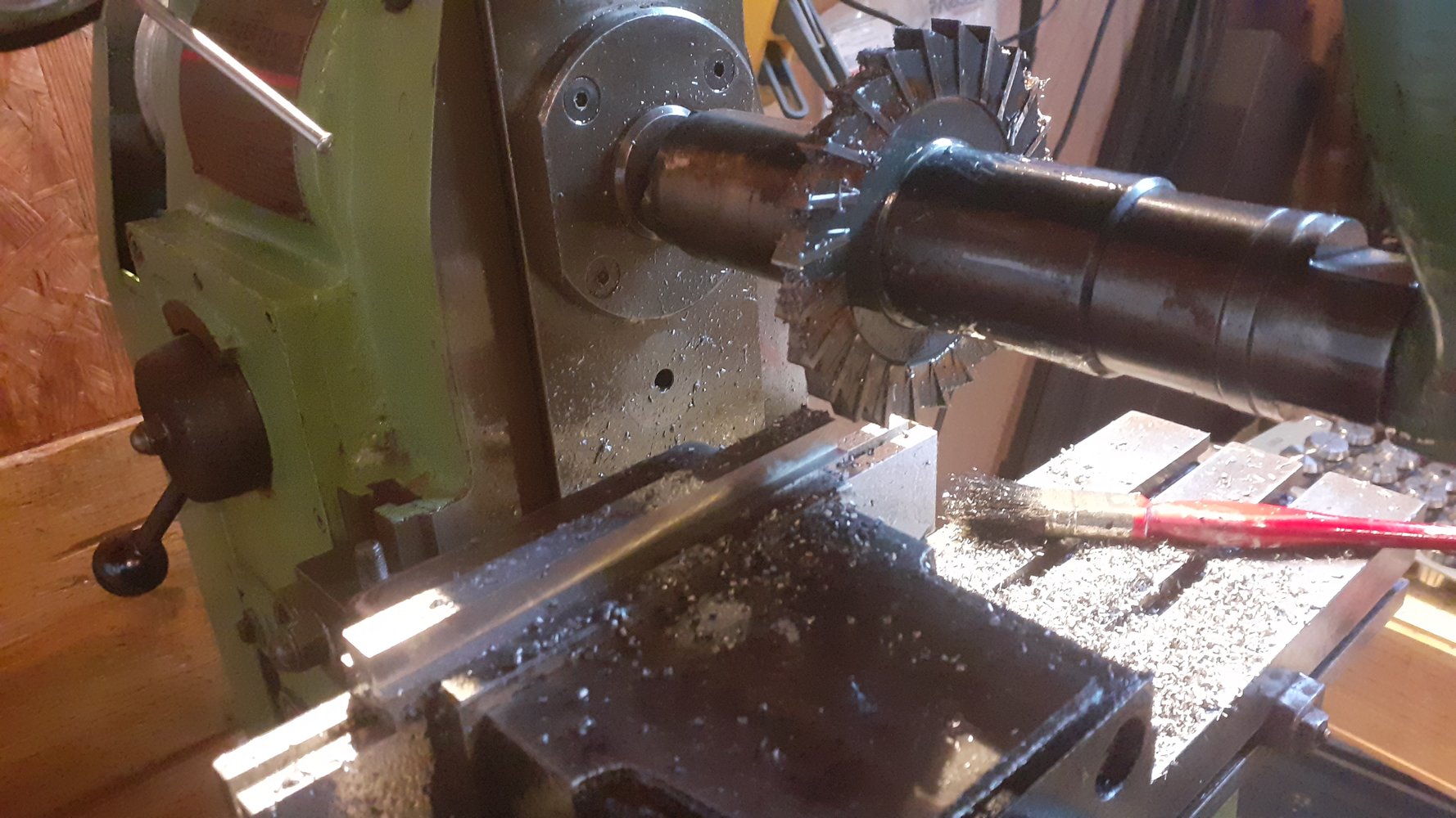

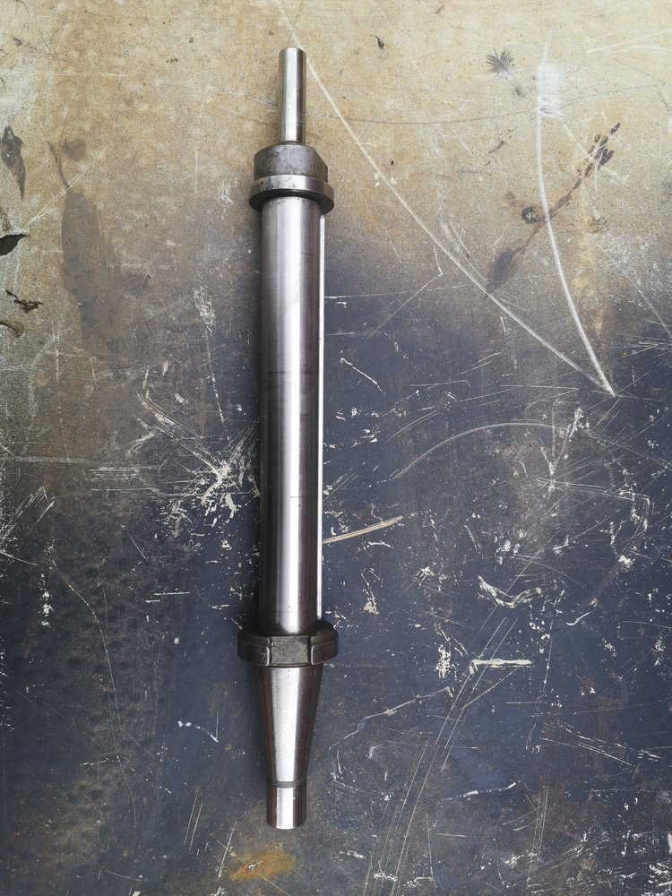

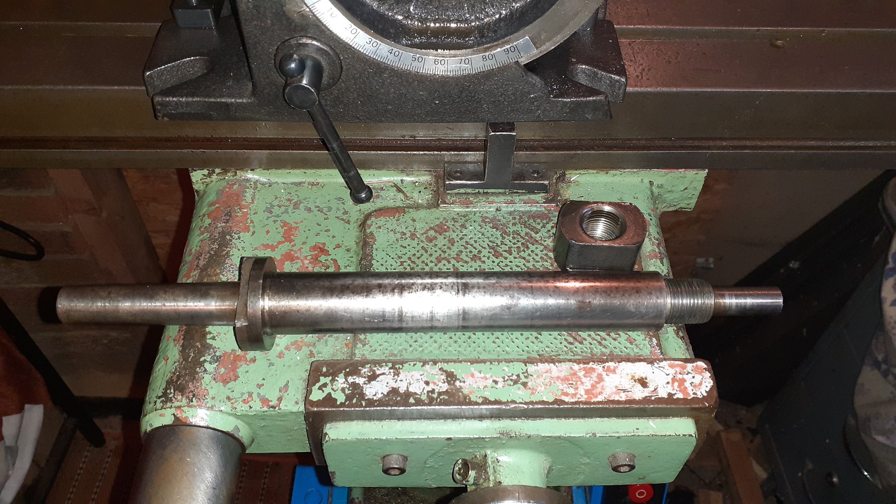

I am being a little to gentle with the nut then? It is a left handed nut so should tighten as run in a conventional rotation.I don't think that it's uncommon not to have a keyway. Big industrial machines probably do, though.
Here is mine:i may have a spare arbor thats keyed ...can you photograph yours

The arbor on mine isn’t keyed and I’ve never seen any cutters of 1” bore without a key way. Although I really don't know much.
I’ve tried finding small diameter cutters (less than 2 1/2“) but they all seem to be radius ones.

Thanks for looking anyway I will make one with a keyway and then if I find doing up the nut tight enough I can switch to the keyed one.Sorry for the delay, my memory was playing tricks. 30int isn't going to fit 2MT
It doesn't fit my omnimill as it is Type A and the Elliott uses Type B

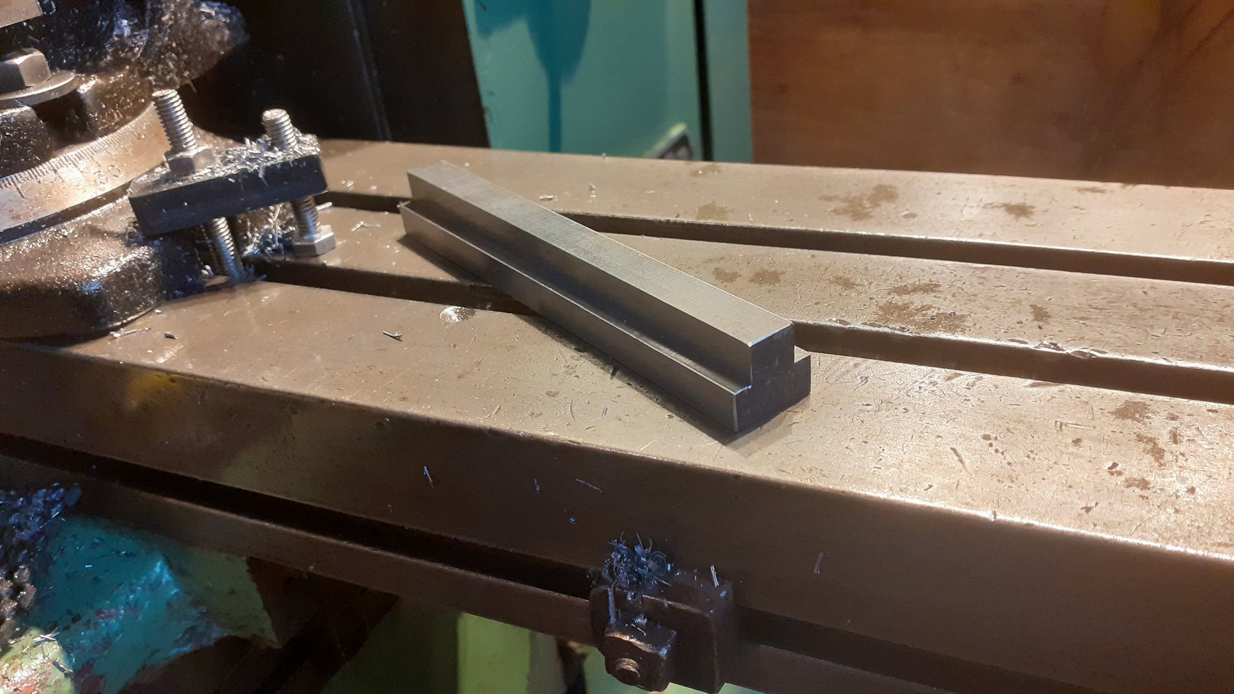

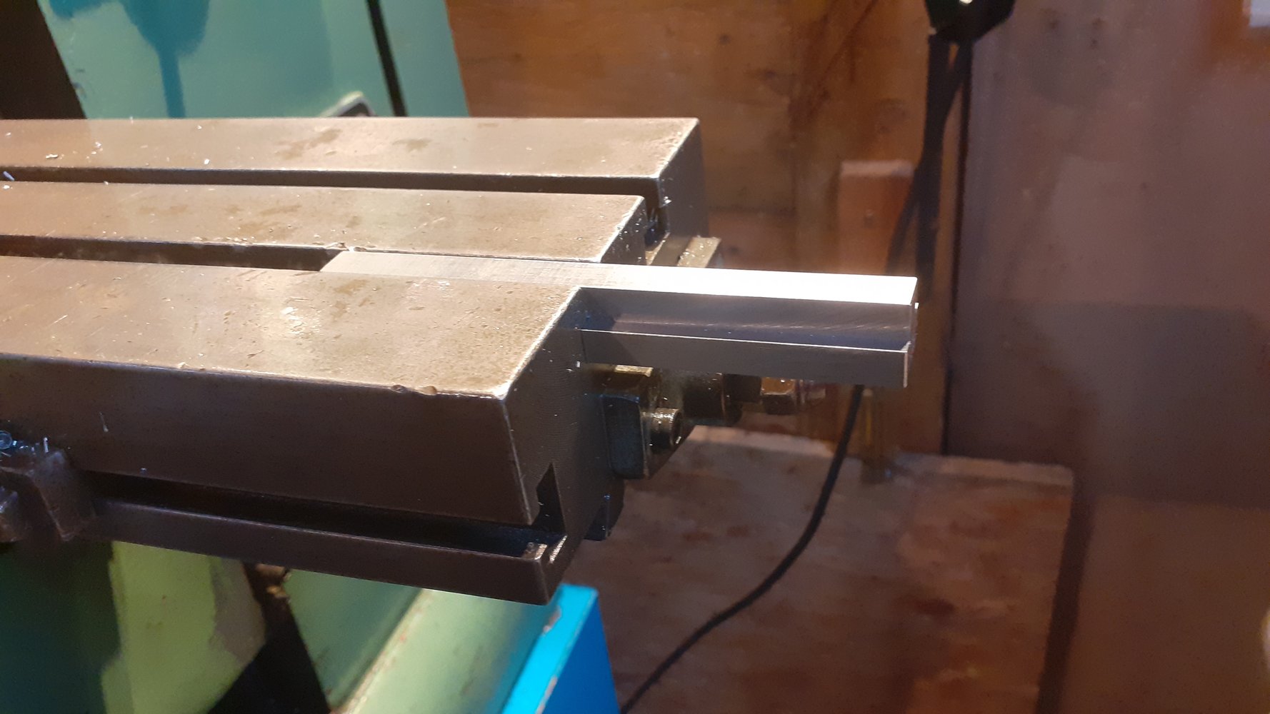

Good call on the reducing the thickness, I will do that before drilling and tapping. The 31" was the measurement the previous owner told me as I was concerned about getting it into the workshop. I measured the actual size and that is the 29".Hi,

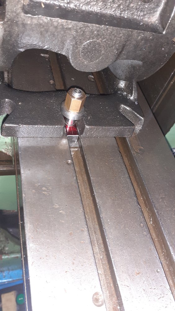

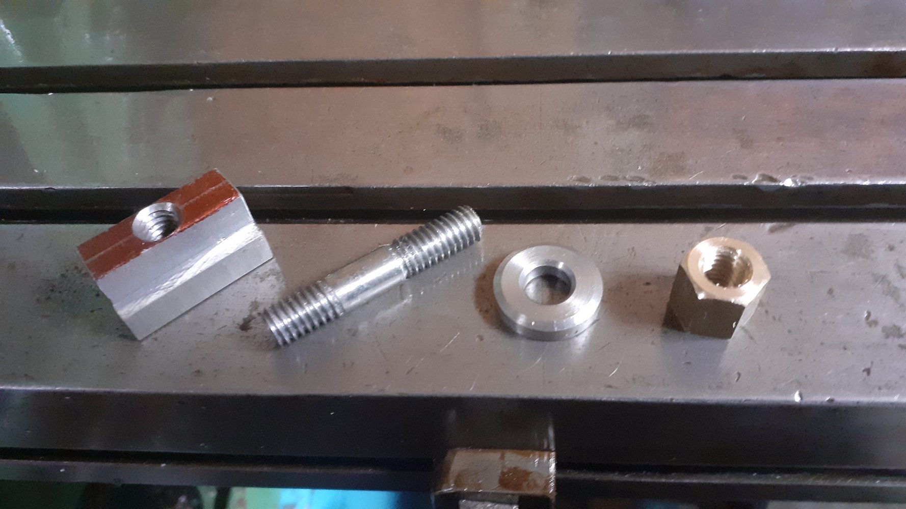

I suggest you thin the bottom of your T-nuts. They need good clearance to avoid jamming with swarf.
Stake, or peen over, the threads at the bottom so that studs cannot pass through - or that is one easy way to break out the T-slots.
Are you saying the table handle is only 2”? My table is the standard 25”, 31” including the handle and 38” including both handle and power feed.
