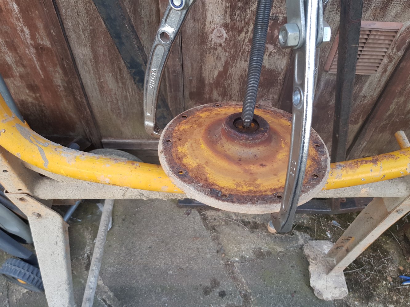

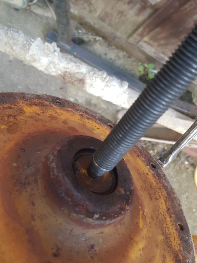

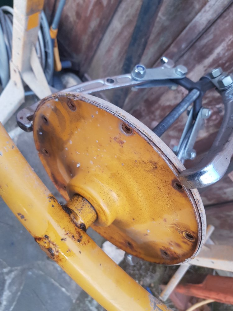

Same mixer as mine. Mastermix, made in Poland. The plate holding the bearing is welded on to the drum. Think if I had this prob with mine I would turn a brass bush and press it in a piece of tube and weld it on where I cut the old piece including the worn bearing off and fit a grease nipple, prob would be getting it central but time and perseverance?
