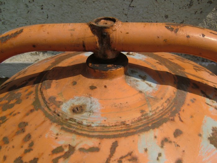

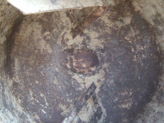

Getting a new bearing will not be a problem but its getting the old one out that looks the messing about part as I think it will be a case of a cut and shut job on the drum.

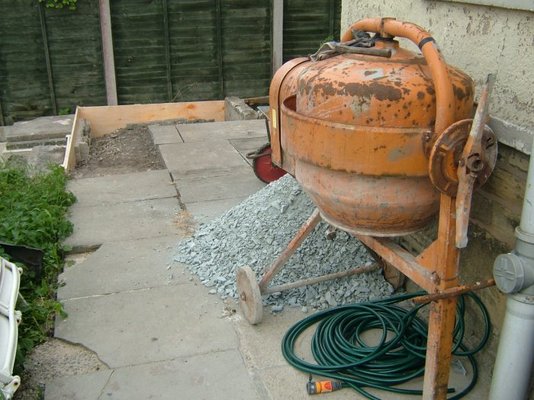

Is your mixer like the one above or the one below ???

I just bought an old mixer it looks the exact same as yours but what I dont know is it a cheap Clarke mixer or is it made by Belle ? The motor is 370 watts and is an old style induction motor with ' made in Poland ' on the lable and I cant see Belle using such a low rated motor but its obviously adequate for the job ? On the outside there is a lable saying 'start your Master Mix before filling ' and I thought Master Mix was a Belle trademark ? The bearing in the centre looks to me like its been placed in position in the drum base and then the backing plate welded on to the drum ( thats with the benefit of being able to view mine closely ) so it may not be possible to replace the drum bearing and is it even a ball or roller bearing , looks to me like it may just be a large plain bearing ? The mixer shown on the Machine mart website listed as a Clarke looks identical to these .
