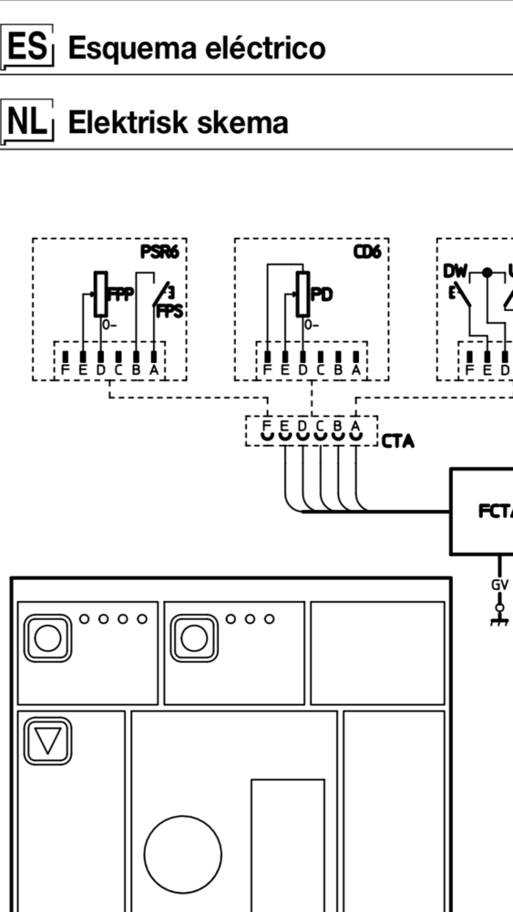

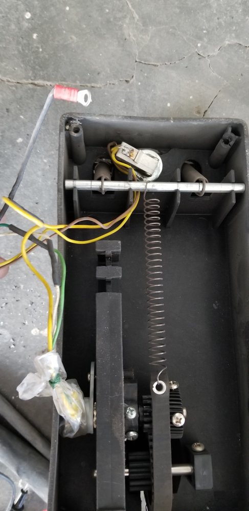

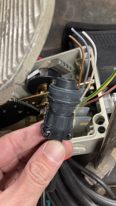

Here are some pictures. Cable was extended so whatever I said yesterday about wire colors was not trueThis is a Weco Diagramm. Any pictures available?

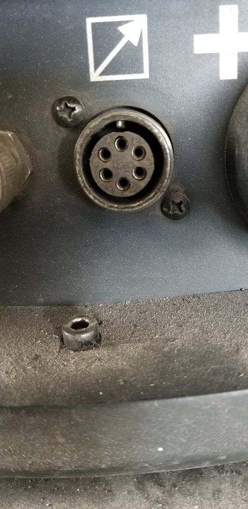

You wrote that the pedal got female con? That’s very uncommon.
Thank you a lot for this. I guess I'll try to find some to translate me this as I don't know what I'm looking atThat’s what I found about this pedal. Pot is wired as adjustable resistor not as voltage divider.

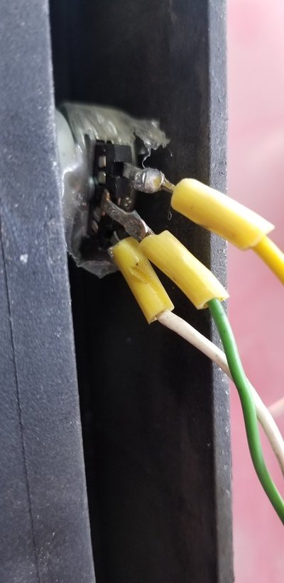

Thank you once again. Huge thank you! Tomorrow I'll do that.You need to cut of these “conformal coating bag” and try to figure out where the wires are terminated. Not that big deal. Then measure in home position from centertap to outer taps. The measures with low resistance is your point to go. Don’t matter what color it is. Bare rheostat.
I hope I will. Nobody got me as close to solution as you did. It gets hard to source that conection here in Serbia but I'm sure I just need to contact right stores for that.You’re welcome. Hopefully you can sorted these issue. Already ordered these Amphenol connector?

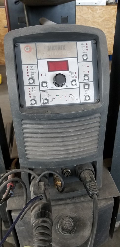

This is my latest pedal for Weco. Did it last week. Gessmann P7 is absolute bulletproof.
Hi Jan,You need to cut of these “conformal coating bag” and try to figure out where the wires are terminated. Not that big deal. Then measure in home position from centertap to outer taps. The measures with low resistance is your point to go. Don’t matter what color it is. Bare rheostat.
