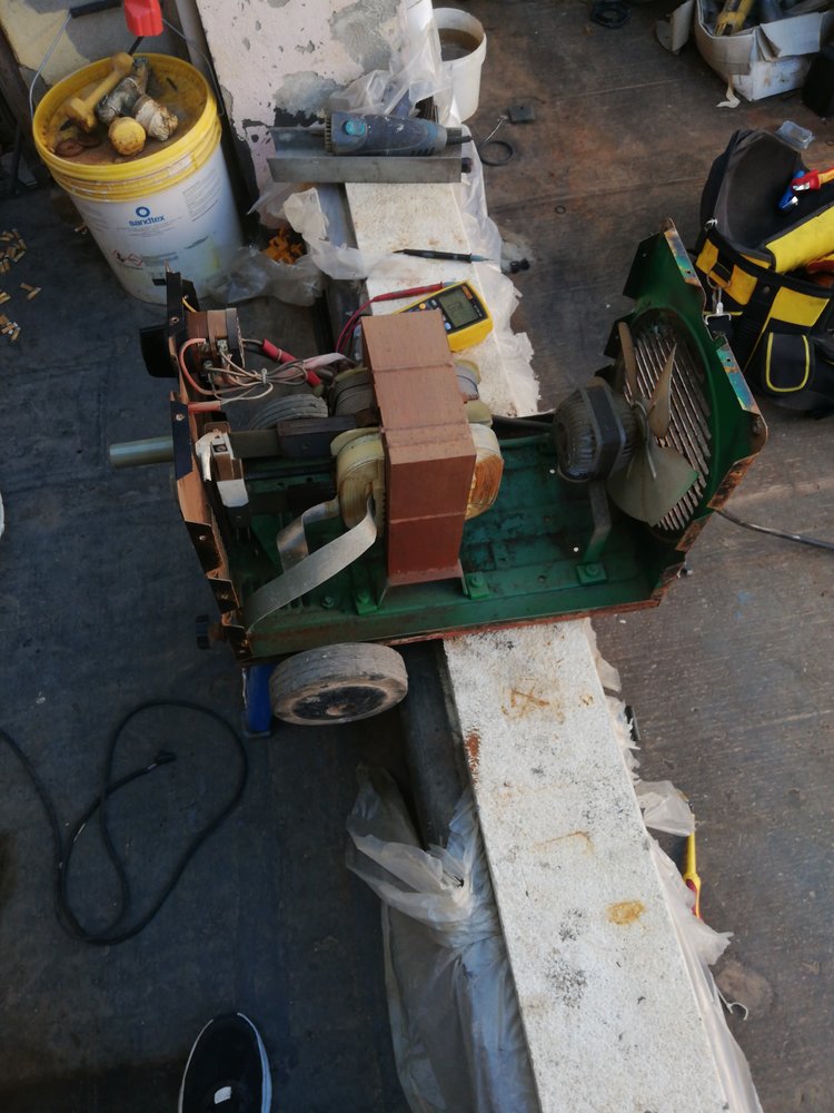

So this thread is a sort diary and discussion where to find solutions and share with you the progresses of my new to me CEA stick welder restomod .
That's how it looks inside
I was expecting more from the transformer TBBH
Anyway it has lots (not so much but surely more than others ) space for upgrades inside.
It has a bulky 250mm cooling fan which will stay there , nothing wrong with it.
But I'd add a conveyor shroud around to increase its sucking capacity (it blows inside out)

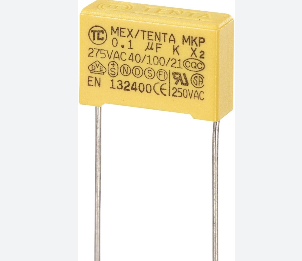

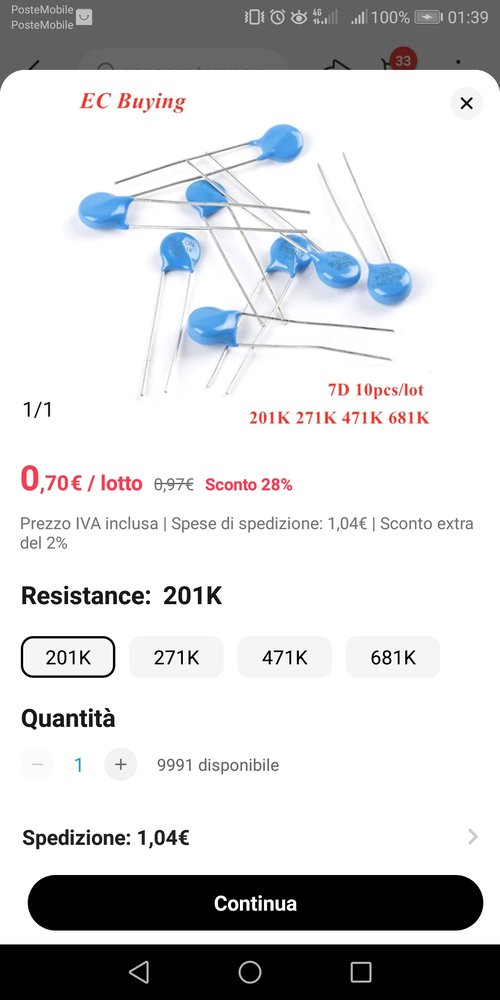

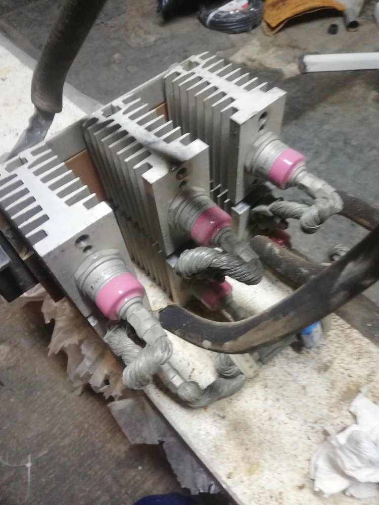

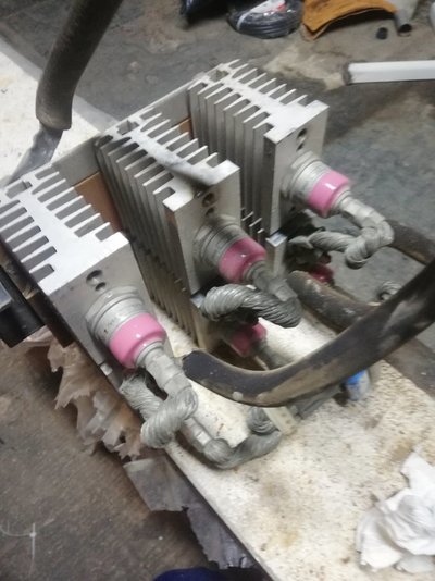

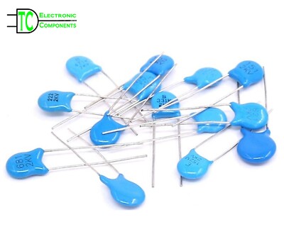

I'd like to rectify the output there's a lot of space for a rectifier and an heat sink maybe at the bottom .
My concerns are about where and if too put an inductor with two parallel capacitors to protect the rectifier from the inductor voltage spikes .
But that's relatively the easiest part .

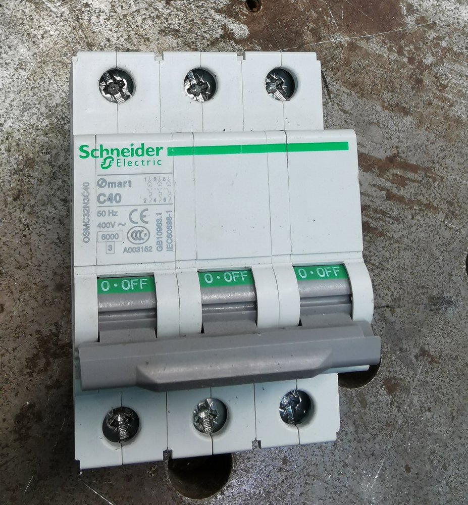

I can't find a switch big enough and I don't know what temperature is better .
I get rid of my other buzz boxes many moons ago so no way I can use their switches.
I also have intension to connect the switch a way I can rather use it with 415V or 230V without the need to open and change connection.
Or with the problem of switch it on 230V while connected to 415V .
Because how it comes from the factory it will easily blow up if the locking screw is missing as in my case
Just removed a copper connection link on the switch and now there's no risks at all
Any advice is well accepted remember that I need a transformer based welder to do things I can't with an inverter

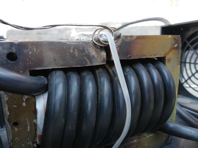

Doesn't have and I believe it never had too a thermal protection on the windings or wherever else.
