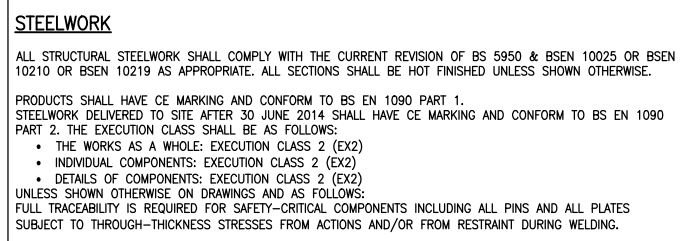

Matt, after having a look into things, albeit fairly briefly, it is ending up a right can of worms, here is my take on things
In the majority of cases an approved weld procedure will need to be in place and as such attention will be made to shielding gas selection

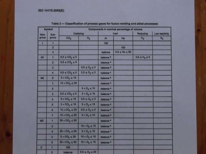

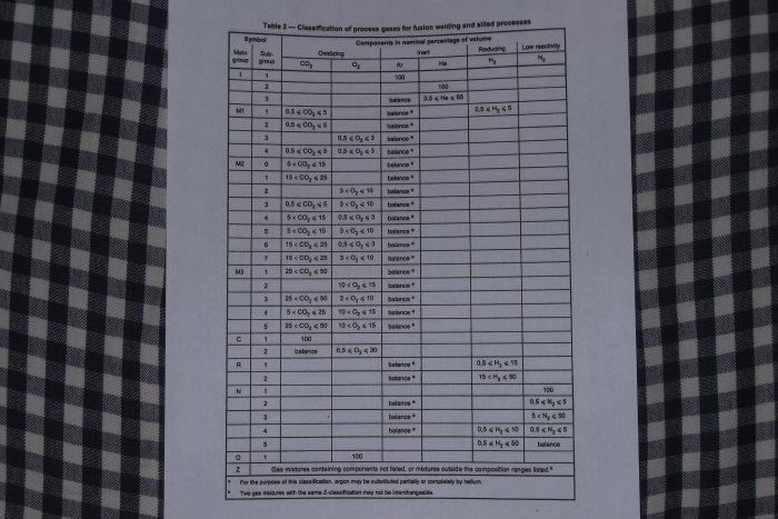

Shielding gases have to comply with EN 14175 which place quite tight tolerances on the accuracy of mix, nominal concentrations of above 5% are allowed +/- 10% of the nominal, nominal concentrations of 1 to 5% are allowed +/- 0.5% of the absolute and compenents below 1% are not covered by EN 14175.
To try and explain in laymans terms, a 20% CO2 in Ar mix can have a varying CO2 content between 18% and 22% whereas a 2% CO2 in Ar mix can vary between 1.5% and 2.5% CO2 content, so as you see there are quite tight limits on shielding gas production.
When you look at shielding gases with relation to weld procedure development, if a procedure has been developed using a 20%CO2 in Ar mix just because this is a M21 mix doesn't mean you can use any M21 mix (15 to 25% CO2) on production welds, the standard states you have to use the same nominal mix ie 18 to 22% CO2 content
So if someone is using pre qualified procedures that have been qualified using a 20% CO2 in Ar mix, they have to stick with that gas mix and cannot change to "Argoshield" mixtures without having to re qualify their weld procedures as they are totally different gases regardless of the fact the change in gas mix will actually have little effect on welding parameters
I would like to say something about WPS and gas consumption .
if on your wps is writing that you should welding, with M21 , this also means that with any type of gas that falls in M21 you can weld.
