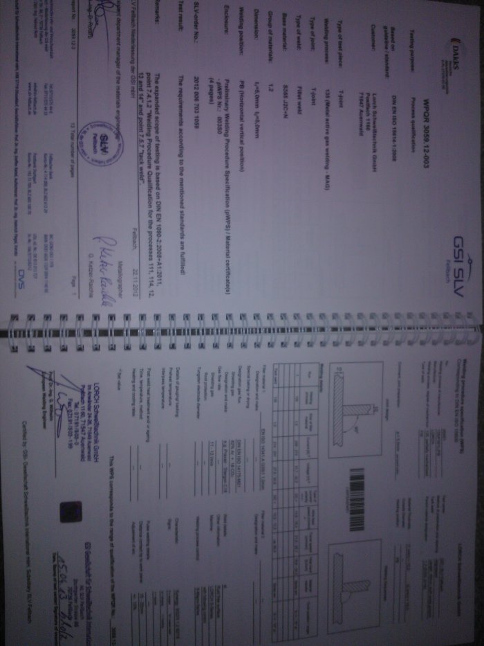

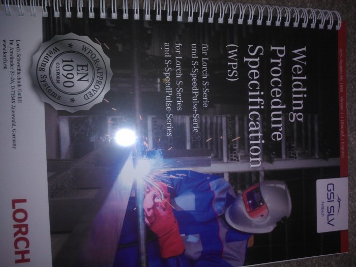

I attended a EN 1090 information event today hosted/run by the TWI.
From my point a view it was very worthwhile, "busted" a lot of myths that are plaguing the industry and even corrected some misconceptions that I had.
The whole issue of RWC's isn't a scary as first thought, and its possible to have more than one (eg, an in house one for the day to day general stuff and a outside consultant for when a IWE is more suited)
Basically it's mostly just creating traceability and have a welding quality system in place so that you comply to EN 3834. Once I have had chance to digest the many presentations that were given I'll do a more in depth post
