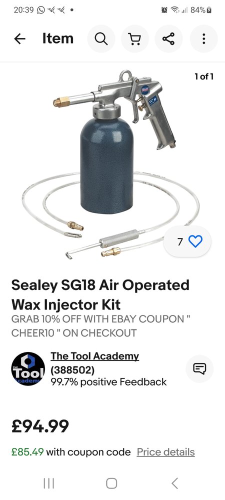

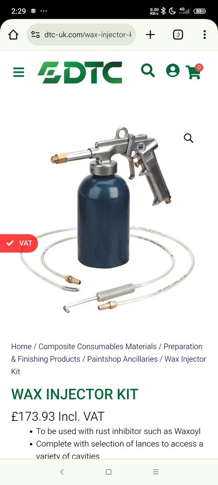

The long thin lance with the pressurised guns allows you to shove it up a hole in the end of a chassis leg, sill, door/screen pillar, internals of boot lids, bonnets, hatches etc right to the other end, pull the trigger and pull it back at a nice constant speed.
A quick test beforehand in an old 2 litre bottle will show the coverage and a suitable speed.
The little metal lance thingie allows underbody wax to be easily applied. Found mine very useful over the years.
