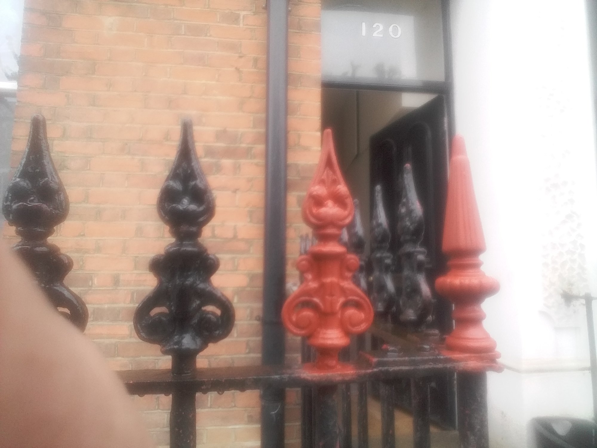

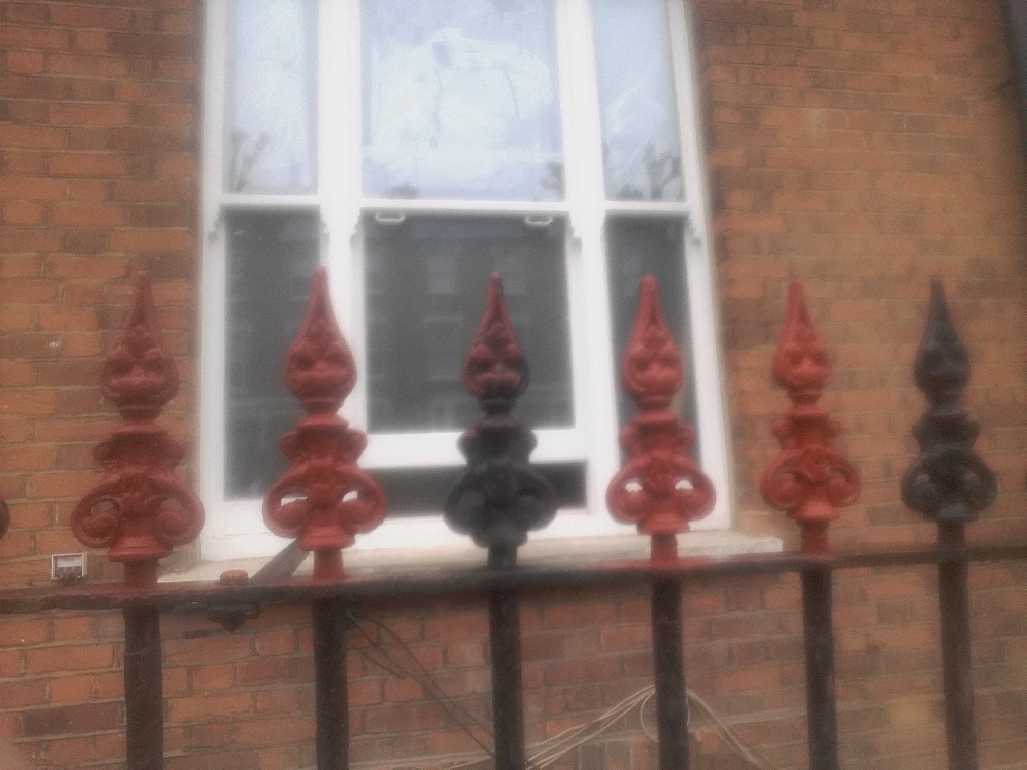

Tigman Forum Supporter Messages 3,902 Location Watford UK Mar 12, 2018 #25 All sorted drilled tapped and oxy/ acetylene brased on Very pleased with the final job !
Seadog Save the planet. It's the only one with rum! Messages 13,130 Location NE London - UK Mar 12, 2018 #27 But they're all smiling...
gordon stephenson Member Messages 7,430 Location Skelton in Cleveland U.K. Mar 12, 2018 #28 Good job, The originals look strange to me with the railhead flange standing above the top rail.
Tigman Forum Supporter Messages 3,902 Location Watford UK Mar 12, 2018 #29 gordon stephenson said: Good job, The originals look strange to me with the railhead flange standing above the top rail. Click to expand... I thought that as well , they would look much better if they sat on the flat bar like the one on the end
Tigman Forum Supporter Messages 3,902 Location Watford UK Mar 12, 2018 #30 Richard. said: Wow they’ve rusted quickly Click to expand... That was a lovely red zinc phosphate , does look like rust though !
wyn Member Messages 3,772 Location Cardiff Mar 12, 2018 #31 I think the rail head should always be above the top flat bar. The bar is just there to keep the vertical rails spaced apart. When they sit on the flat bar it always looks to me like the job hasn't quite been done right.
