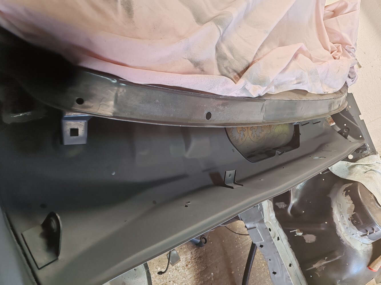

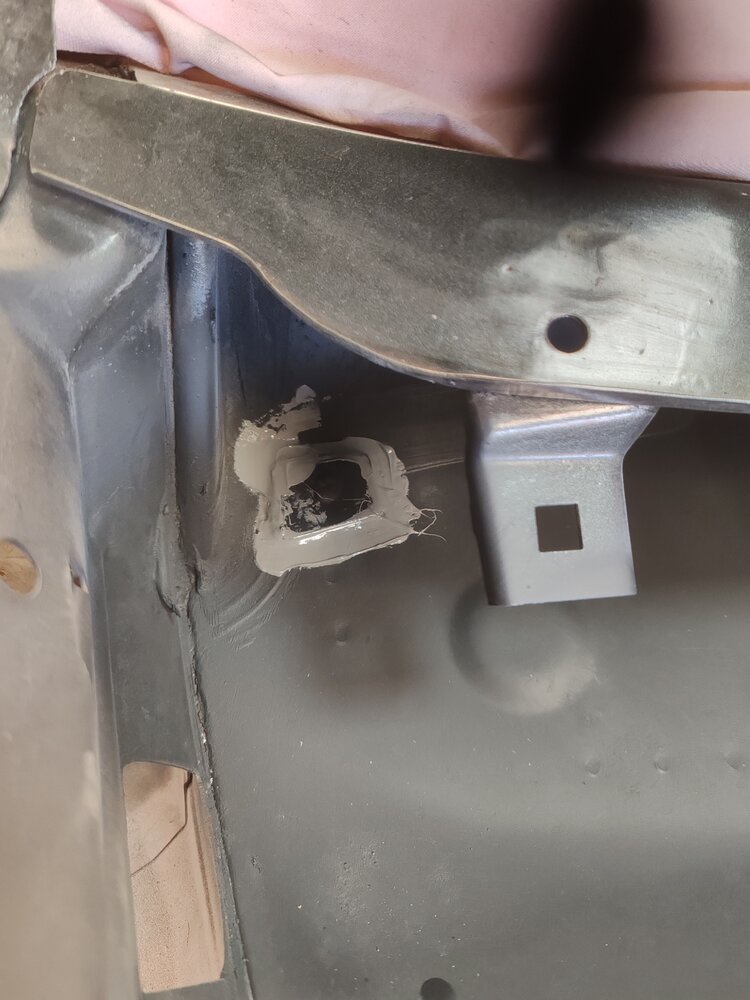

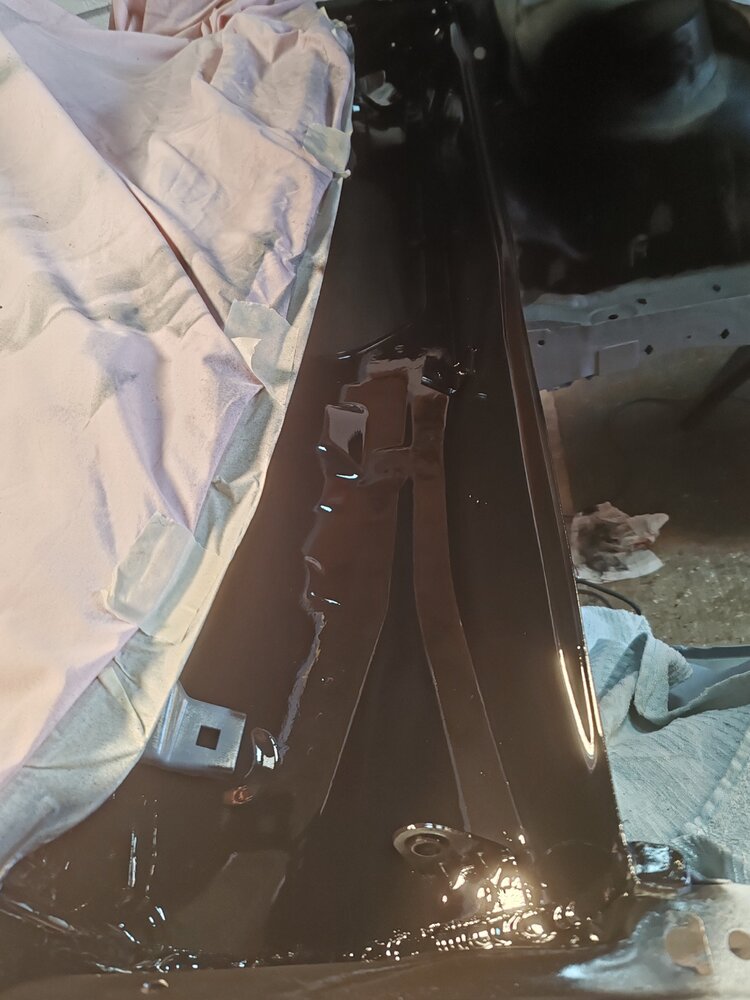

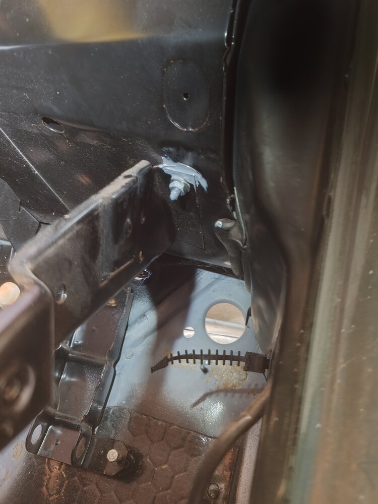

A bit of etch squirted on and it looks loads better, even the pitted areas dont look too bad so with some coats of other stuff it should be fine, the monkey is off my back
Did cheat a bit in the corner where it had gone through, access is minimal and I didnt really want to start burning off all the good seam sealer so it got a little 2mm plate with a welded stud, a good blob of PU underneath and bolted up, it bolts to the dashboard support bracket inside
