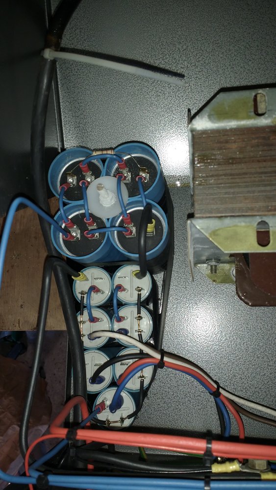

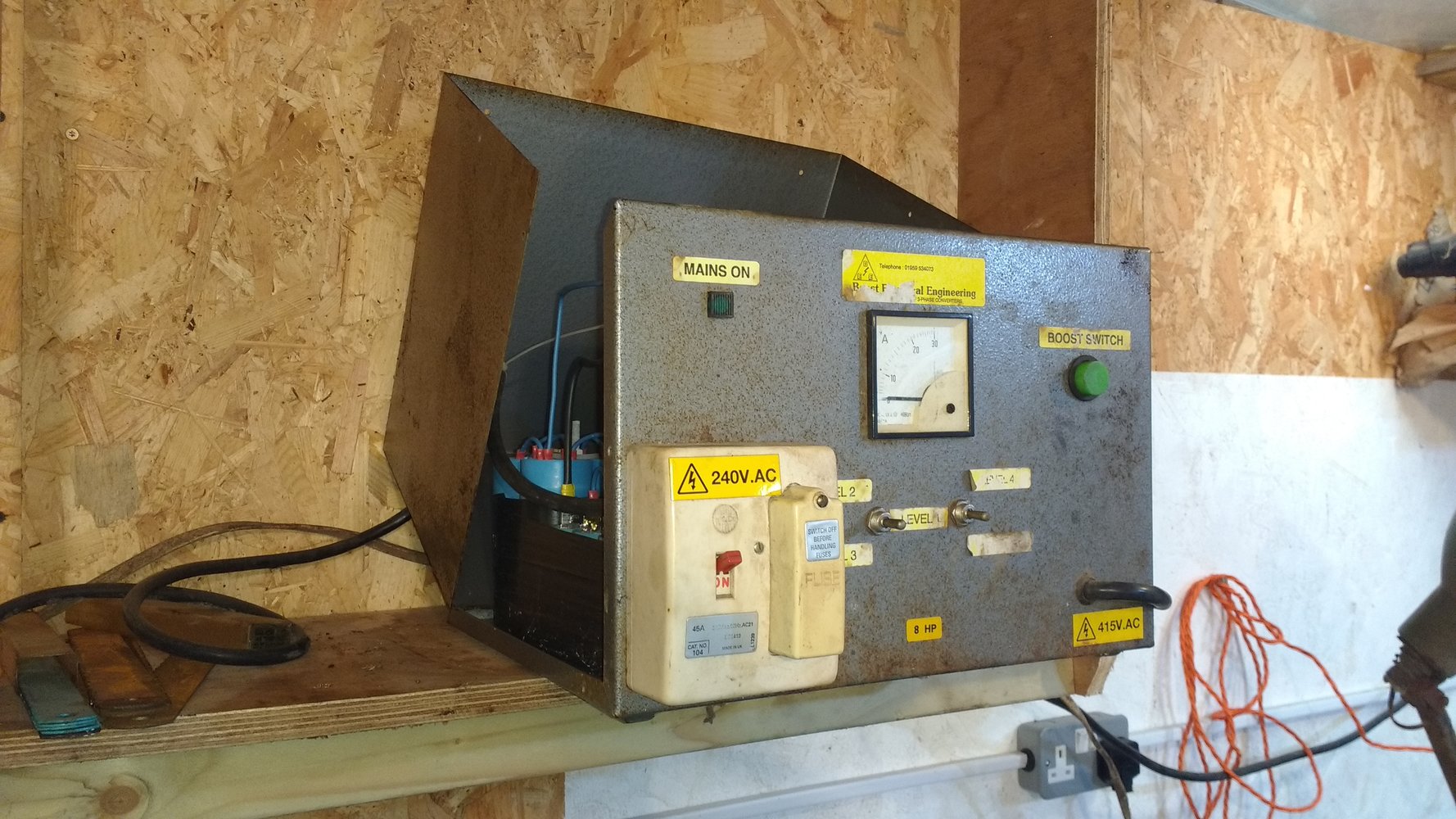

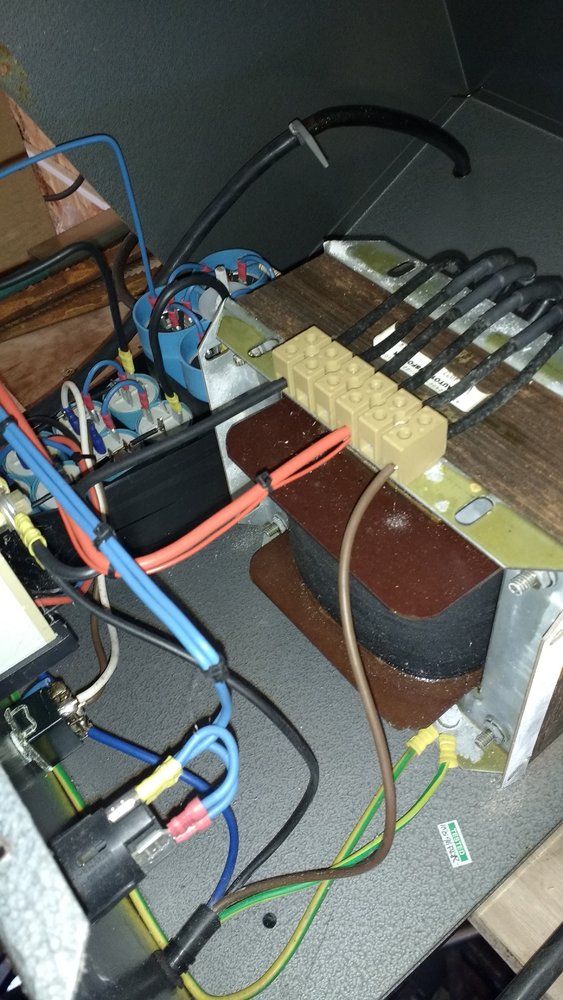

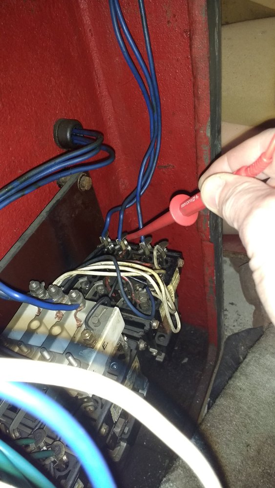

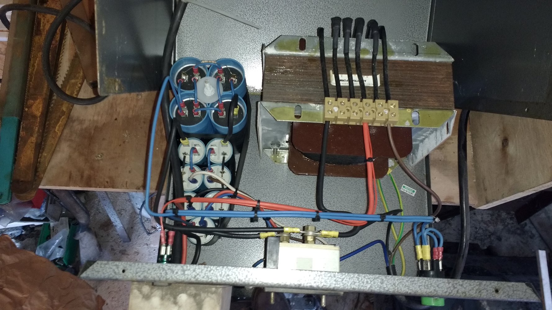

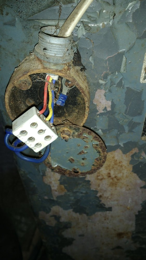

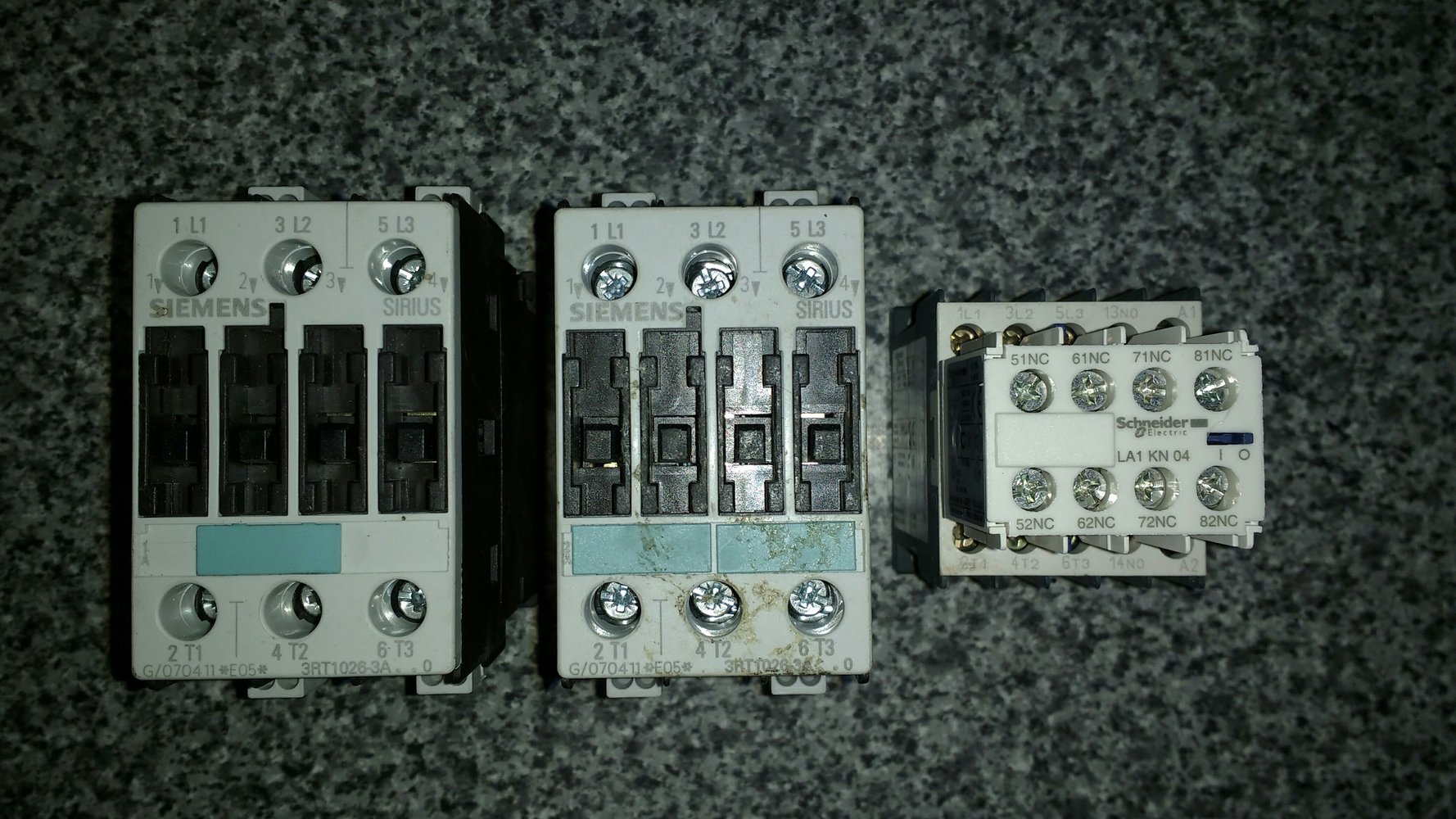

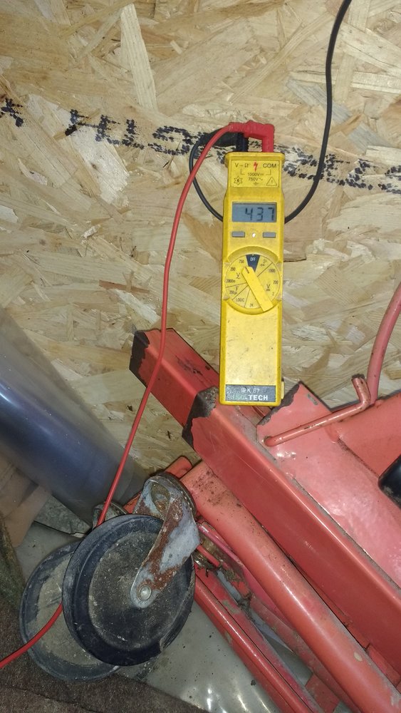

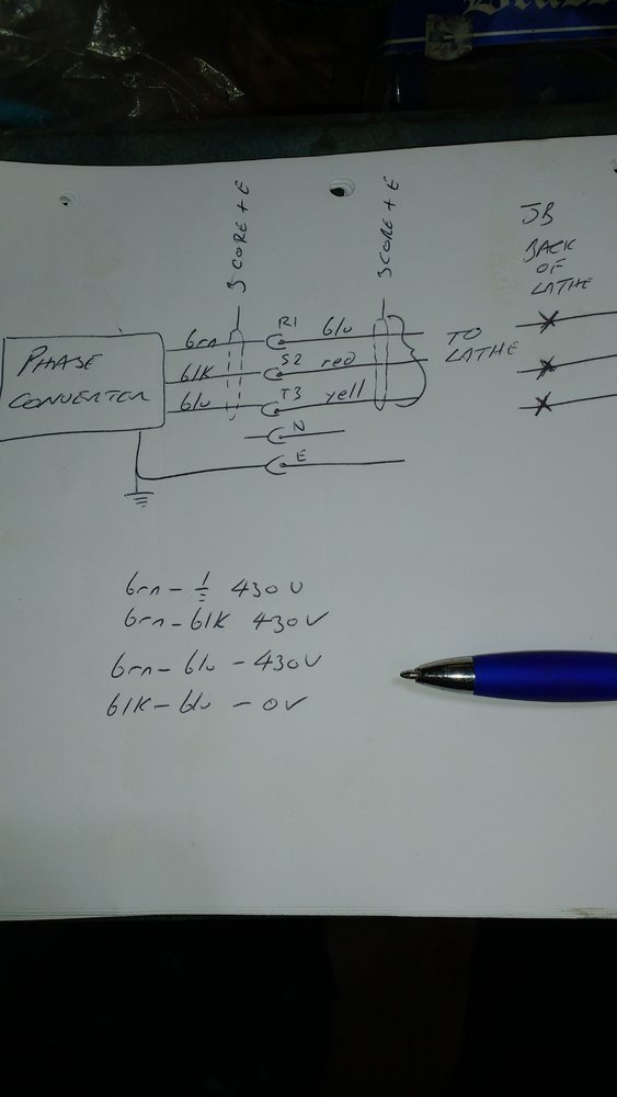

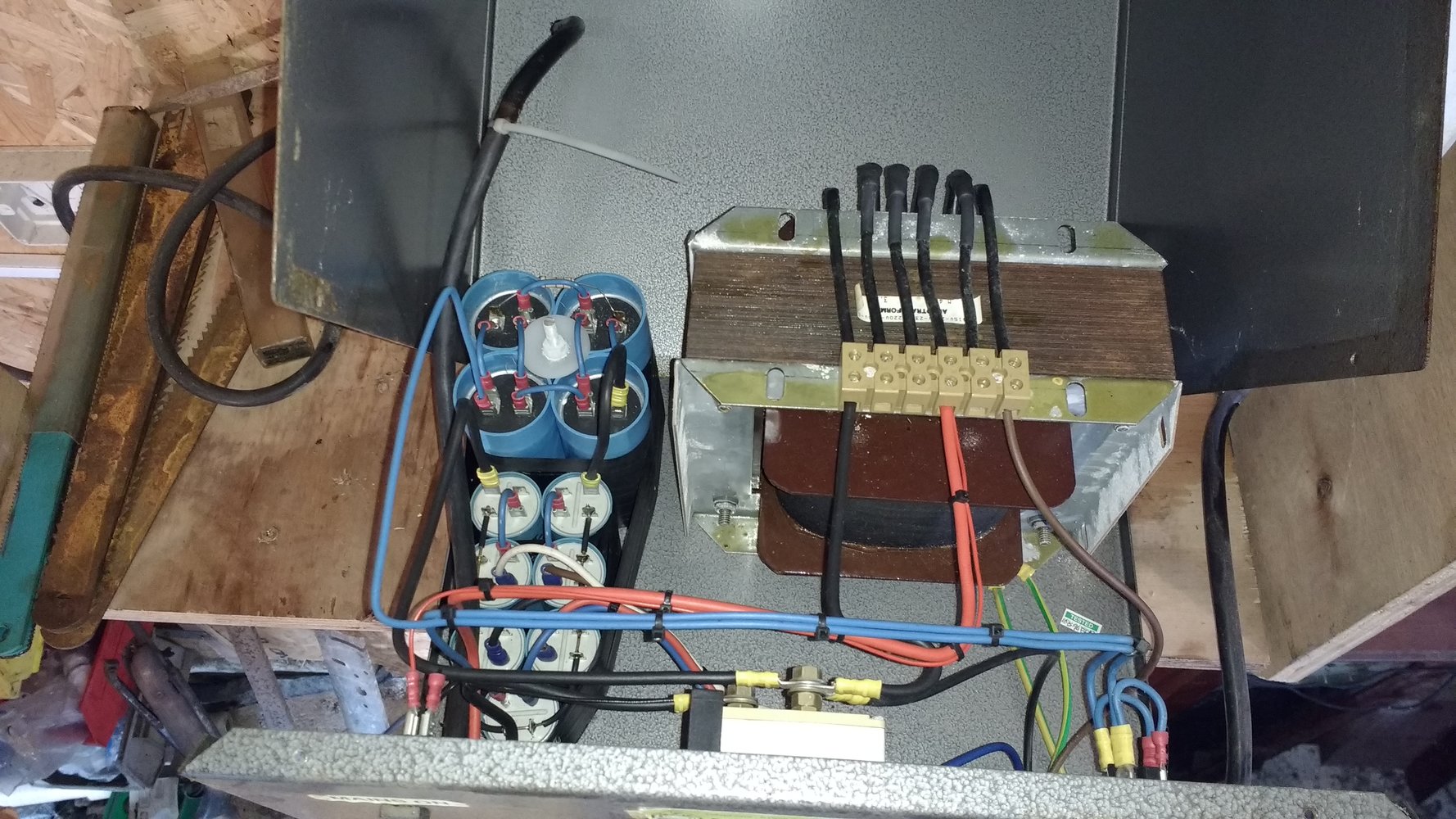

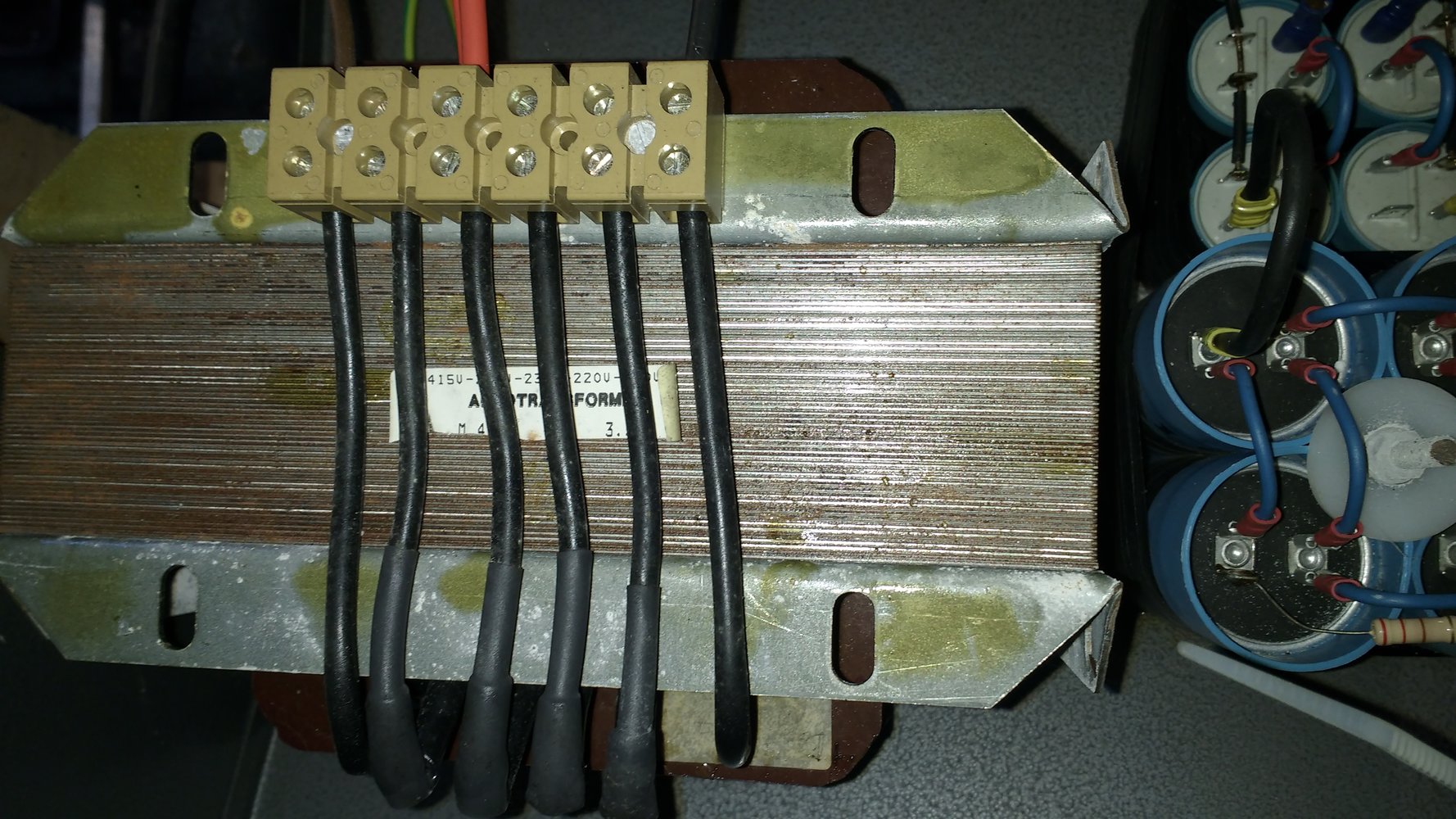

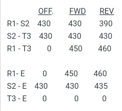

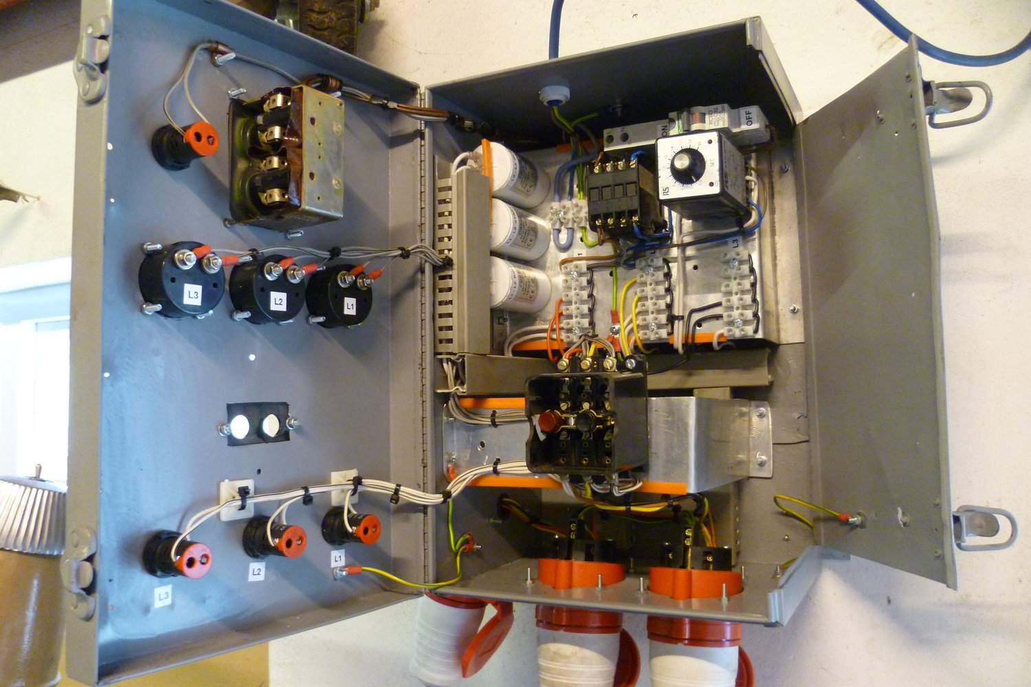

How does the boost button on a phase converter work anyone? The above results suggest I've lost a phase. It won't start on the fwd/rev switch but will get going if you press the boost button. Now I know a 3P motor shouldn't start with just two "real" phases present but will run albeit a bit crap on 2 once it's turning. Wondering if the boost does something odd to start it turning. First thing is to check the voltages properly.
Hoping to have another look this weekend.
