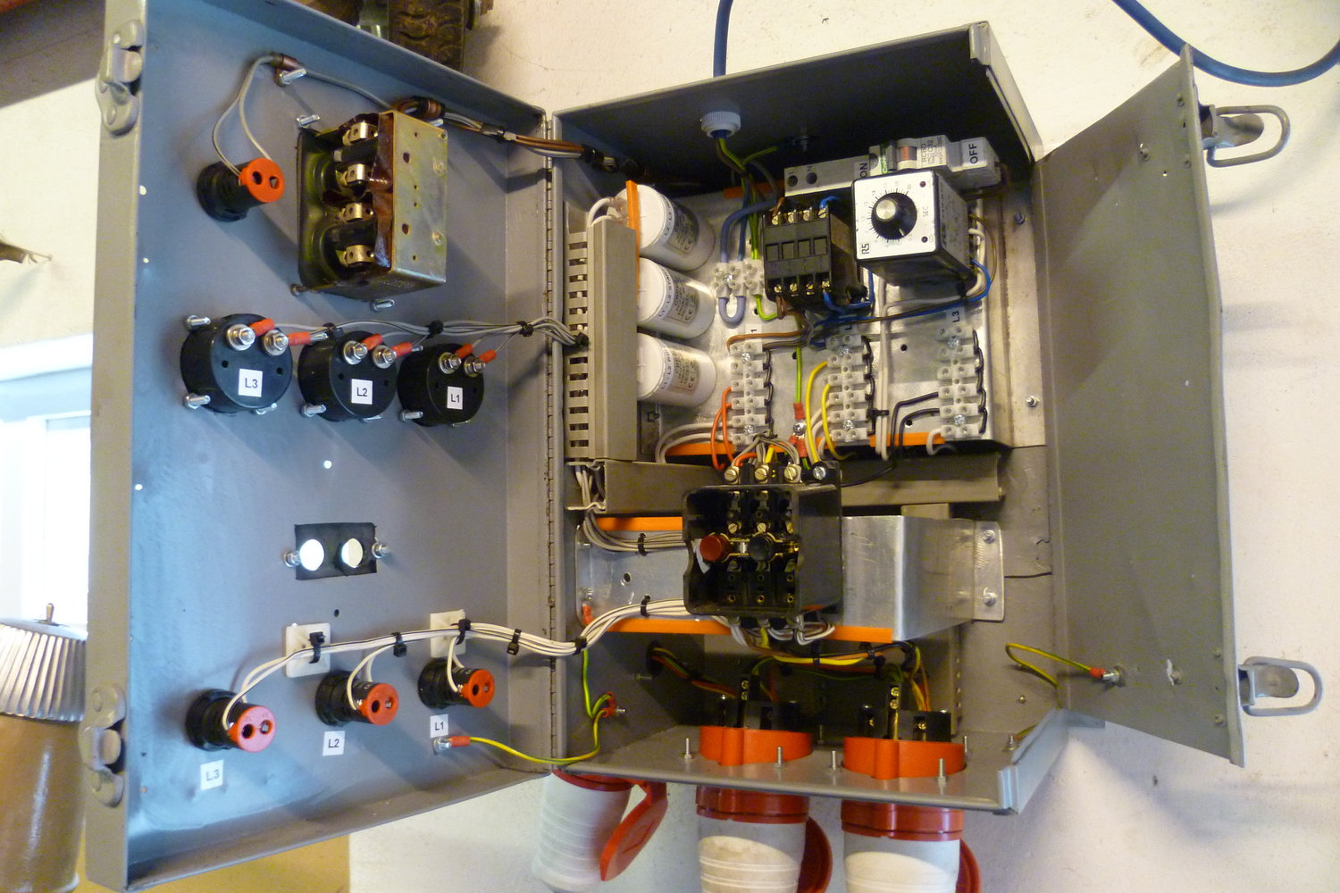

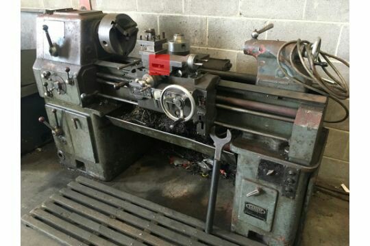

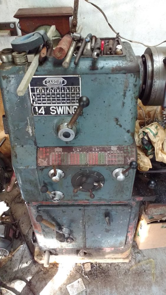

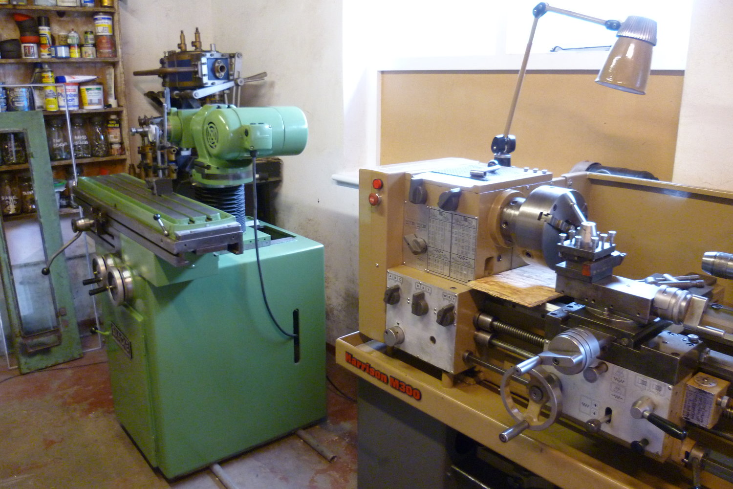

Whilst I was mid Covid my neighbour informed me his Cardiff lathe, similar to this one below, died on him with smoke coming out of the lower right panel where the stop/start buttons are.
I've been going along borrowing it for years. He runs it from this phase converter:

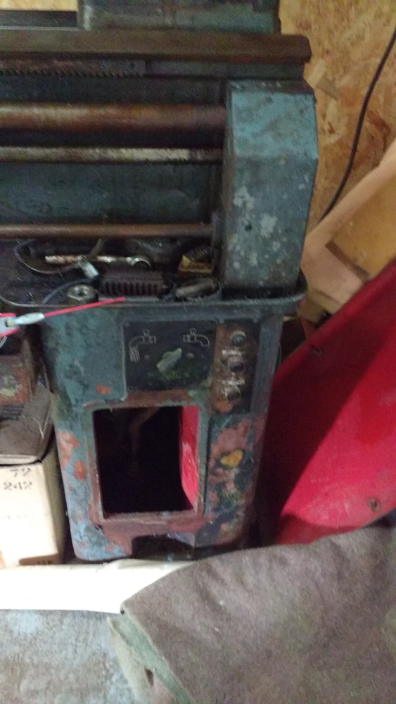

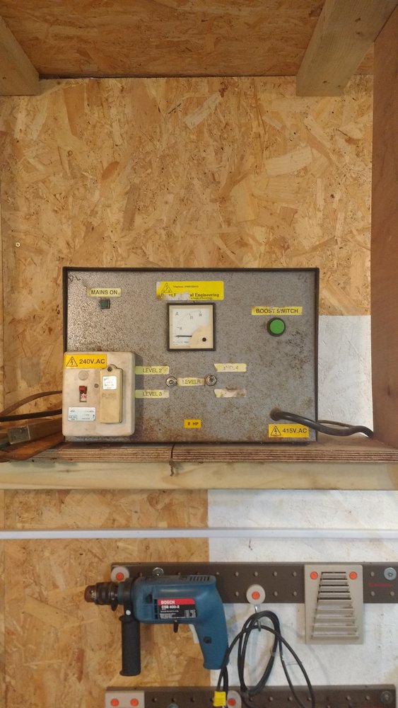

The mode of operation has always been, switch the lathe on, as you press the green start button (on the lathe) you hear a contactor/solenoid pull in behind the lower right panel. Guessing some form of NVR. The lathe isn't running at this point. Then press and hold the green Boost Button on the phase converter and start the lathe. Contactor(s) behind the lower right panel chatter like Hell initially as the lathe gets up to speed then everything settles down. You can then release the Boost Button.
I always felt that particular (chattering) contactor coil wasn't getting full voltage causing the chattering. Either that or it was getting it's full voltage but something was intermittently cutting it. There is I think in there a mercury switch somewhere.
Smoke seemingly emitted from this lower right panel area as aforementioned.
Not been along and looked yet. Any suggestions as to why this packed up on him?
Would a circuit diagram be available for this?
Cheers
