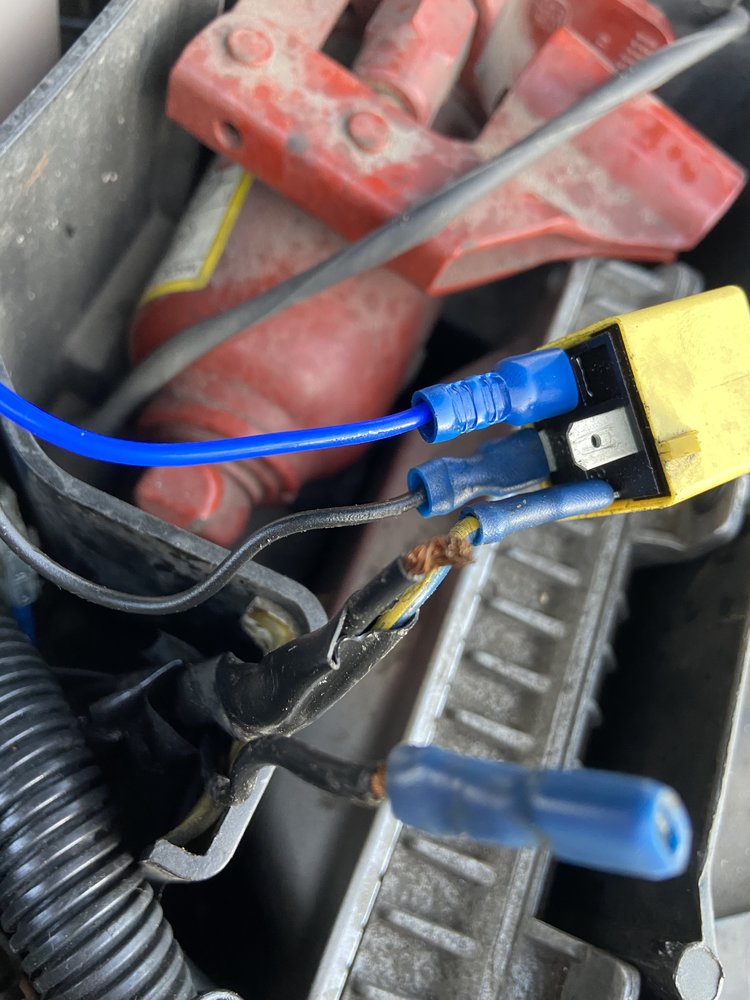

I would strip back the insulation without cutting, solder and use self amalgamating tape.Cut it, join it, soulder it and heat shrink it.
Yeh that sounds better, I’d not heard of that tape if it properly seals.I would strip back the insulation without cutting, solder and use self amalgamating tape.
I'm a great fan of self-emancipating tape, only disadvantage is it's not UV stable, needs an overwrap of black PVC tape (Scotch 88 is one of the best) if it's exposed to daylight.I would strip back the insulation without cutting, solder and use self amalgamating tape.

I used red insulting tape over the self-emancipating, will it be alright or should I swap it for black insulting tape ?![]()
