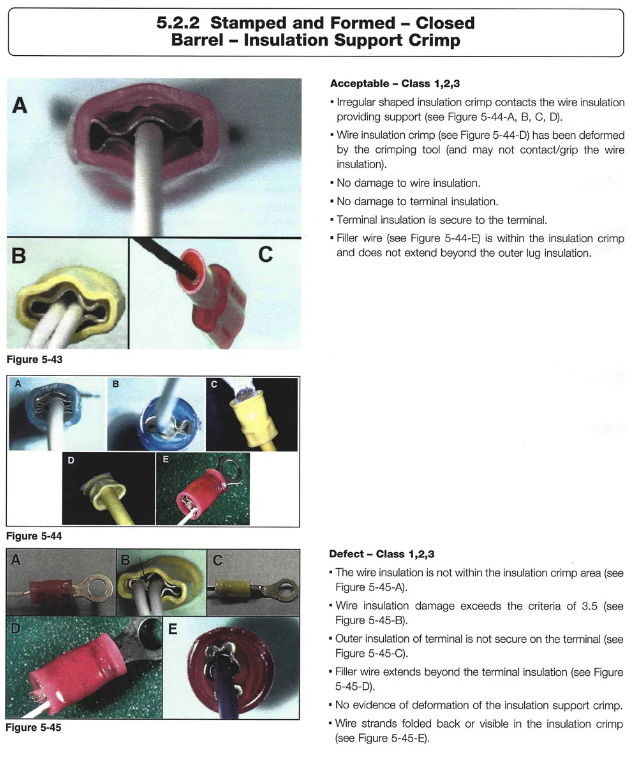

My name for 'em seems to be spreading among those who care (and have watched me work) - "Bodgers' crimps".
Dave H. (the other one)
As I said above, I also respect your opinion,I have to say, they are used extensively in industry and they do crimp properly if suitable sizes are used for the cable and they are used with a good quality ratchet crimper.
As with most things, it is a case of using the right component for the suitable application with correct installation method. Mashing it on with a pair sidecutters probably isn't it!
The type of crimp used in the video, that the op presented, are garbage, end of.
They may be crimped successfully with the correct crimping pliers of what ever sort,
Usually very expensive, we are talking home, diy users here, not industry, I'll requisite a new pair from the stores,
But how are you going to know this,
The plastic is covering the crimped, metal, important part, that you cannot see is crimped properly.
You'll never know until it fails,
And then its to late.

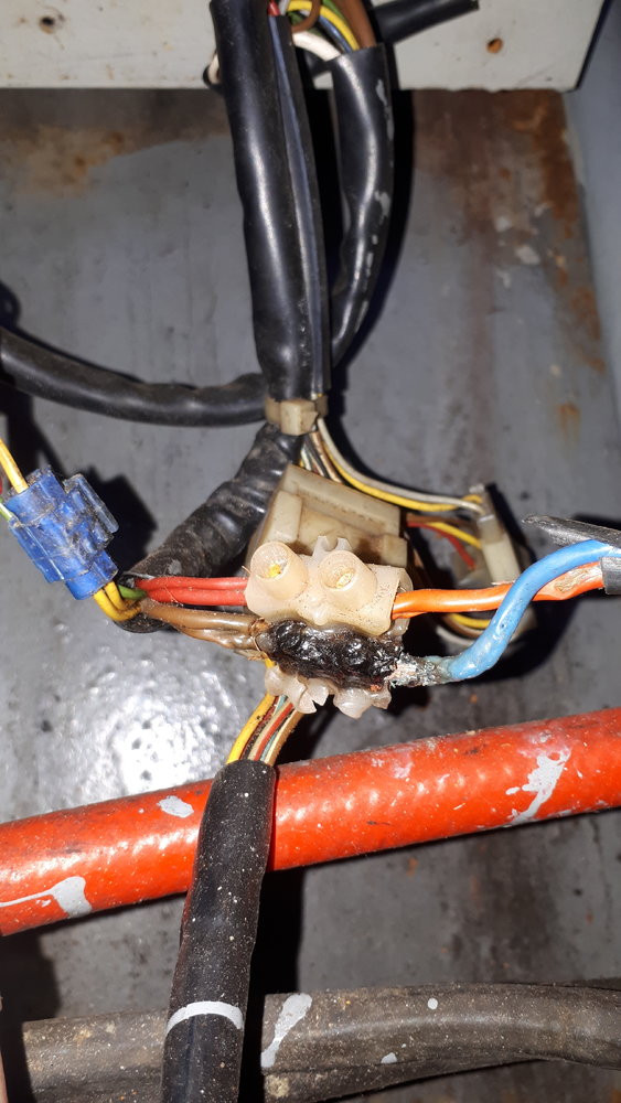

These joints were always assembled dry at the factory, pulling them apart usually results in seeing green or black corrosion; no wonder they give trouble. Putting a smear of dialectric grease on the bullet or Lucar tab during assembly as Japanese manufacturers (IME) do prevents that issue completely.Flat out across a bridge, on a night rally in my mini - pitch black, instantly....
Bloody Lucar or lucas bullet joints, the ones behind the grille, in the middle.
