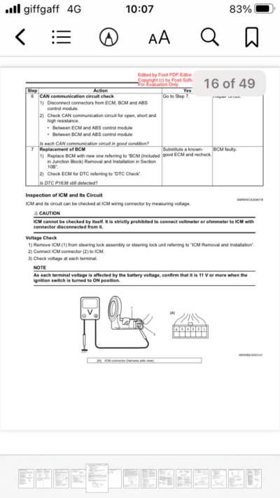

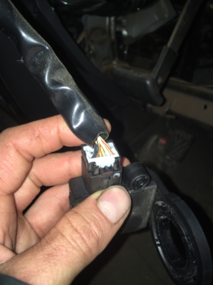

It looks like the coil is built into the immobiliser control unit, and that's what's plugged into the wiring harness?

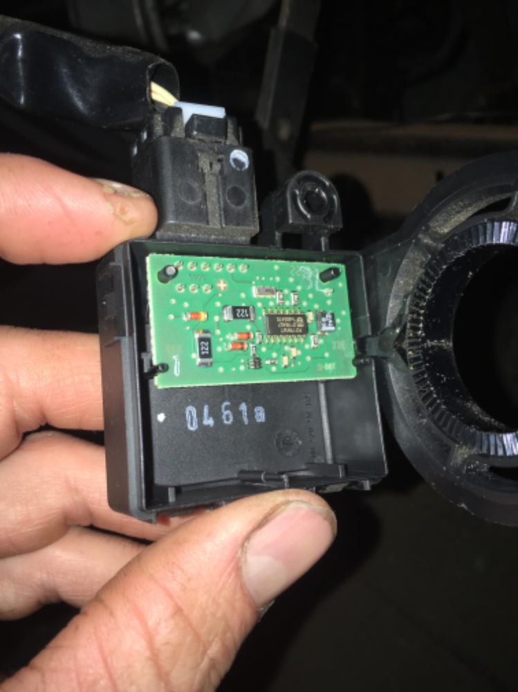

As the top looks to be clipped on, any merit or mileage taking a quick look inside, looking for dry solder joints or water/corrosion ingress, before loading the parts cannon or getting expensive with diagnostics and locksmiths?
It seems like the car is able to tell you it can't read the chip in either key, which probably means the transponders are Ok.
Quick look at a wiring diagram shows. Assuming this a 1.6 petrol variant with a vintage of 2006 - MA16A VVT engine code?
Immobilizer control module with coil reader in it - only has two wires going to it.
Pin 3 (ICM) yellow/black wire to plug A main ECU pin 28
Pin 4 (ICM) yellow/red wire to plug A main ECU pin 13
This type of ICM will come apart - they just got clips on clamshell case - you can get to the coil terminals.
Key reader failure on one of these early Suzuki's is not a common problem - later keyless Swifts and the like are awful for not seeing keyless keys.
Even with a dealer scanner SDT/SDA- this a 2006 car - the best you will see on live data - is if the imo is off or on (and you already know it is off mate).

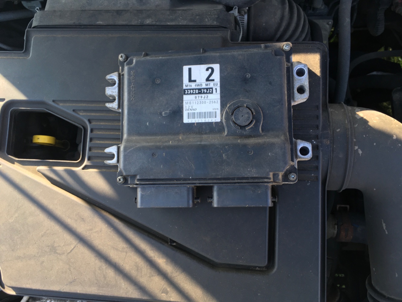

I not got the software to bypass the Imo function for a SX4 - if I did - you could have brought me the ECU and I would have dropped it out for you. I only in King's Lynn @Martin Hocking. Everybody else will have the same stuff - ImoAlice from Germany or a copy - is was the common software package in the trade at the time - but it don't cover the MA16A stuff. I doubt there is anything that will do this software wise - it would have to be done by a hard Julie emulator.

These people sell Julie pack emulators - for what I think will be your application? (Hitachi..? But don't take my word on this - get ECU out and read the label)
- Denso 33920.x (93C56 EEPROM + 29F200 Flash) (Metal Cover)
- Denso 33920.x (93C56 EEPROM + 29F200 Flash) (Plastic Cover)
- Denso 33920.x (93C56 EEPROM) (Metal Cover)
- Denso 33920.x (93C56 EEPROM) (Subaru)
- Hitachi 33920.x (93LC46 EEPROM)
- Hitachi 33920.x (OKI Memory)
- Hitachi 33920.x (24C04 EEPROM)
- Hitachi 33920.x (X24C01 EEPROM)
