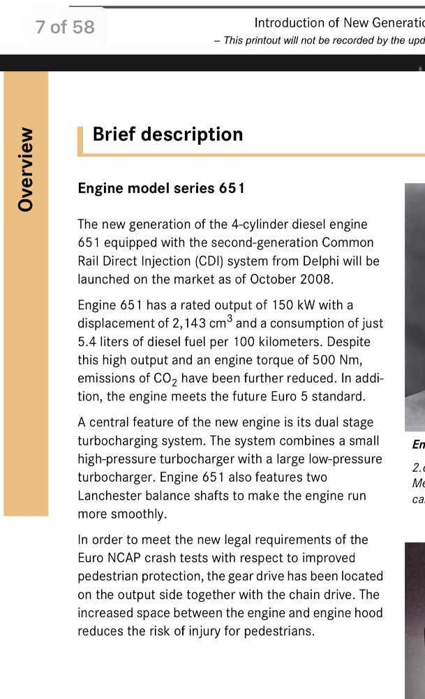

Where did you hear that nugget about the OM651 timing chains from? sounds like utter bolleaux to me and certainly never mentioned in any M-B training material. Given the amount of clutter at the front of the OM651 & OM654 engines, putting the timing chain there as well would make the design of the coolant galleries problematic at best.
Yes, going to a simplex chain is emissions related - but they're not really that bad of a job to replace, not compared to a lot of BMW engines - also at the rear but with far more room between the bumper cover and the front of the engine.
