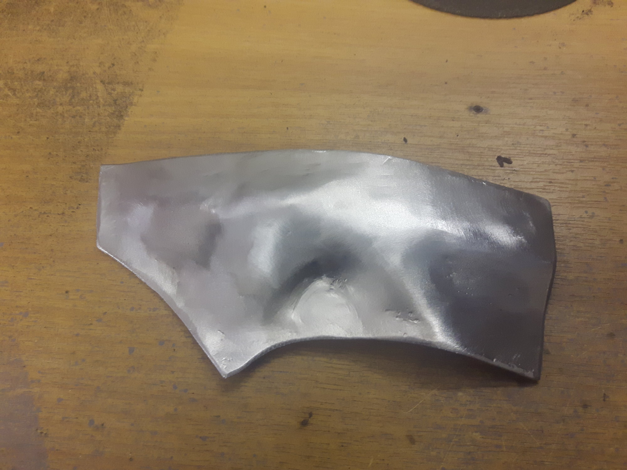

    Looks like you have a natural ability there mate, you obviously understand how the material acts, how to visualise the development and how to manipulate it.

    It's one thing that I've always been good at is visualising how things go together. It's like having an exploded diagram in my head. I pick mechanical stuff up quickly. I'm the kind of person who struggles to figure out how to do stuff with paper and textbooks and it makes no sense, but let me look at it and play with it, or let me see you doing it and it seems to make perfect sense. That's why I'm definitely not the type of person to have a career behind a desk....lol.

    As Sip-free said.
    When making tricky repairs I'd recommend to make the repair over size to give you a but if wiggle room to adjust it. And depending on the repair, sometimes it's best to leave the original metal in place until you've made the repair. But you're doing great and certainly not afraid to give it a bash which is the best way to learn.

    Yeah, I think it's just force of habit as part of my day job is making patches and infills for skin repairs. Most of the time we have to cut away all the bad metal and traces of corrosion first before a repair is designed as they can cost thousands every time. There's nothing that drives the engineering department up the wall more than designing a repair then coming back and having to change it because you found another bad bit and all the measurements are off, so our holes and gaps are already there and we have to adjust the already oversize panels or patches to make them fit....which they never do. Unfortunately I don't get the opportunity to weld any parts or make up complex shaped parts, the metal shop and welders do that. We do make a lot of parts but they're usually relatively flat or only have slight compound radii. If we start going in to the territory of doing other folks jobs they get a bit upset so we have to stick to our own thing...sadly...

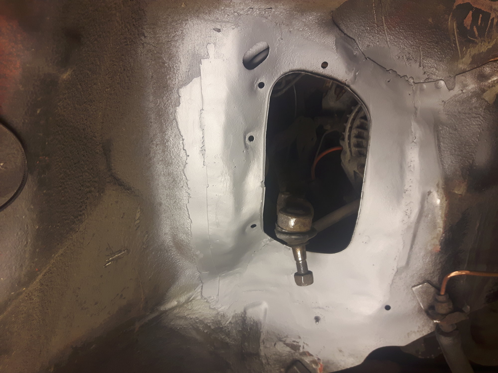

    Some really good fabrication work there. You can make an edge tipping tool from bar stock with a slit cut in to the depth of the flange.
    Don't forget to change that brake line in the wheel arch.

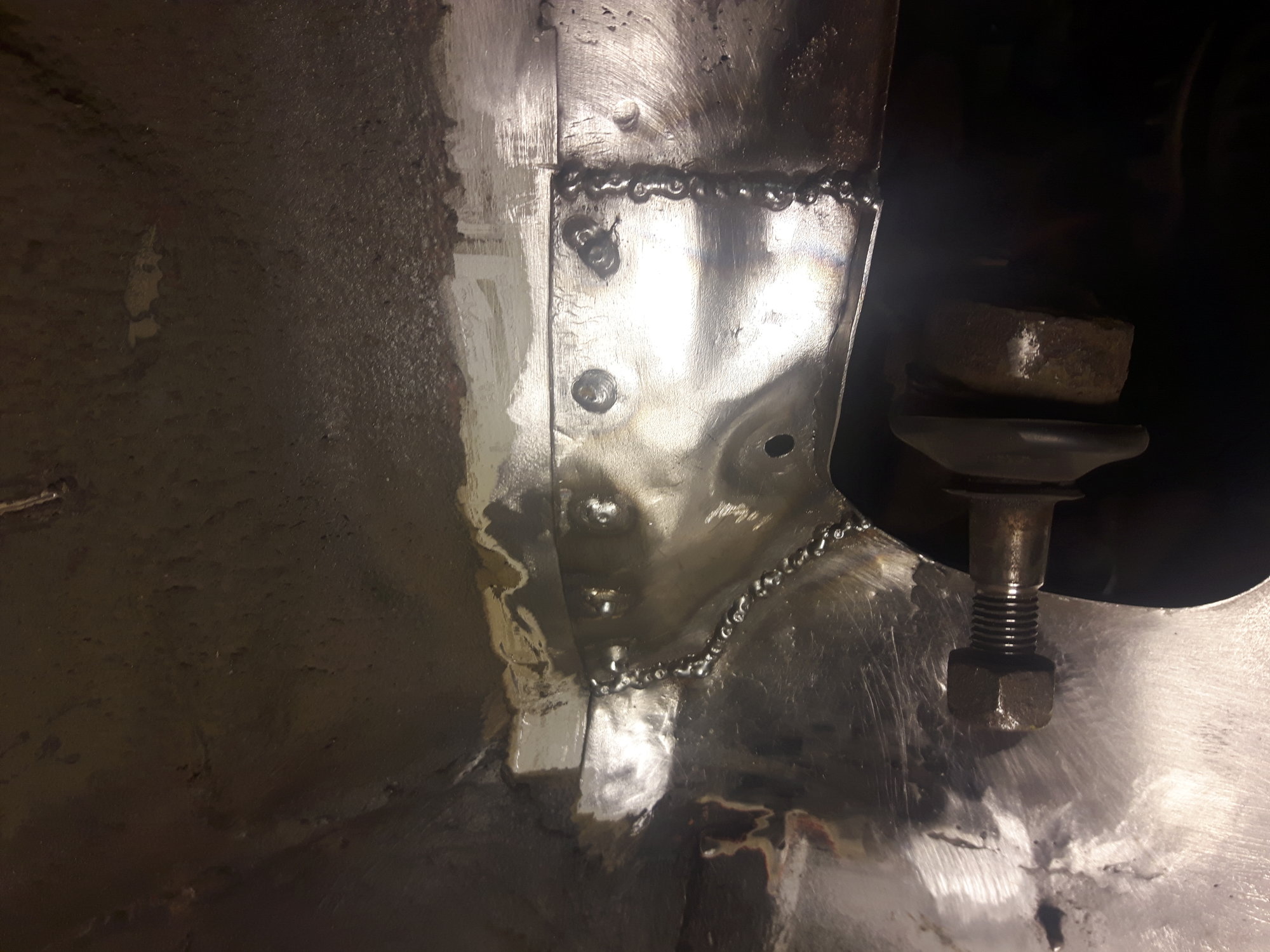

    Ha, you noticed the brake pipe?? Yeah, I got a bit carried away with the flap disc and took a chunk out of it. Lol. It's not a SAAB it's actually a Mk3 Astra Estate. It's the osf wheel arch with the wing removed. Its the hole where the steering arm comes through the inner wing. Absolutely full of rot. Getting there now though, did another patch repair today and it went really well. The C02 and solid wire is like night and day.

    You'll never go back to flux cored wire for body repairs once you've tried gas argon co2 is even sweeter to use. some nice fab skills you using on this car keep the photos coming:thumbup:

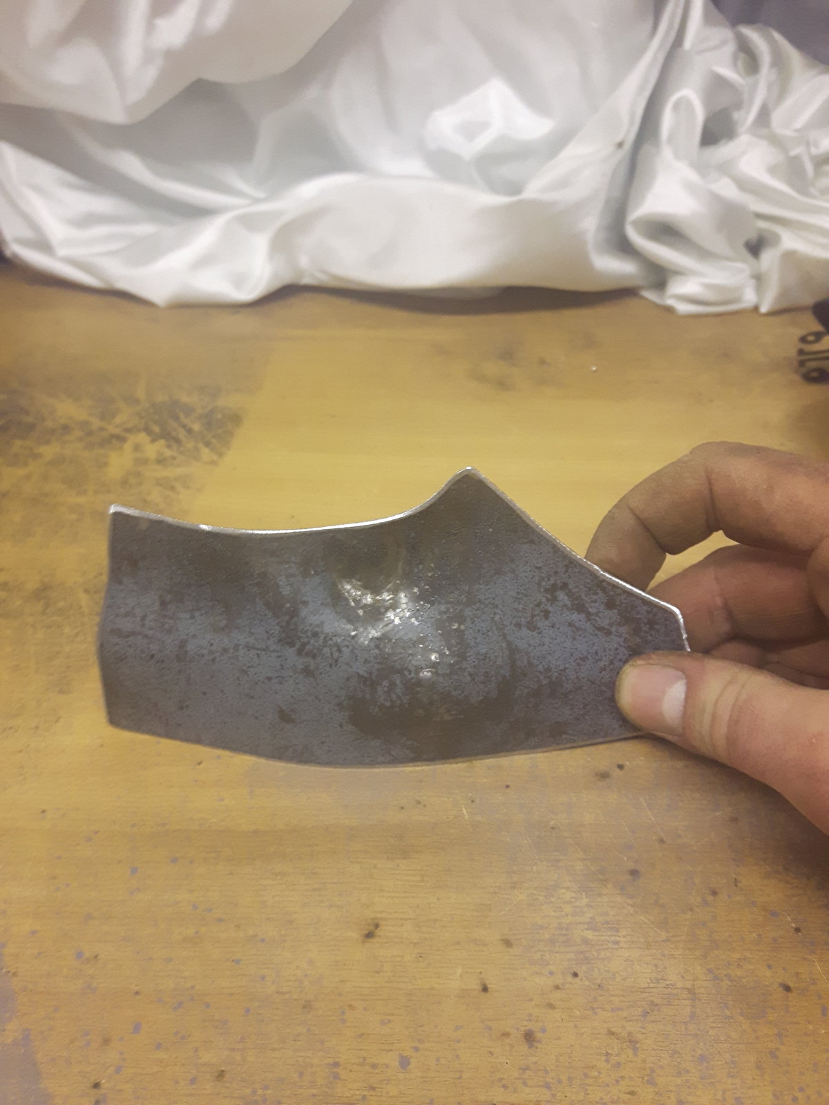

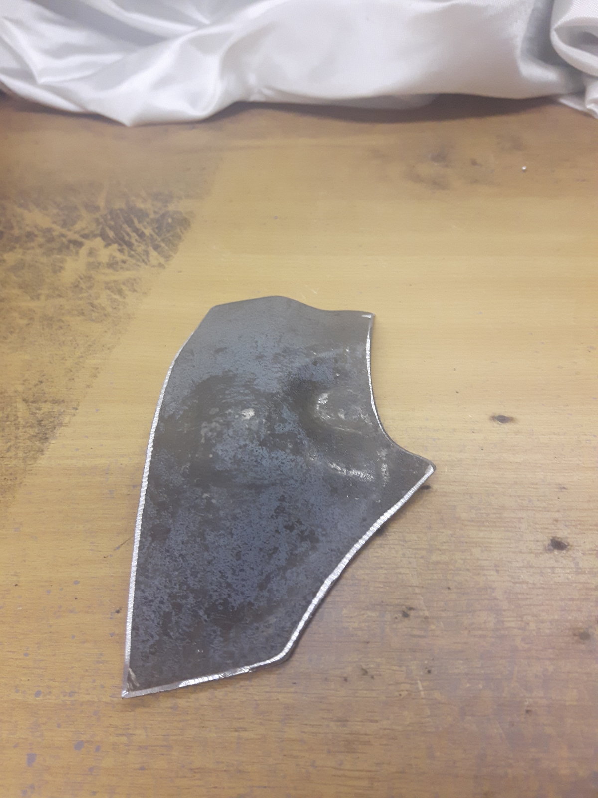

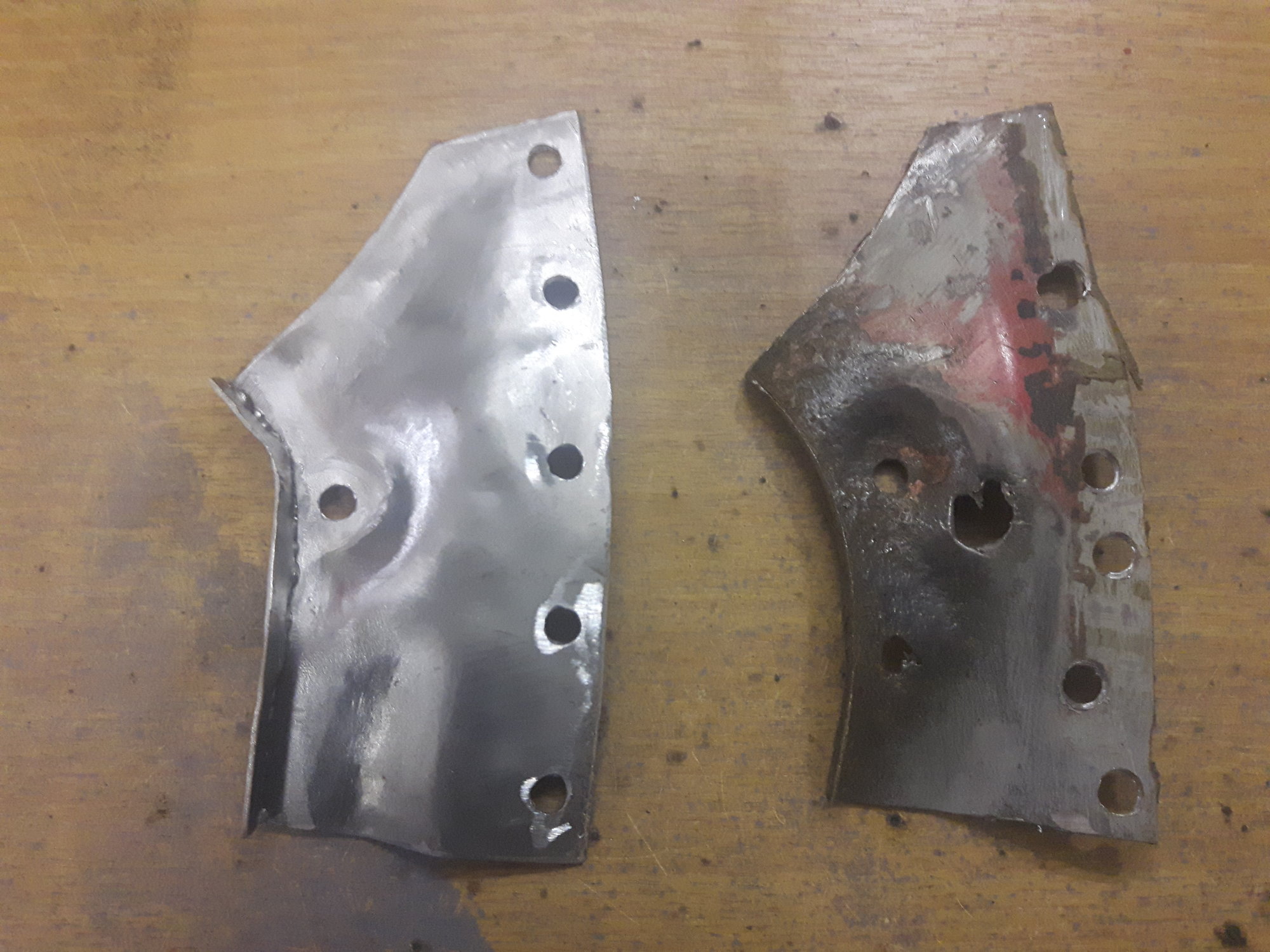

    Some of my efforts today. 20180113_161800.jpg 20180113_161811.jpg 20180113_162911.jpg 20180113_175156.jpg 20180113_182416.jpg 20180113_183913.jpg looks slightly better than it was....
    I'l definitely not be going back to the flux cored wire. So much easier to weld and so much less mess...
