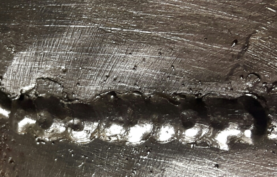

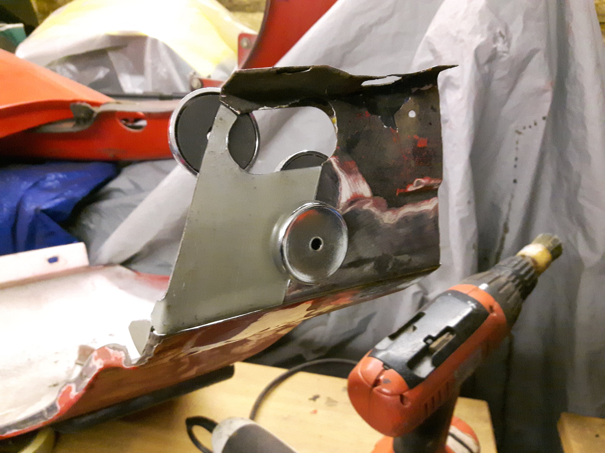

    I've only recently started welding and to date it's only been box section. My welds I'd say looked reasonably sensible so I thought I'd try something a little more challening....and a bit thinner. I'm currently restoring a car and decided to tackle the welding myself. It was a bit hit and miss at first, some of the welds weren't too great and when they were solid they were still a bit messy. I wondered if it was because I was welding with flux cored gasless wire. I tried my hand on the wings and obviously the welds had to be tidier and invisible as you could see this area. I think the welds turned out OK, but they took forever and I had a lot of issues with burn through and pinholes. It only really started to work out when I used a copper heatsink. I've now changed to normal wire and C02 but not tried it yet. Any tips and pointers to get decent penetration without blowing through?? 20171216_172620.jpg 20171216_205145.jpg

    You will find Co2 much better than fluxed core on sheet metal, Argon mix better again. Welding near those magnets will affect the arc and give you porous welds that look like you have no shielding gas.

    Ah, that I never knew about the magnets. I had no idea....

    Hi, your efforts look good, agree with everything Wallace has said.
    Just keep trying out with scrap metal of the same thickness, practice practice practice!
    Argon mix with non flux wire will get best results..... start off with welder at lowest setting ( dependent on welder ) and increase till you get best results.
    If you can get down to 20 amps you should be ok

    Use the magnets just for lining the weld up, put a few tacks in to hold it together firmly then take them off and put them out of the way so they don't pick up all the dust from the grinding!

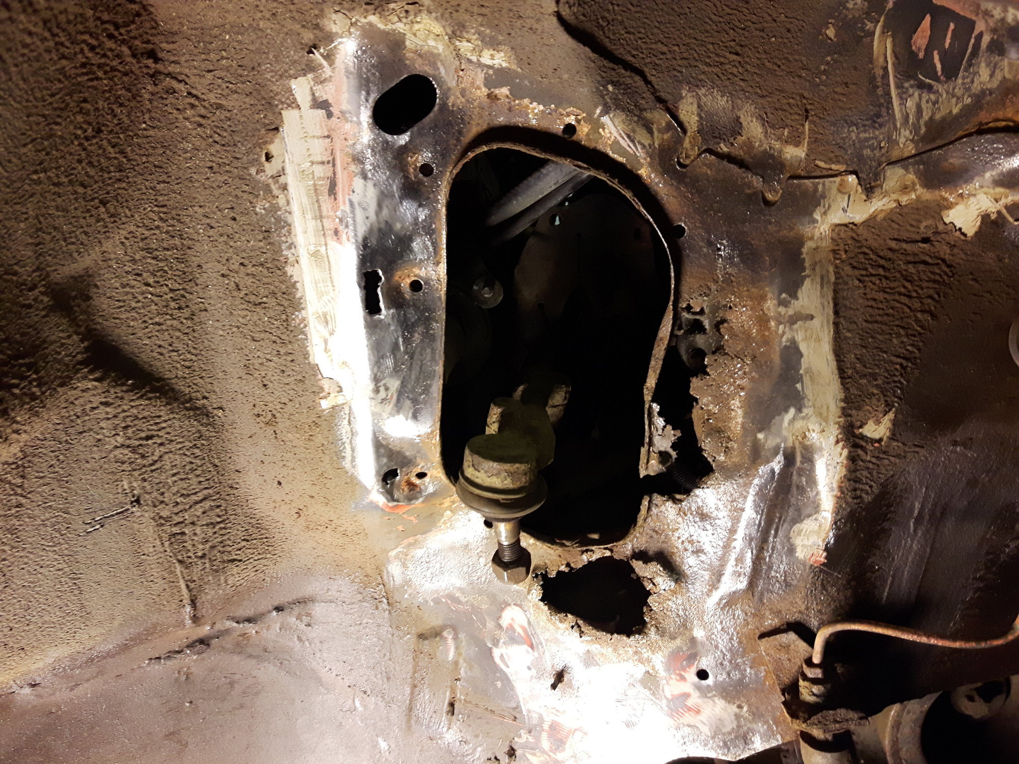

    Aww good. I'm finally getting somewhere then by the looks of it. I reckon the flux wire must've been a bit fierce as this seemed so much easier. 20171231_222707.jpg The weld ground down nicely and there were no lumps or pinholes like the last time. I made up a repair patch and welded it in. Not overly pretty but it seems rock solid and nobody will see this under the primer and stonechip. 20180107_160006.jpg

    Did you make a repair panel, cut a section from another car or cut the rusty bits out and repair them then weld back in? :confused: I can't tell! :laughing:
    Matt Thomson likes this.

    Thanks guys. I'm starting to feel a wee bit better about my work now. The repair panel I made myself. I cut from an old locker shelf. I cut the rust out and made a card template of the infill, trimmed and bent it to shape. The lip around the hole was made by cutting a pre folded edge that was already formed on the old shelf. I cut along the radius and used it as a guide to grind it down straight as possible and kept the pre cut edge to the outside. I tacked the strip to the edge of the panel and used a small hammer and pliers to bend the strip in to shape and follow the contours of the panel edge, then stitch welded along the length nof the strip to make it rigid. A lot of grinding with a flap disc and some hand filing finished it off.

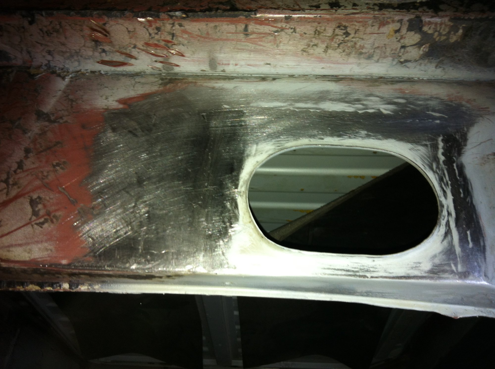

    You're doing well and doesn't look like you need much advice especially when this stuff normally looks better in the flesh than in the pics. I think the trick with car stuff is being inventive like you're doing. The first idea might not work out so you have to think of another way to make something but quite often the simplest way is often the best. As Wookie said you can tweak up an edge like that with pliers or adjustable spanner etc and then finish off the edge with a hammer and dolly. (Kennedy's panel beating hammers and dollies from Cromwell Tools are decent for the price if looking for some.) That's how I did the repair for this hole for a petrol tank pipe and lip for the seal.
    Keep the pics coming.

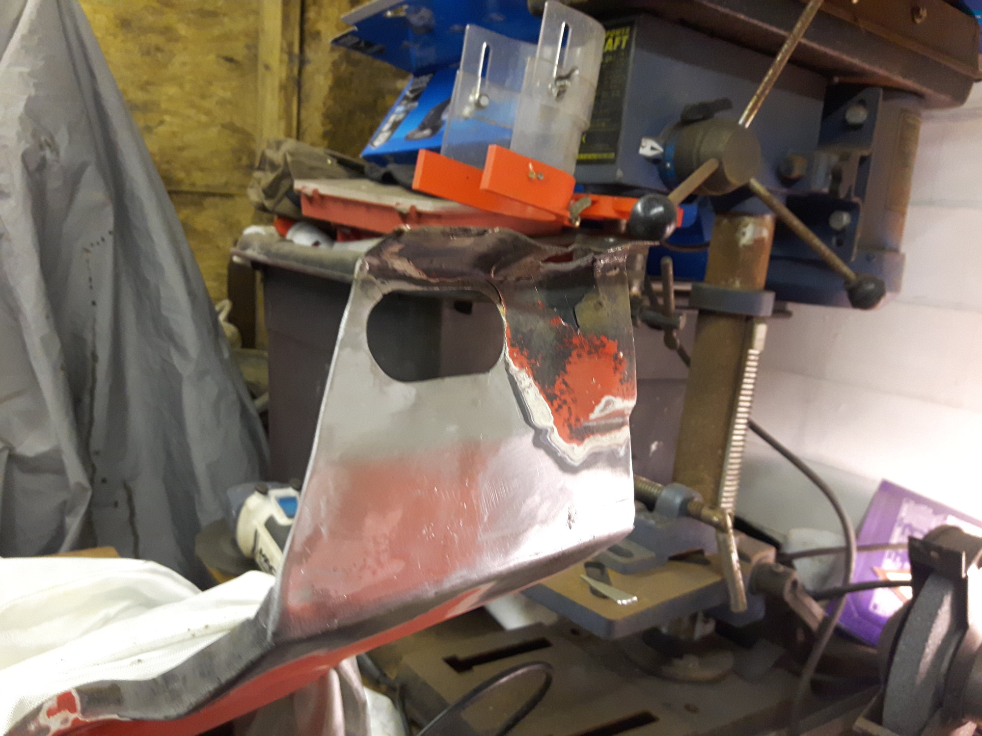

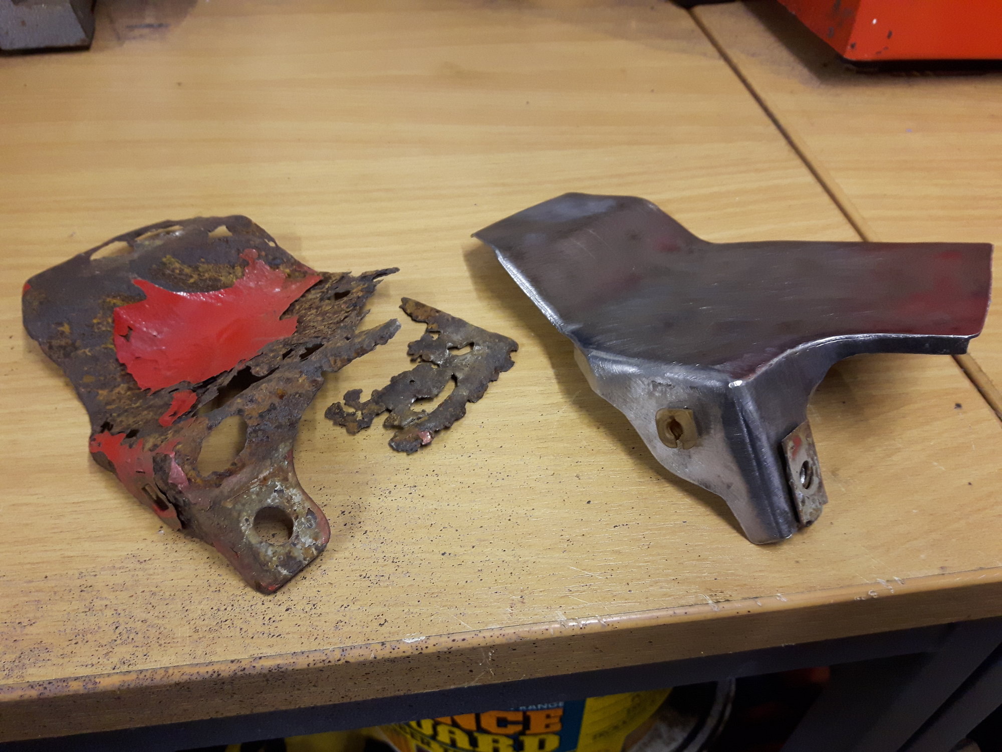

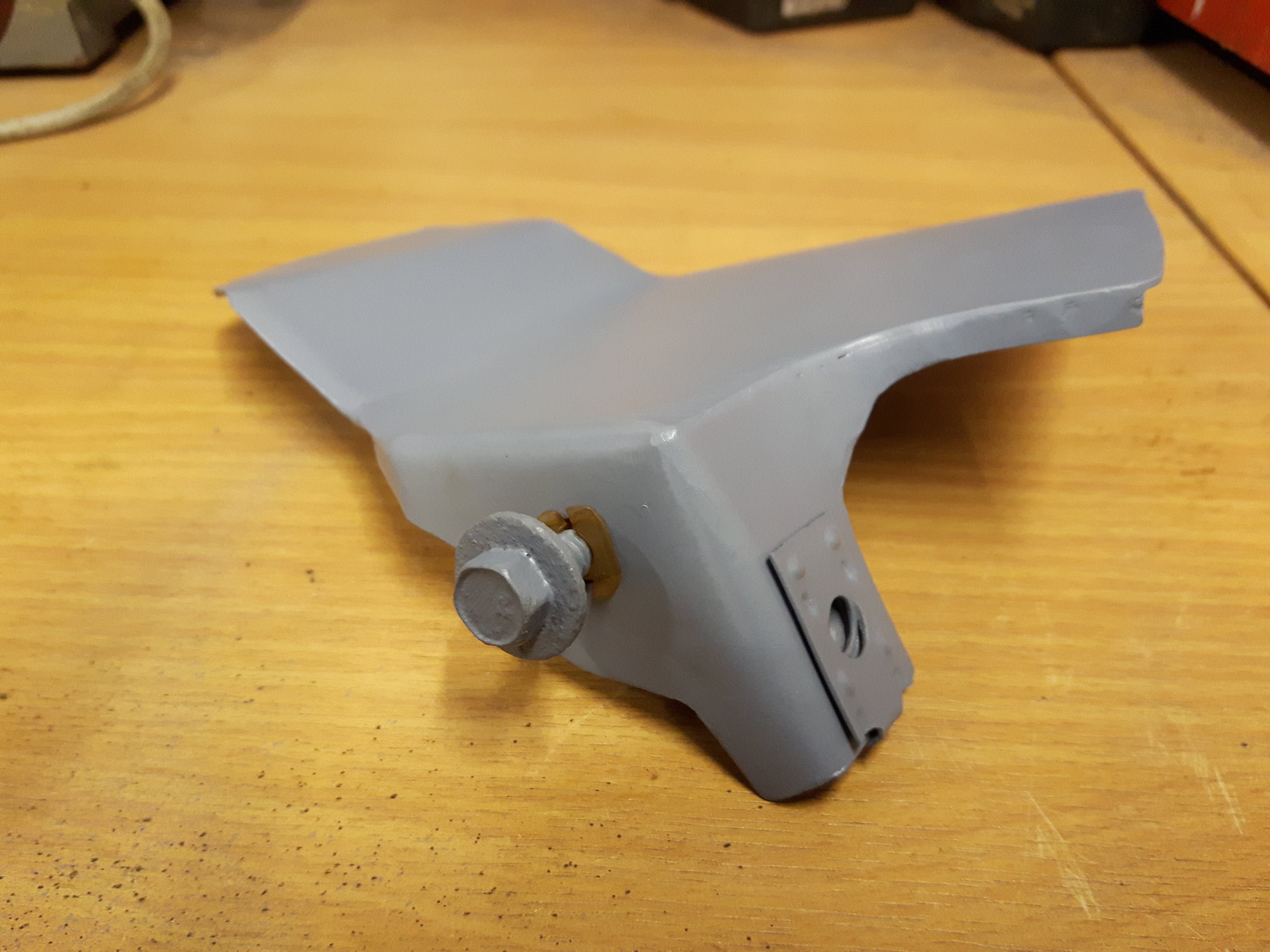

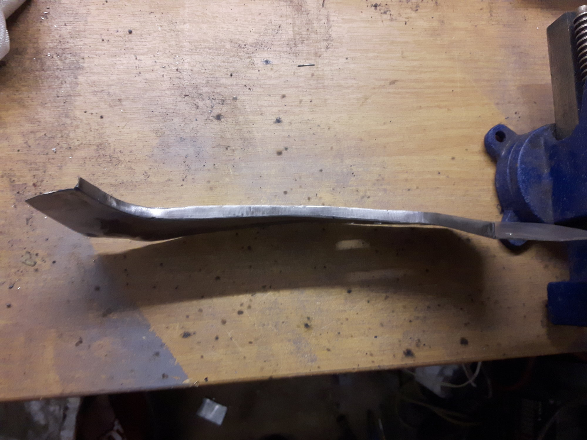

    I actually had a go at building a bumper bracket and it came out amazing (after all the splatters were ground off) so I thought I was winning but then it all seemed to go downhill after that, hence coming on here for advice. Here's the bracket I made which I was quite proud of.....
    To be fair, there wasn't a lot of welding in this one, mostly bending and hammering. The curved section and a small tab on the other side was all that was needed welded to strengthen it as it was made from one piece of metal.
