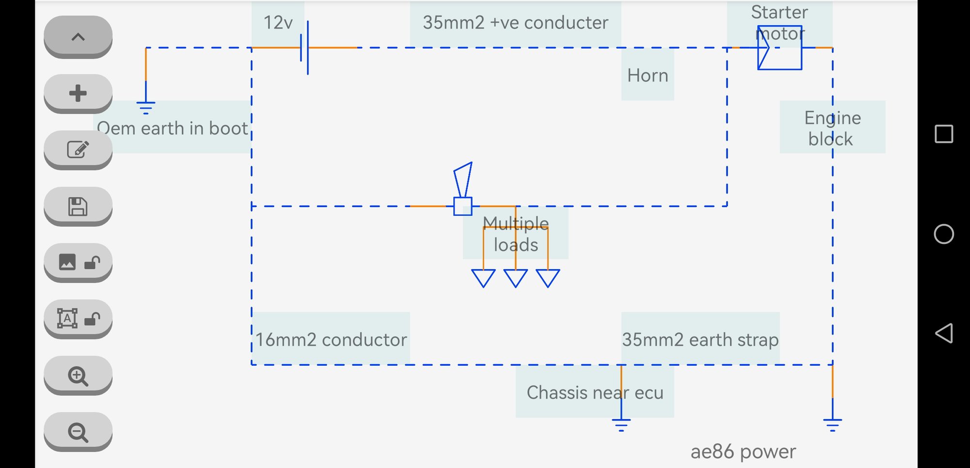

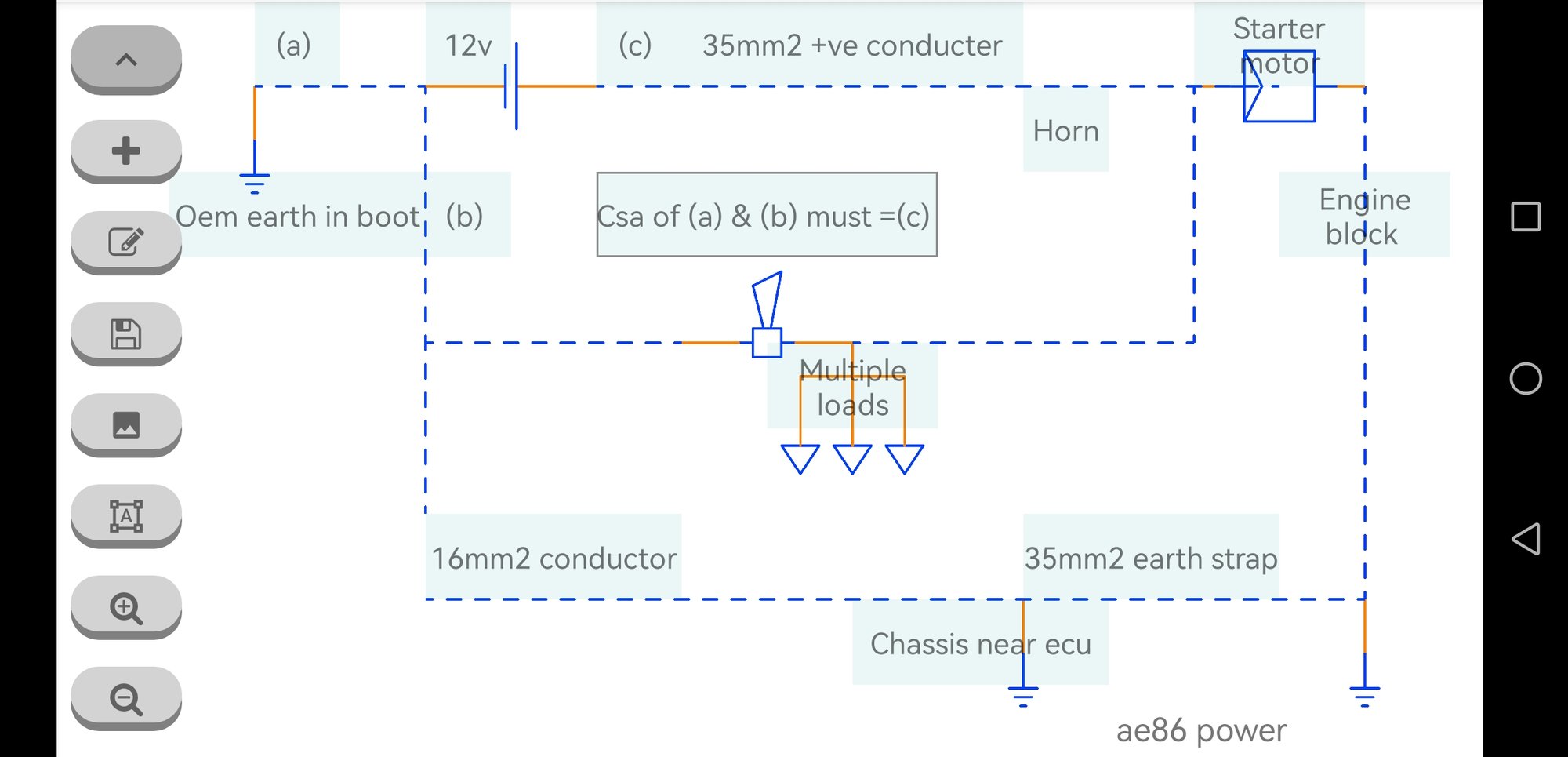

Just make sure the earth return path to battery matches the cross section of the 35mm starter supply because the same amount of current passes through it.Thanks everyone, I've just ordered 4m 35mm2. I'll use the 16mm2 that I have to run the earth back to the passenger footwell junction box, and I'll daisy chain on to the engine block. I'll also fit earth straps from the block to the chassis legs, so there'll be continuity right through the chassis. The oem has a ground point on the rear lamp panel, so I'll add an earth strap to that from the battery - ve terminal....can't do any harm.
Surely the body shell also acts as a conductor?Just make sure the earth return path to battery matches the cross section of the 35mm starter supply because the same amount of current passes through it.
I see what you're getting at now, cheersIt does, but the cables from the battery ground to bodyshell and bodyshell to engine block/starter have to be able to carry the current drawn on the starter supply.
