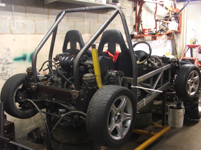

Absolutely love it! Keep posting the pics!![]()
With regards to a potential starter motor as reverse, you say it might reduce ground clearance?! I was more thinking of mounting it straight onto the rear axle or something like that where it's out of the way and can turn a gear somehow. If you'd gear it low enough it should do fine. I doubt you'll use the reverse gear for much, so short bursts (one or two buggy lengths) should be fine, especially with the engine running so it would have enough charge to operate.
Either way, I'm just loving the way you're buliding that buggy out of the car bits. Looks awesome!![]()

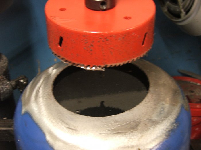

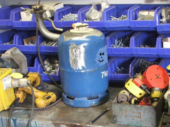

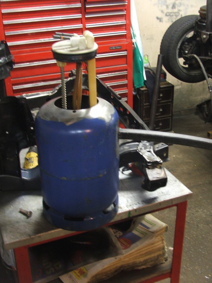

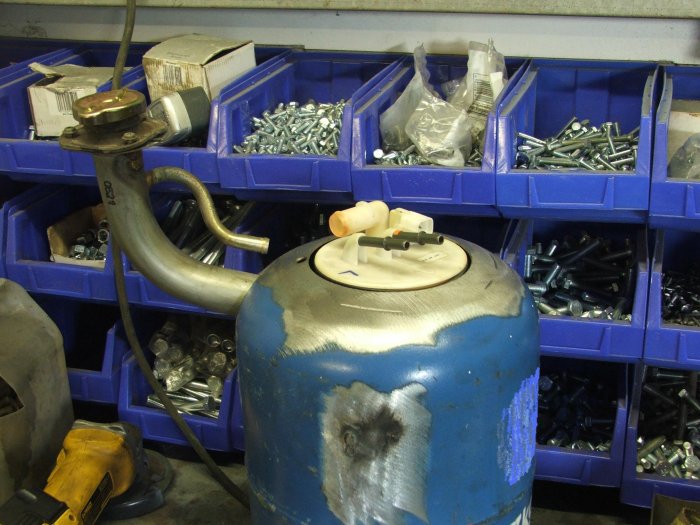

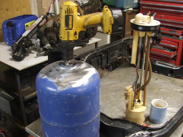

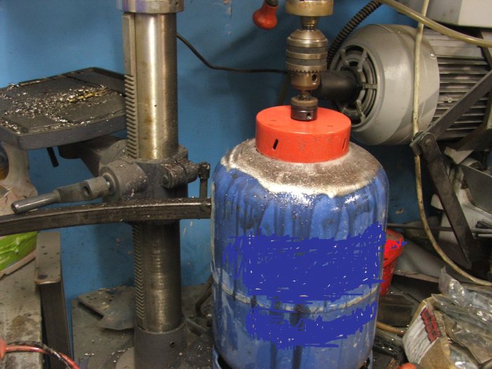

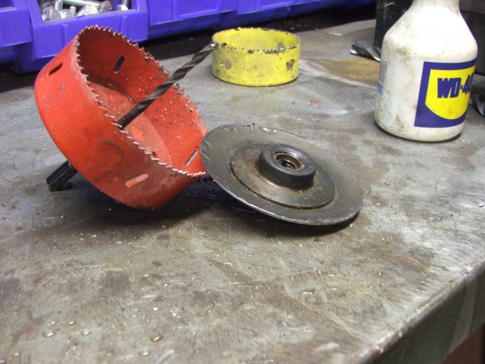

so l wedged the valve open to convince myself it was definatly empty, then using a battery drill l drilled a 10mm hole in the top near the valve, once l had done this l filled it with water through the 10mm hole, that gave me the confidence to take the 9" grinder to the valve and off with his head
