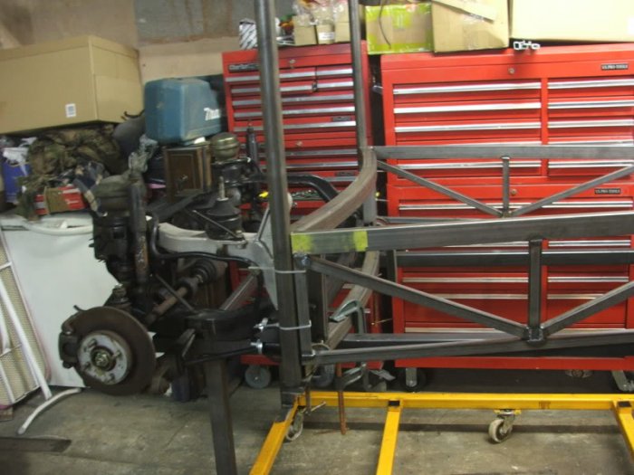

    l am 2 weeks into this and have started welding the frame together,
    things have moved on from a metro to a mgf as a base

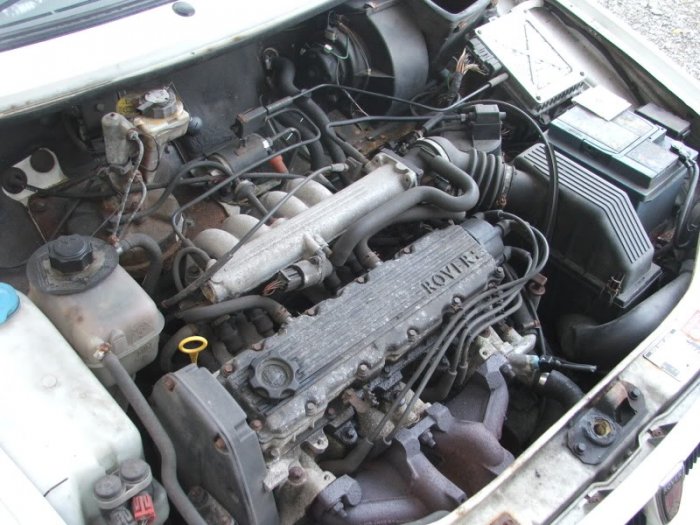

    heres the metro that l bought for £90, it was the cvt gearbox that attracted me to it, but the k series engine seems to have its advantages as well, all ally nice and light ranges from 1100cc to 2000cc turbo :cool:
    my first idea was to use the metro front subframe in the back complete with the metro engine and box but after doing a bit of digging around it soon became clear l would be better off using a mgf rear subframe, engine and box, virtually the same subframe but the hubs are already locked off to stop them steering and there are hand brakes biuld into the calipers which wouldent be on the metro hubs plus the gear change is already sorted with a pair of easily adaptable cables
    Andy

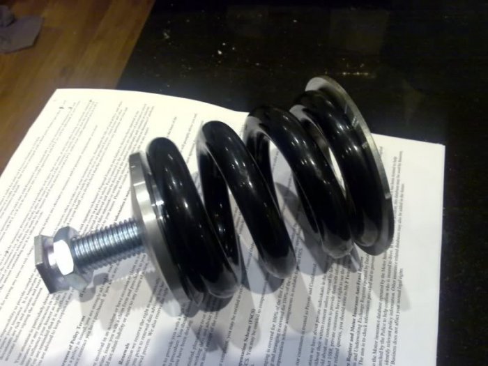

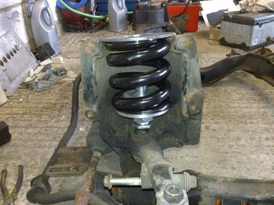

    well you are not alone in thinking that, everyone l have asked has said go back to springs, but l am still thinking about giving the hydro a go :o
    that way if it fails l will know not to use them again, but they come free with the subframe and are l assume adjustable by reducing/increasing the pressure,
    this will be important as the buggy should wiegh less than half of the orginal vehicle so if l go and buy the springs below then the spring rate will be for a metro/mgf so they are going to be too stiff ? and l expect them to be dear to have made to order as they are not the normal diameter ones,
    l was thinking about getting a second hand pump for filling the hydro units and valving them all individually so as l can play around with the pressures, l am hopeing a second hand pump will be less than one set of springs that l will have to guess the rate of anyway
    l realise using the hydro units maybe the wrong way to go but they are free and tyring them may rule them out for future use
    some metro conversion spring pics l found on the net somewhere

    if you want to keep it cheap you can 'individualise' the hydro units. you can buy the kit of can get the schrader valves off the rear and weld up one end of the pipe, means you can fill each unit individually. need to get another 2 valves for the front though, and take care bleeding the suspension! get high pressure antifreeze all over the place :laughing:
    alternativly if your going the rear wheel mgf type frame the mgtf had coilover suspension, bit pricey though
    and k's never came in 2l turbo, thats the T series, stands for ton :laughing: big cast iron block!

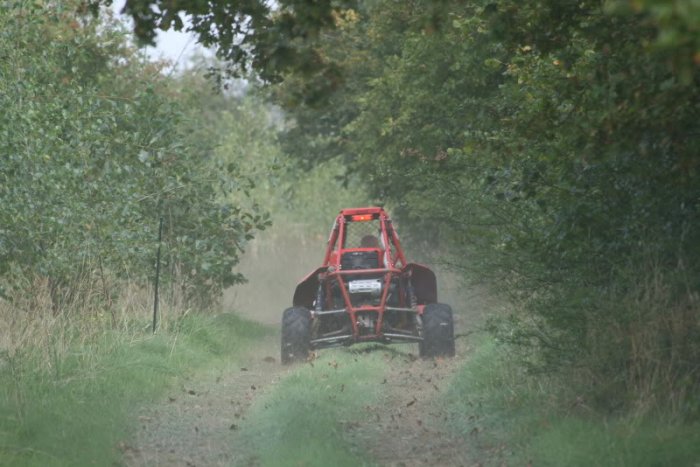

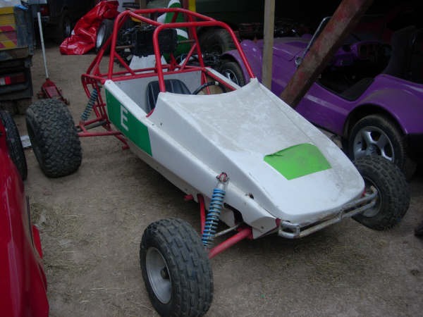

    please dont think l am against motor bike engines they have their good points, in fact l need one for one of my other projects of which l have a few :whistle:
    l have this buggy looking for a power plant

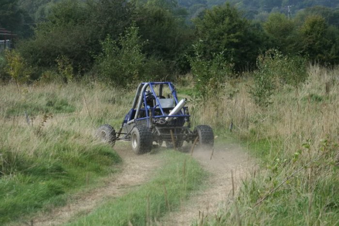

    it used to have a 500cc sled 2 stroke engine, very quick but un unusable due to the noise it generated, you wouldent want to be in the same county as it,
    l bought it with out the engine and plan to fit a mc engine or better still a quad motor since they have reverse if l can find one cheap
    l agree all my objections to a bike engine for the 2 seater buggy can be over come, but at some cost, a FnR reverse box from the states is $3000 and a second hand quaif reverse box is around £600, not to sure about the durability of the starter motor method and you usually loose quite a bit of ground clearance

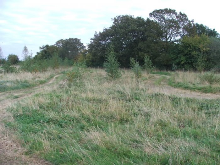

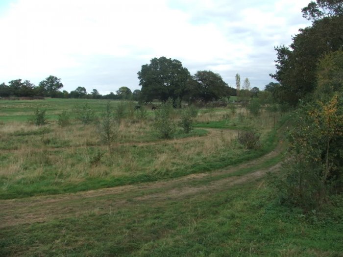

    l am calling this an offroad buggy but thats the wrong description really, l should call it a gokart or grass track buggy as the intended use is on a grass track that is realatively smooth and undulating winding its way through the trees, so l dont see the limited wheel travel as to much of a limitation, heres the track l have access to
    so you see l dont need to much articulation as the ground is fairley flatish, or at least it is just there as there are bits that siut a 4 wheel drive much better, hence my other project l would describe as a quad you sit "in" rather than on, its based on a subaru

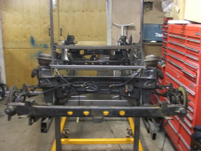

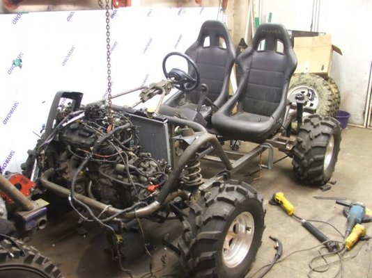

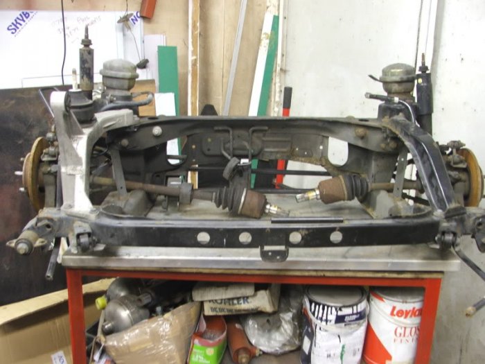

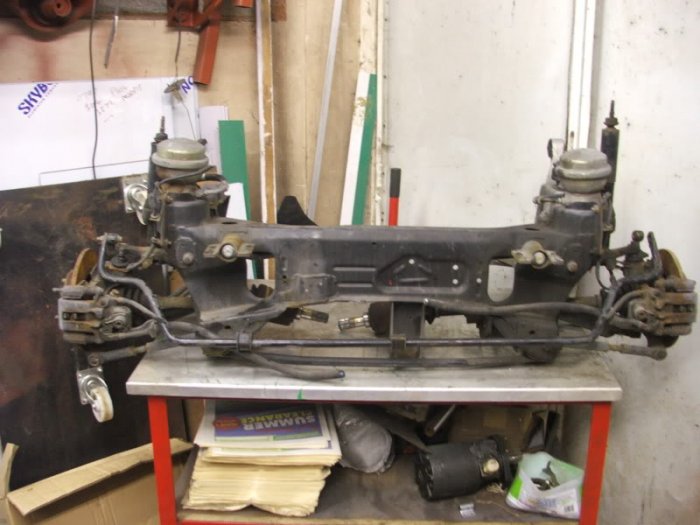

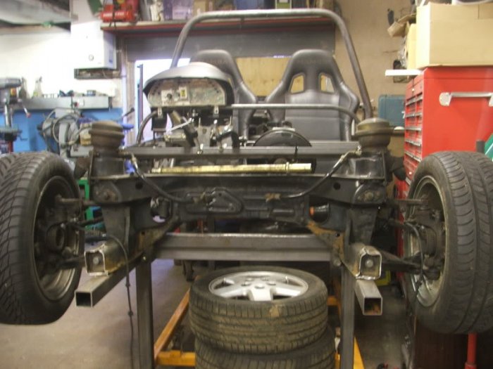

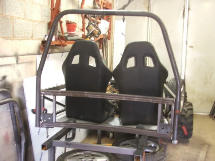

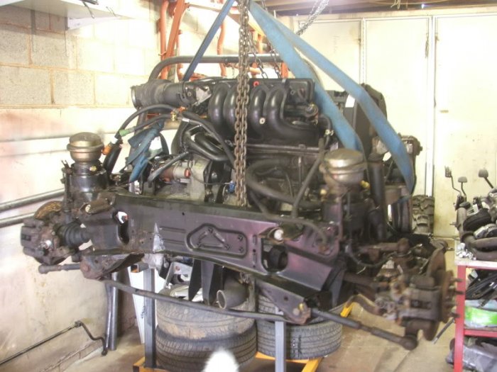

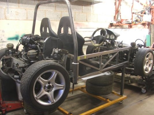

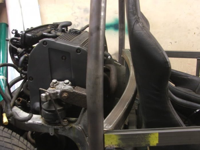

    Right a bit of catch up to where l am now,

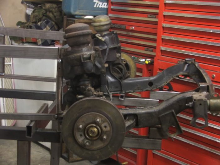

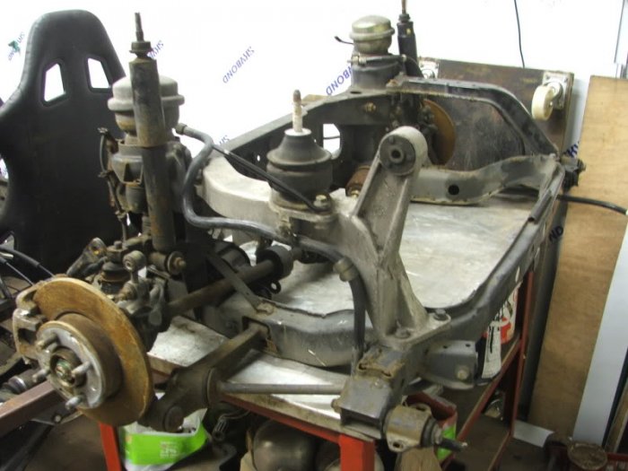

    heres the mgf rear subframe l bought

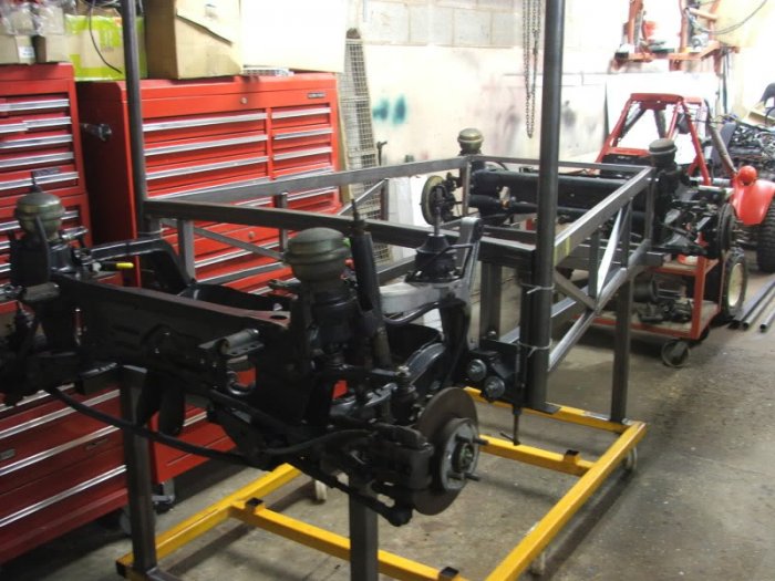

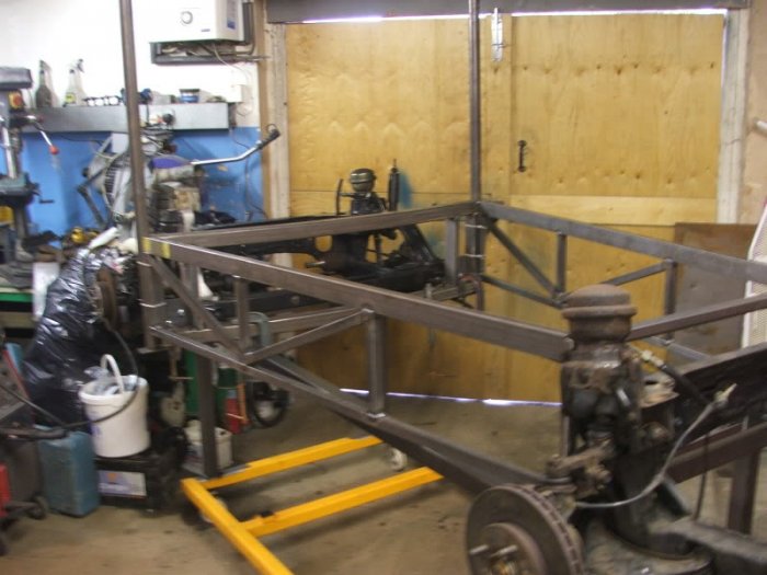

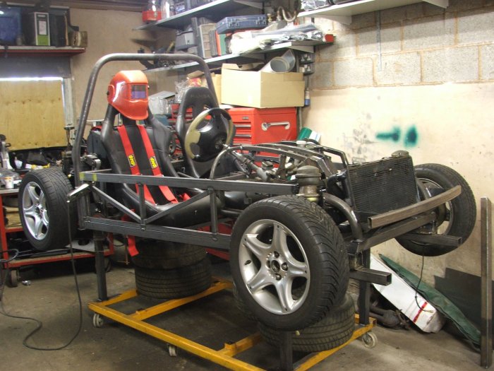

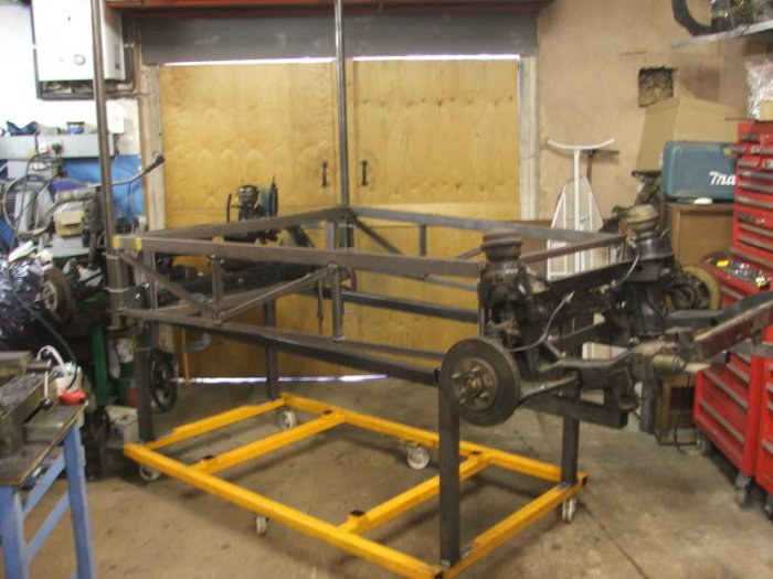

    the plan was to build a bench on wheels drop the rear subframe on the back and the front subframe on the front set them the right distance apart which in this case would be to give a 88" wheelbase, and then build my chassis to fit in between them and join them together, sounds nice and easy huh?

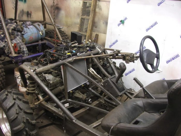

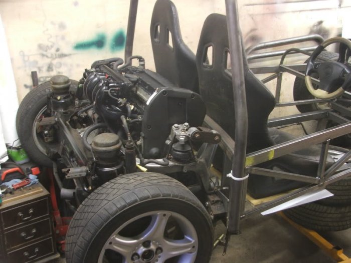

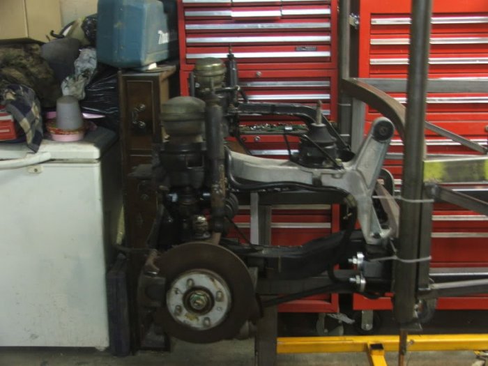

    on the front subframe l have cut the section off that is in front of the bottom front wishbone mounting as l see no point in having anything stuck out in front of the wheels ?

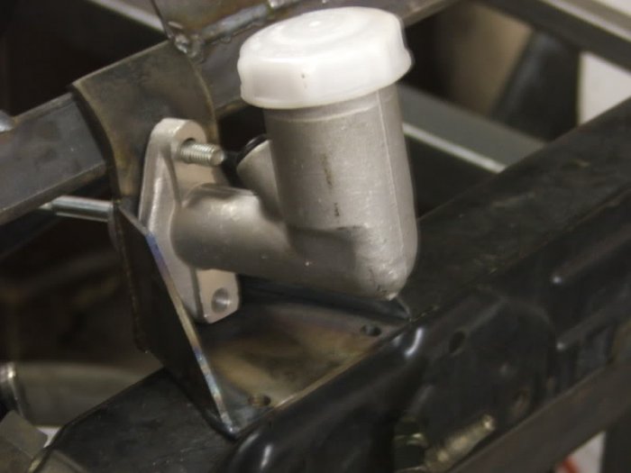

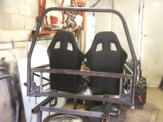

    l have used the mgf electric power steering column although they also did a manual version as l want to fit a steering quickener to reduce the steering wheel turns down to around 1.5 turns lock to lock and as this will double the effort required to turn the wheel l thought the power steering would help
    decide not to use the brake servo for 2 reasons, 1 l couldent easily fit it in without have a bulge on the bonnet and 2 as this is for use on grass or mud not tarmac l dident want sharp brakes that lock up all the time and slide, l thought l might get more feel without the servo but time will tell if thats a mistake or not :laughing:
