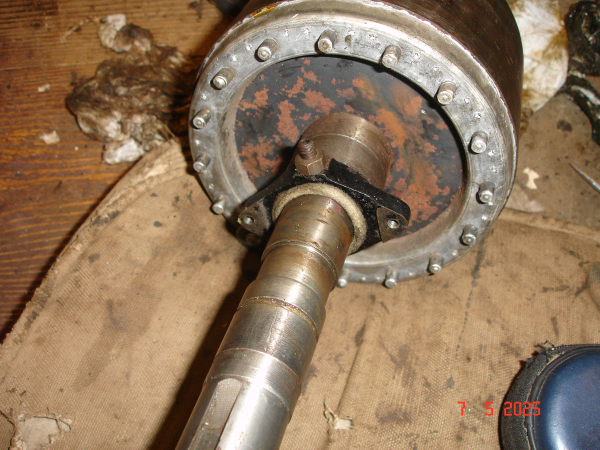

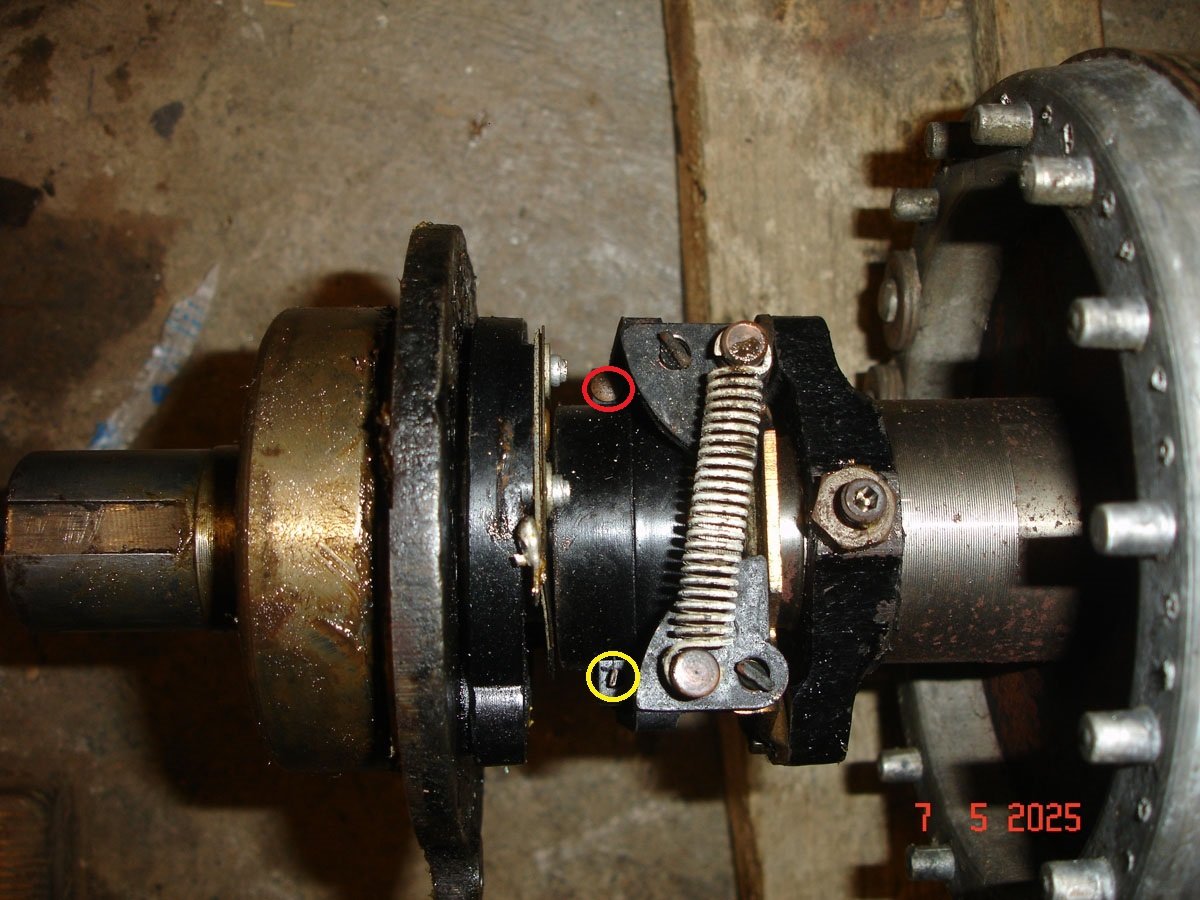

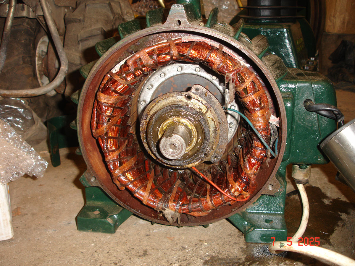

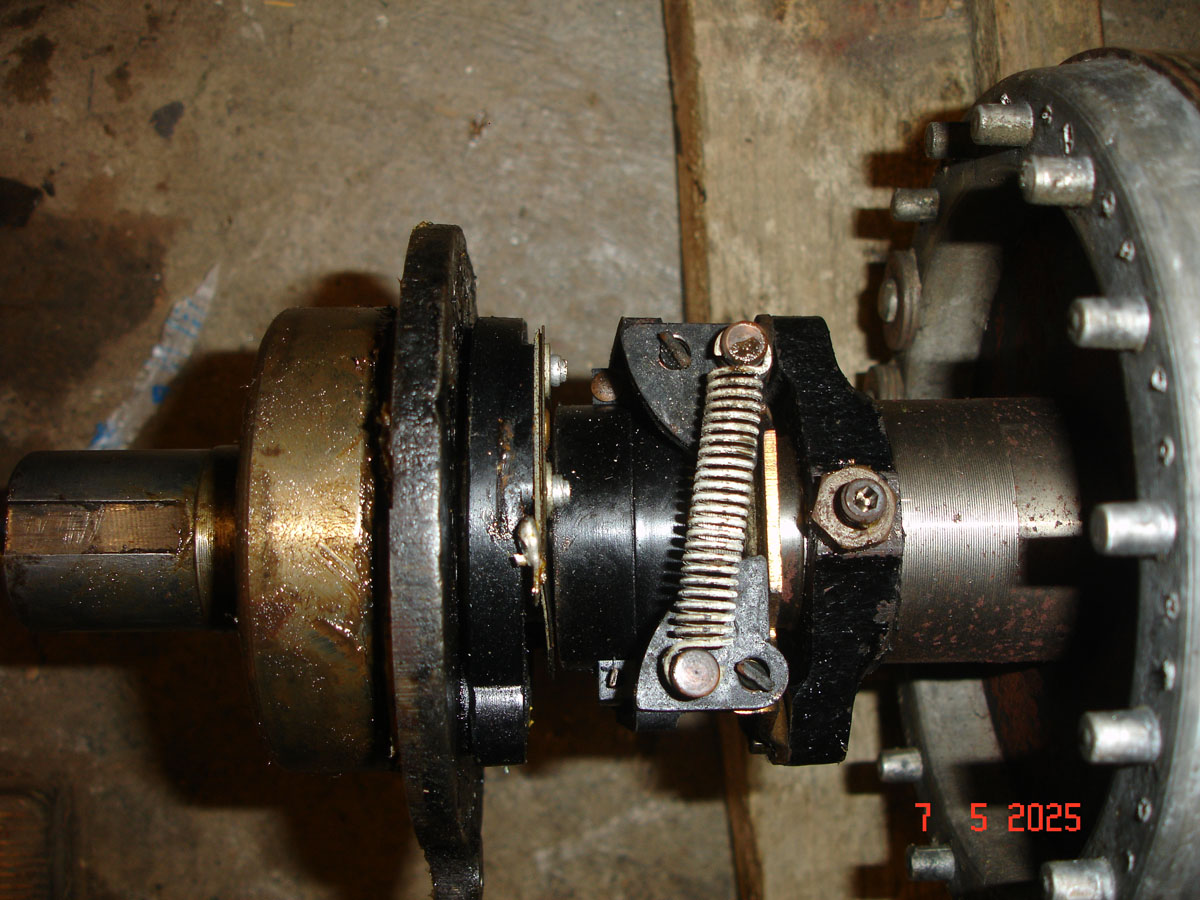

Righrt, I had given up and reassembled the motor as was relieved that it ran okay but, the bearing was rumbling away and was on my mind. So, I decided to have another go at splittig it again: after getting the flu first. This time, as mentioned on here, I started at the other end. It took me nearly two days to remove the end bell from the other end but, it eventually came off. I am now seeing this:
I tried removing the rotor but those two wires ( red and blue ) are holding it in, are those the two wires you were on about Brad, this centrifugal clutch? I take it I have to now go into the junction box, on the side of the case, and disconnect them and pull them through in order to release the armature? I do not see how I could ever get them back in the box though as there is no room between the inner of the case and the stator windings.. Maybe they can be unsoldered at the clutch end I couldn't believe that there was a spider living in there and a house he had built, on the actual windings, I saw him pack up and leave when I pulled the end off.
