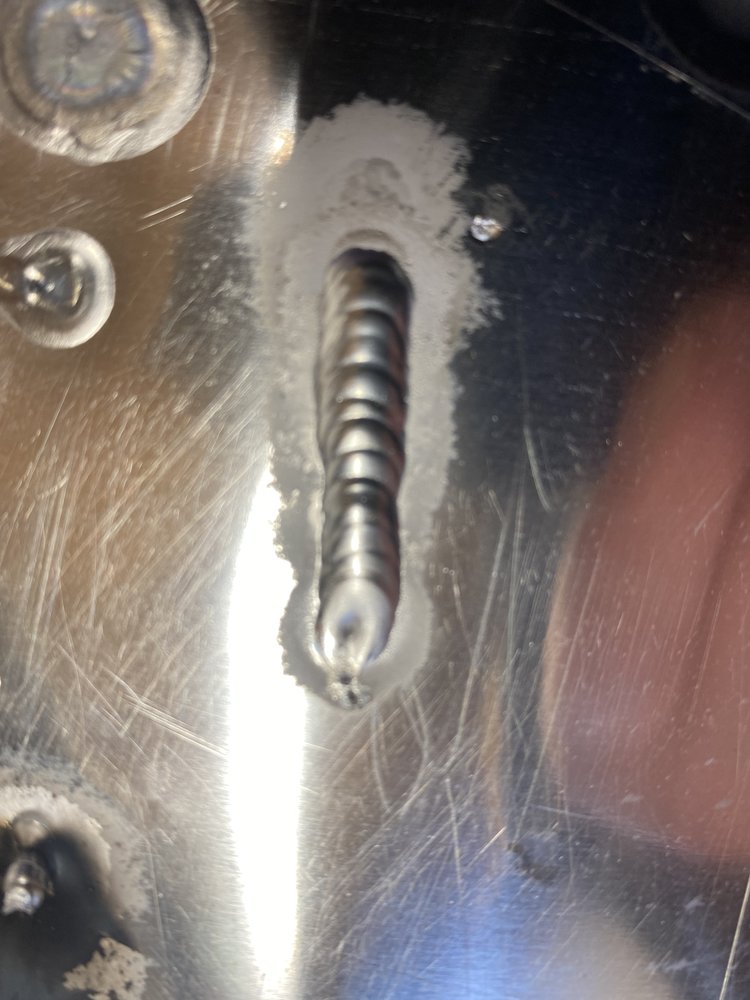

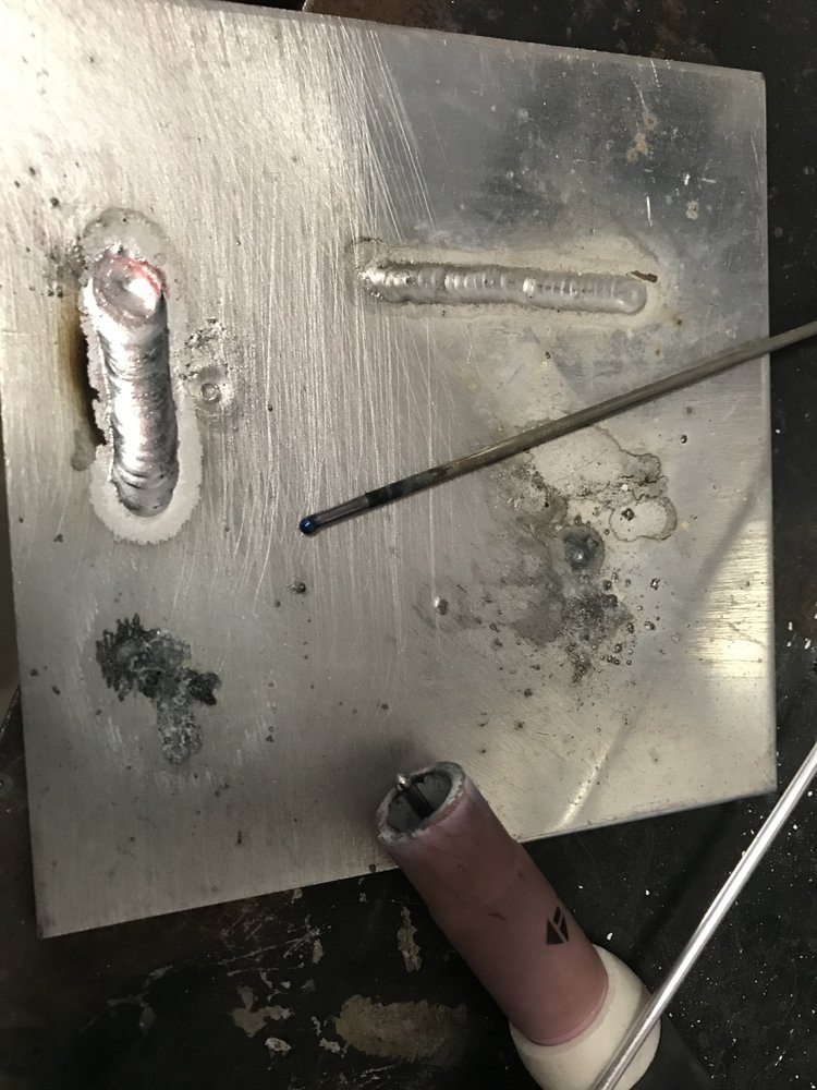

Just had a play with mine, white 2.4 tungstens, one laid down tried with no gas burnt back to blueish colour, new tungsten in torch turned gas to 8lpm and ran a bead ..ish. Under bead is bit i tried with no gasView attachment 282175
Stupoty, yes bud I’ve tried various pieces of aluminium thinking the same thing as you that it was poor quality or unweldable material but unfortunately still exactly the same
