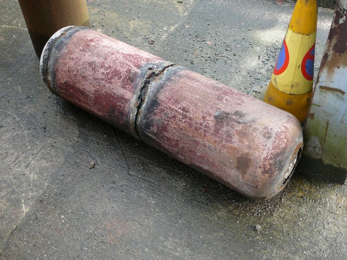

My local BOC branch used to have an acetylene cylinder outside the door that had split top to bottom and opened up. It had some kind of honeycomb structure inside it.
Did they use O/A to section it?
I think they use/used Kieselguhr, a white clay.Back in the 70s it was acetone and charcoal. Don't know if that has changed in the passing years.
So the solvent allows it to be 200psi in the bottle then?
How does the gas drawn off into the regulator at 200psi, not go bang, if it decomposes above 28psi?
No it had blown up. They put it there as a warning
