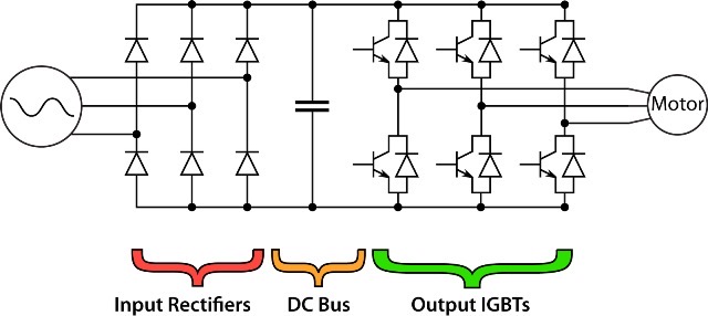

Two main ways:Any of them. How do you get 2 non existent phases from fresh air? This is electronics and my HND was 40 years ago. Trying to decipher it all.

The traditional "rotary" converter is basically just a Static Converter with a Pilot Motor (which smooths things out & means you don't have a minimum motor load & the need to switch settings for different motor sizes ike you do with a base Static).OK, I spent a couple of hours reading last night and I think it’s getting clearer, but the issue is I have no clue how these converters work. I have a solid understanding of how electro-magnetism works (always did) but I can’t see where the converter “makes” the extra phases from.
I keep thinking back to my physics lecturer endlessly repeating how you can’t get something from nothing! So I think I’ve identified the missing knowledge, ie, how these converters work. Cos they clearly do work.
I like faffing with motors. Plug and play is boring.The other point is that 3-phase kit is generally quite cheap, so the additional cost of a vfd gives you a solid, capable machine. If you have to faff with the motor, so what? Isn't that what we're all about?![]()
