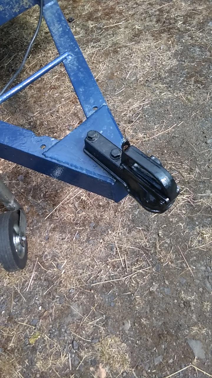

I may have misunderstood about the hitch, do you mean an anti snake/stabiliser hitch?
If so in my opinion there should no need for one if you build in plenty of nose weight and think about how you load stuff inside.
Most snaking is caused by bad load positioning, making the trailer tail heavy and almost certain to snake.
