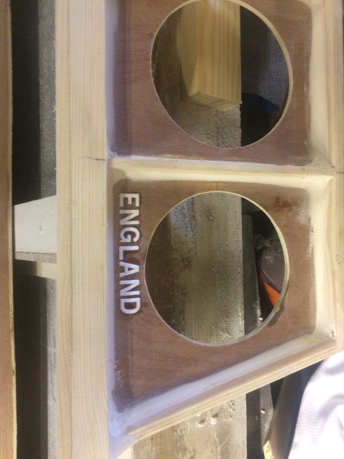

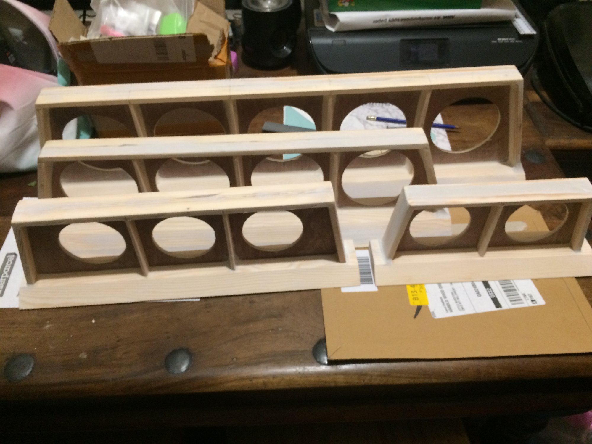

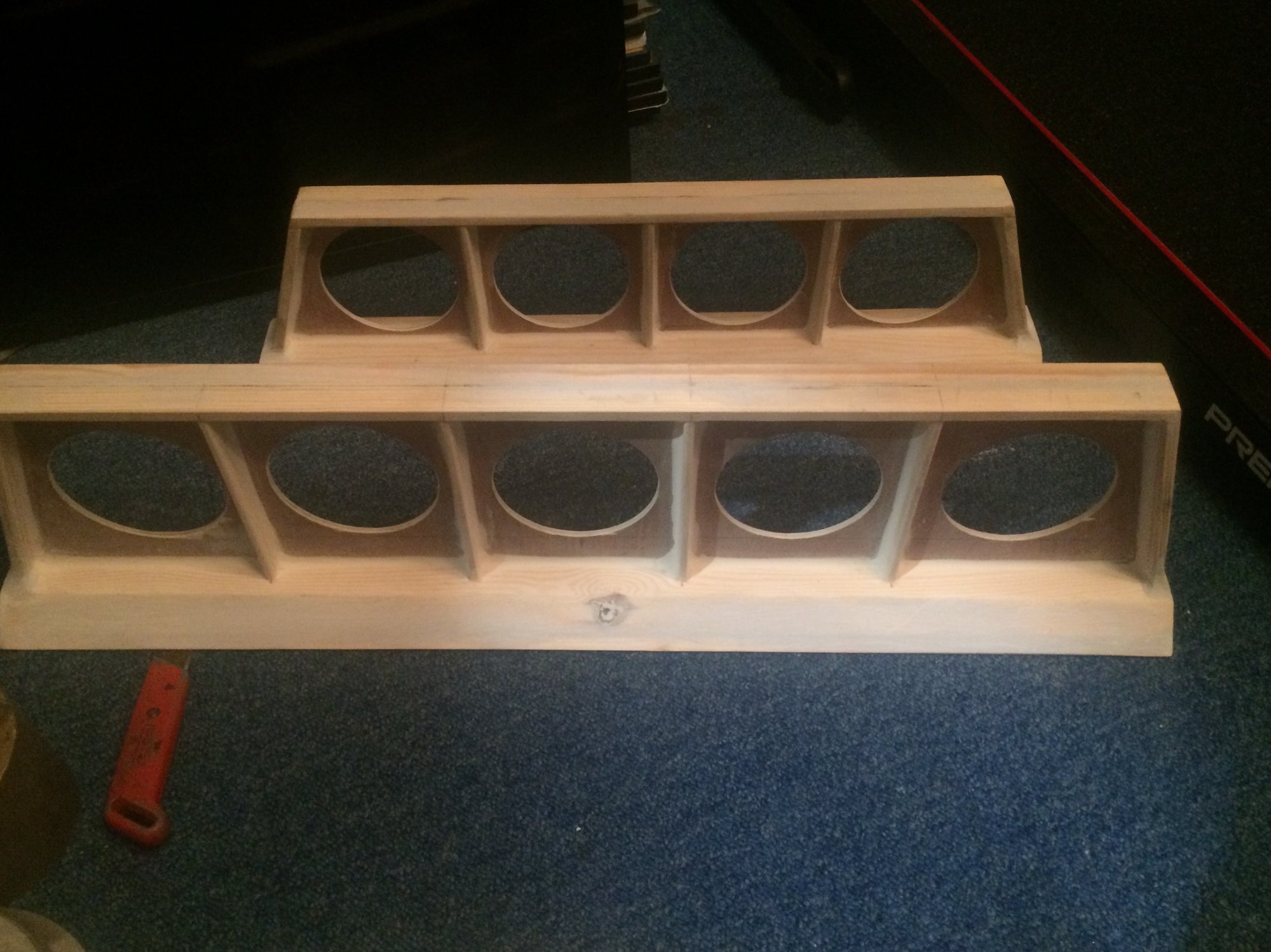

24” and 30” patterns finished and ready to go to foundry where they will apply pattern varnish.

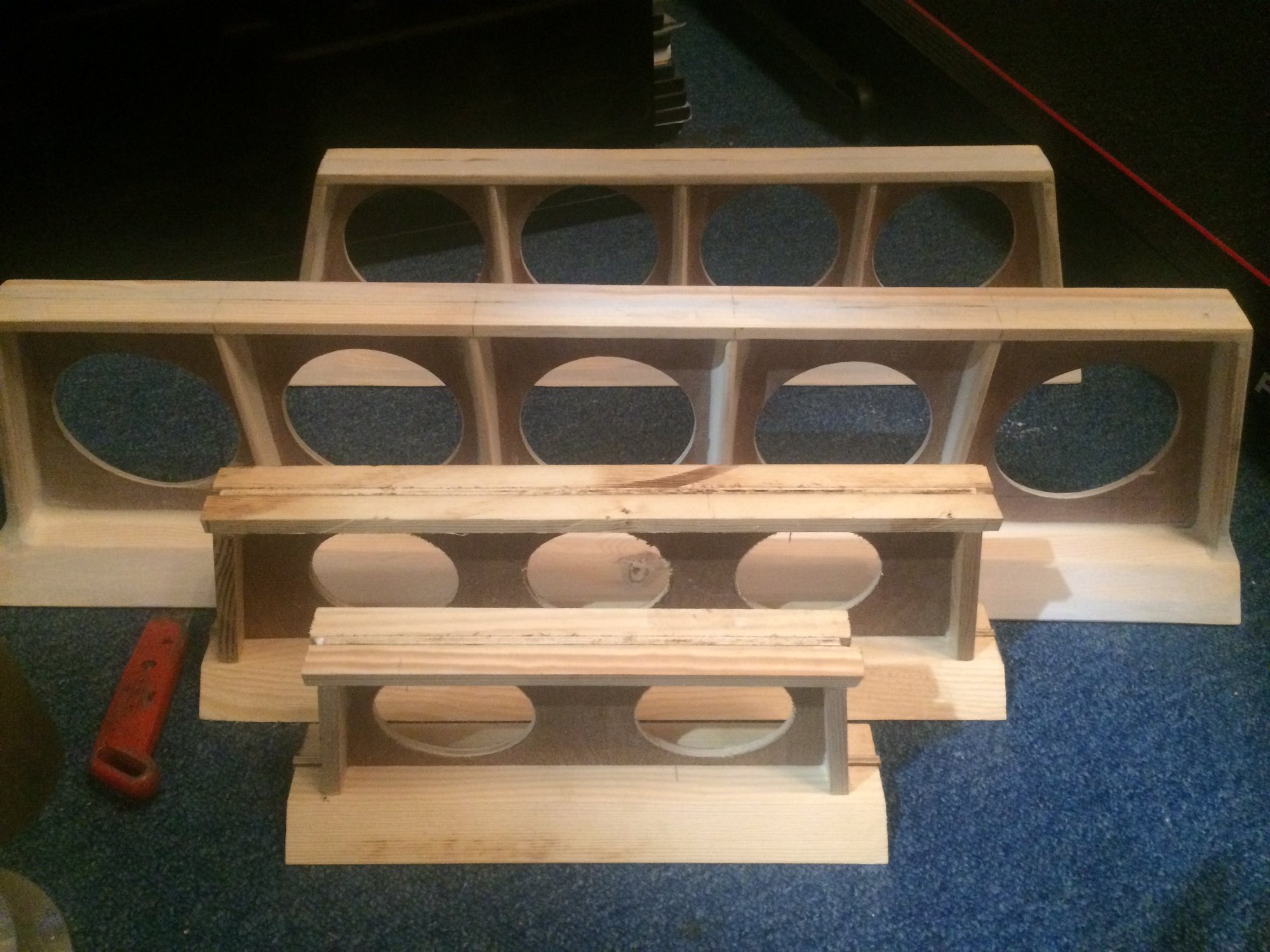

Made start on 12”&18”

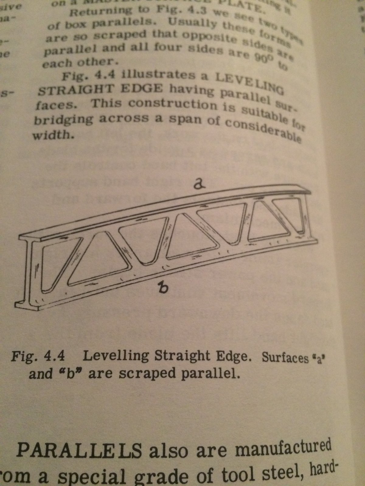

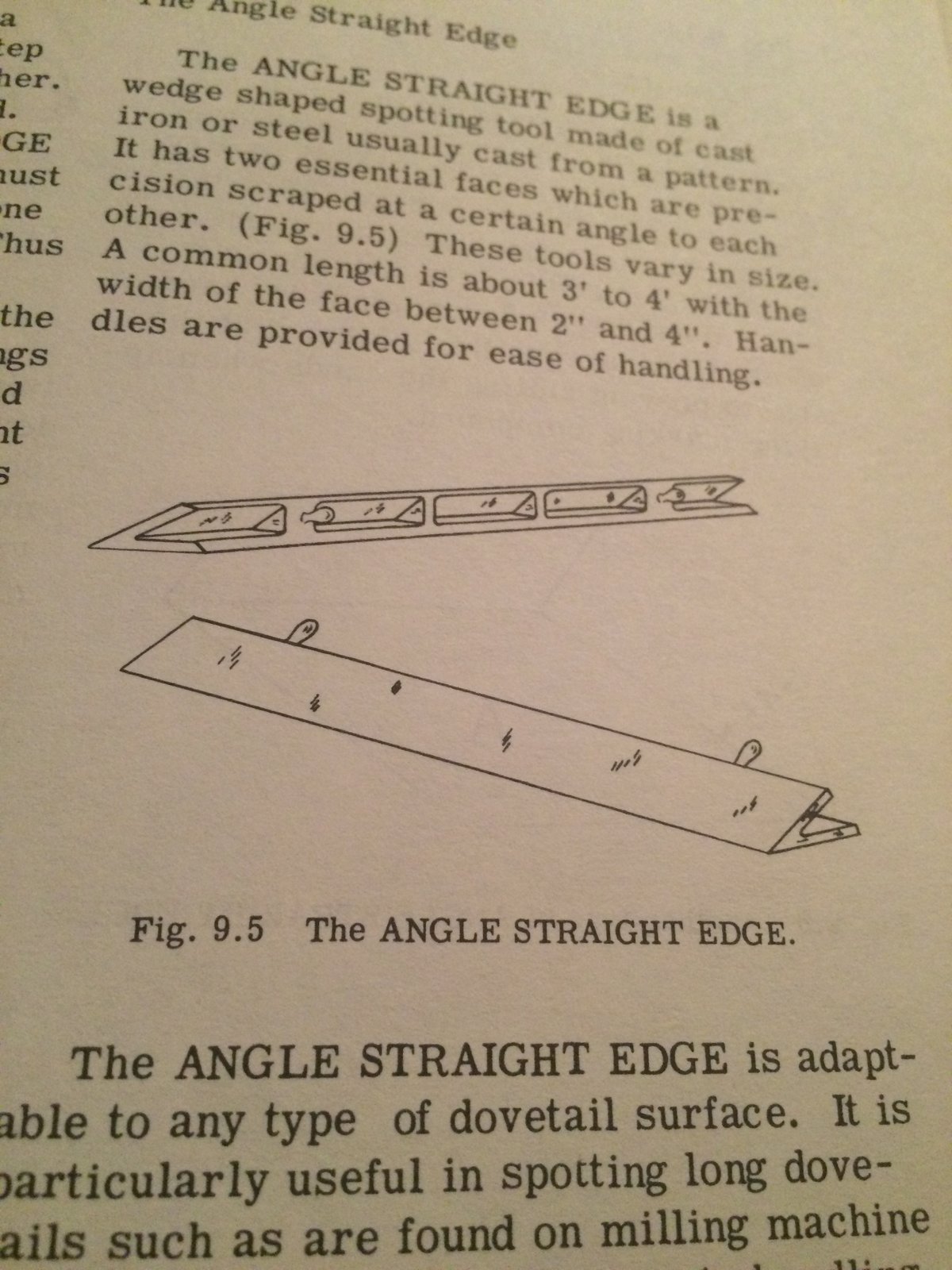

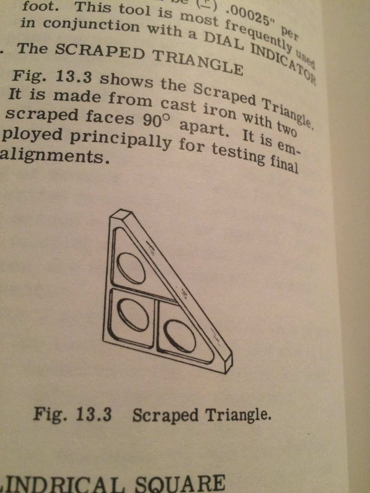

Been looking through my book by Connolly on machine rebuilding looking for inspiration for more fancy bits none if us had

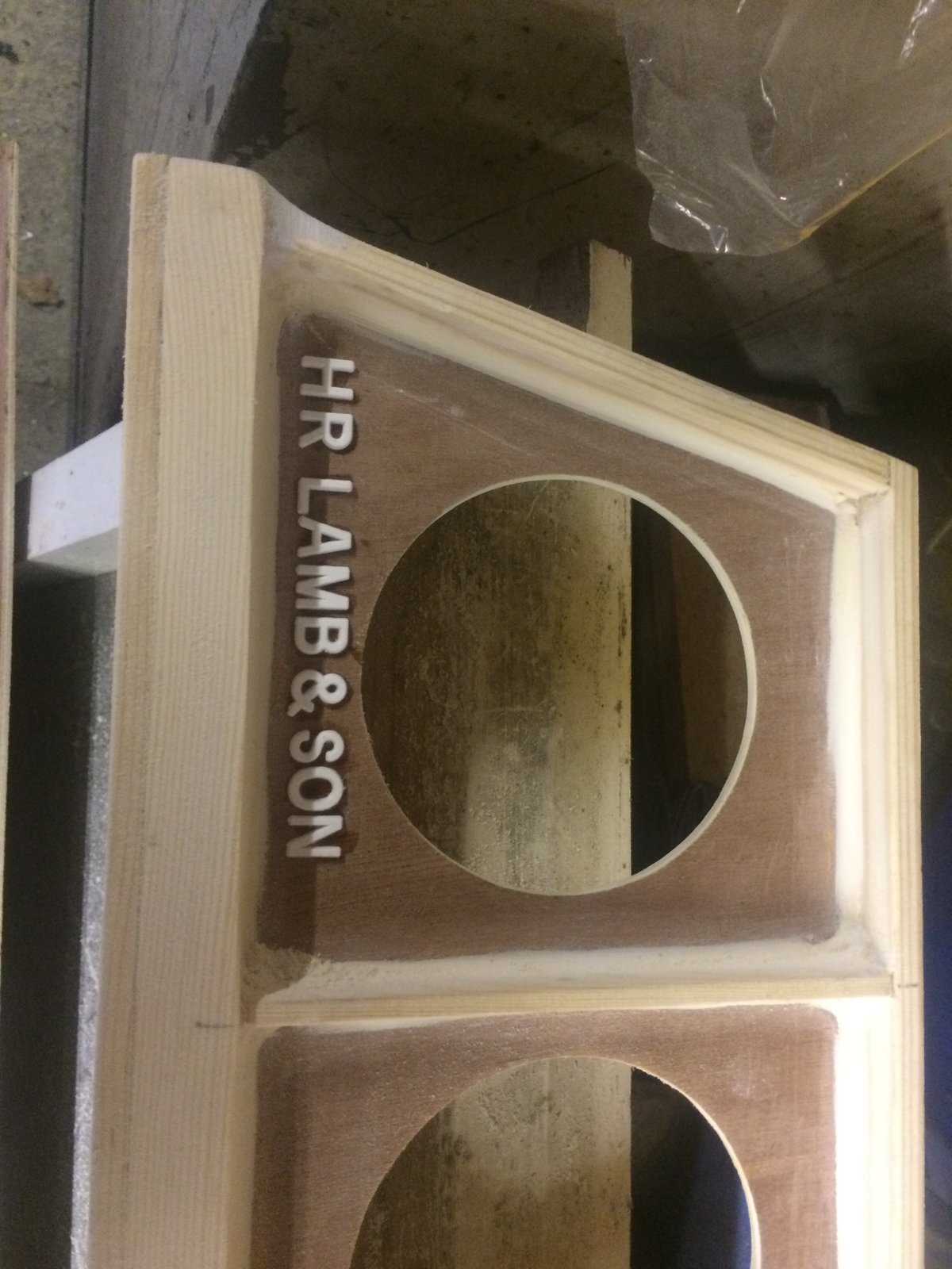

Do I get crazy horse signature on mine24” and 30” patterns finished and ready to go to foundry where they will apply pattern varnish.
Yes ‘nutty’ is cast into your oneDo I get crazy horse signature on mine
Iron man.Your great great great Grandfather Spencer .

Ready for the foundry getting into this wood butchery

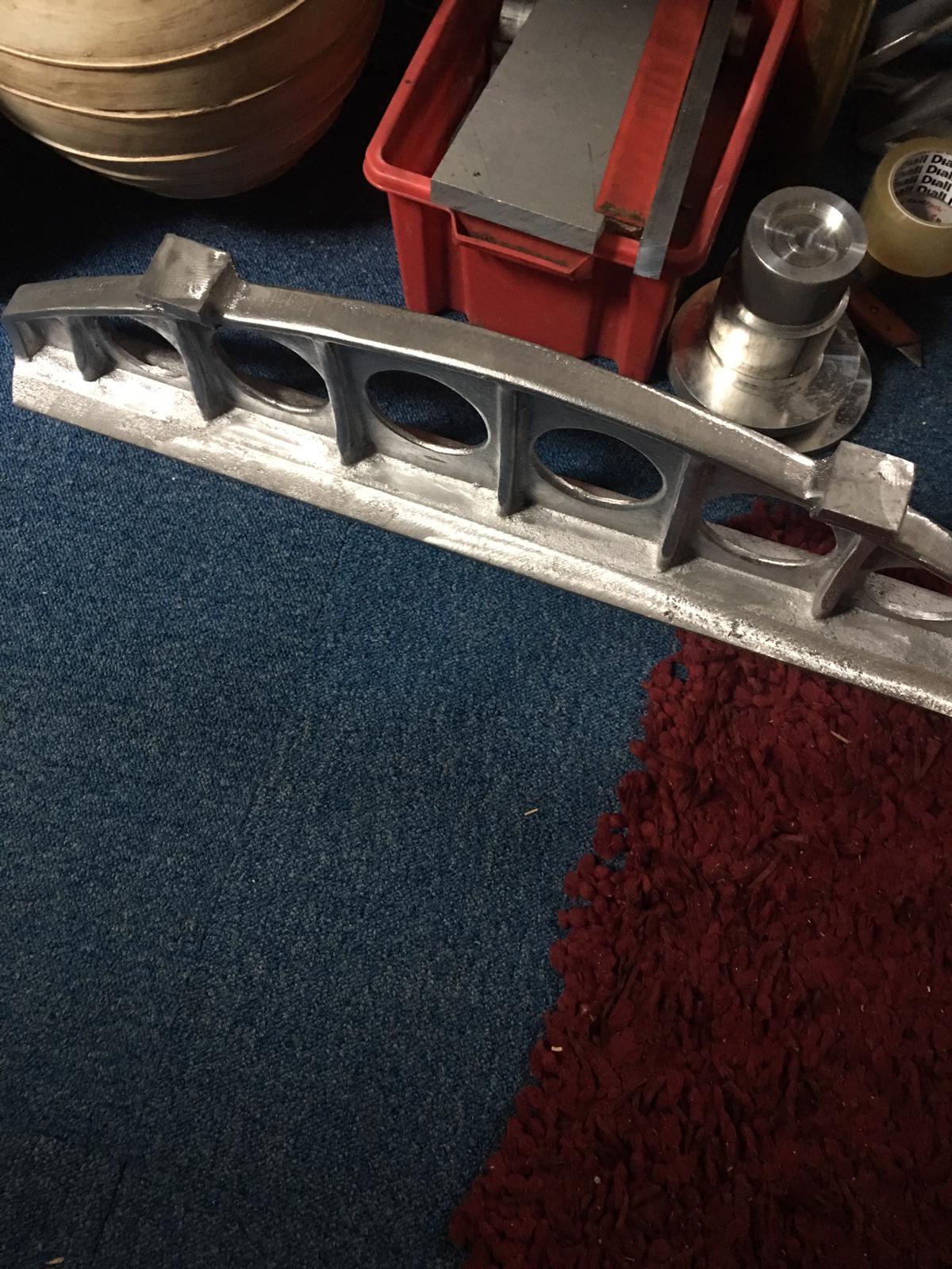

Foundry master came to see me today.
This is a new foundry with quite a reputation, they cast the engines for the auto union recreations amongst other famous stuff.
Was talking of my plan to make a bench vice slightly bigger than the record 18 1/2
I thought he'd look at me like a loony but he informed me that he does already cast vices.
He does the castings for the buggati vice which is stupid money!
has to be the right grade of cast iron. Ordinary grey cast no funAt least it will be cast from the right grade. I cant imagine a cast iron vice lasting long with a BFH. Or will it it be a door stop

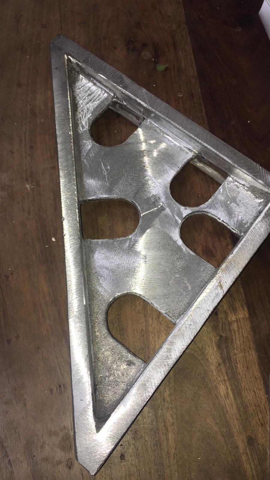

OkCan I put a request in for a couple of those squares and a bronze camel back please..
