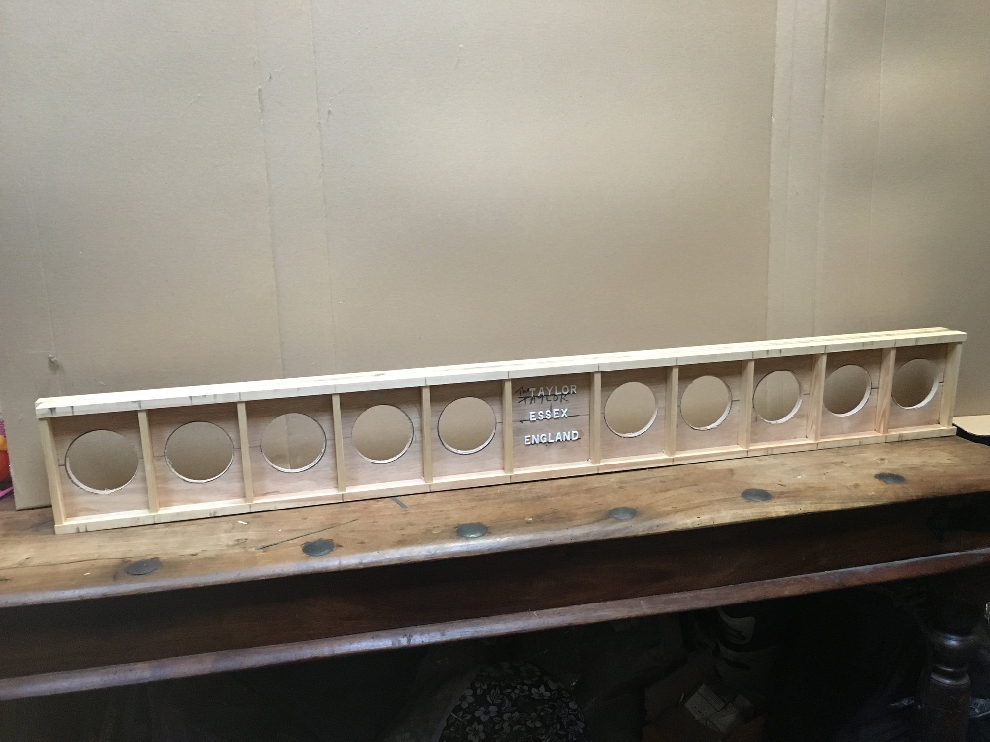

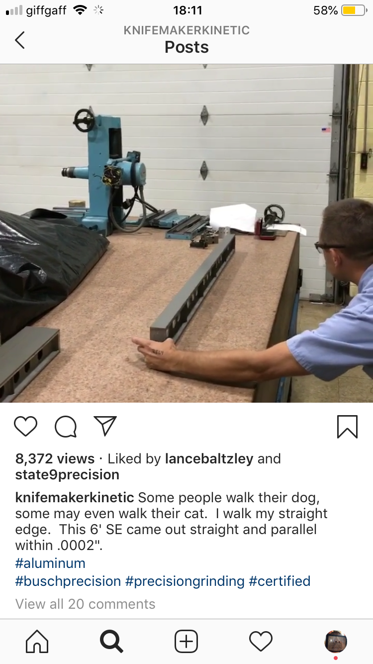

50” parallel under wayView attachment 254257
Because it’s a very strong structure and cast iron doesn’t like to flex.Wow. How do you ensure it doesn't flex, or bow if not supported enough.
I doubt it will flex significantly more than a fish back, it's an "I" beam, probably heavier than a fish back. I have a 72inch one this shape that I checked on the diagonal of my 36"x36" surface plate, over 49" or 1.25m the sag was less than1/100mm, under 4/10 of a thou. for scraping a lathe bed, that's acceptable for me! By the way, my 72" straight edge weighs 40kgs!Wow. How do you ensure it doesn't flex, or bow if not supported enough.
Bearing in mind that’s machined not scraped!That’s not bad for cast aluminium 8 tenths over that length
That is impressive.Bearing in mind that’s machined not scraped!
There shouldn’t be sag as I’m guessing 49” support points should have been very close to the airy points.I doubt it will flex significantly more than a fish back, it's an "I" beam, probably heavier than a fish back. I have a 72inch one this shape that I checked on the diagonal of my 36"x36" surface plate, over 49" or 1.25m the sag was less than1/100mm, under 4/10 of a thou. for scraping a lathe bed, that's acceptable for me! By the way, my 72" straight edge weighs 40kgs!
40kg isn’t too bad my windley bros 72” fishback has got to be 70kg plus!

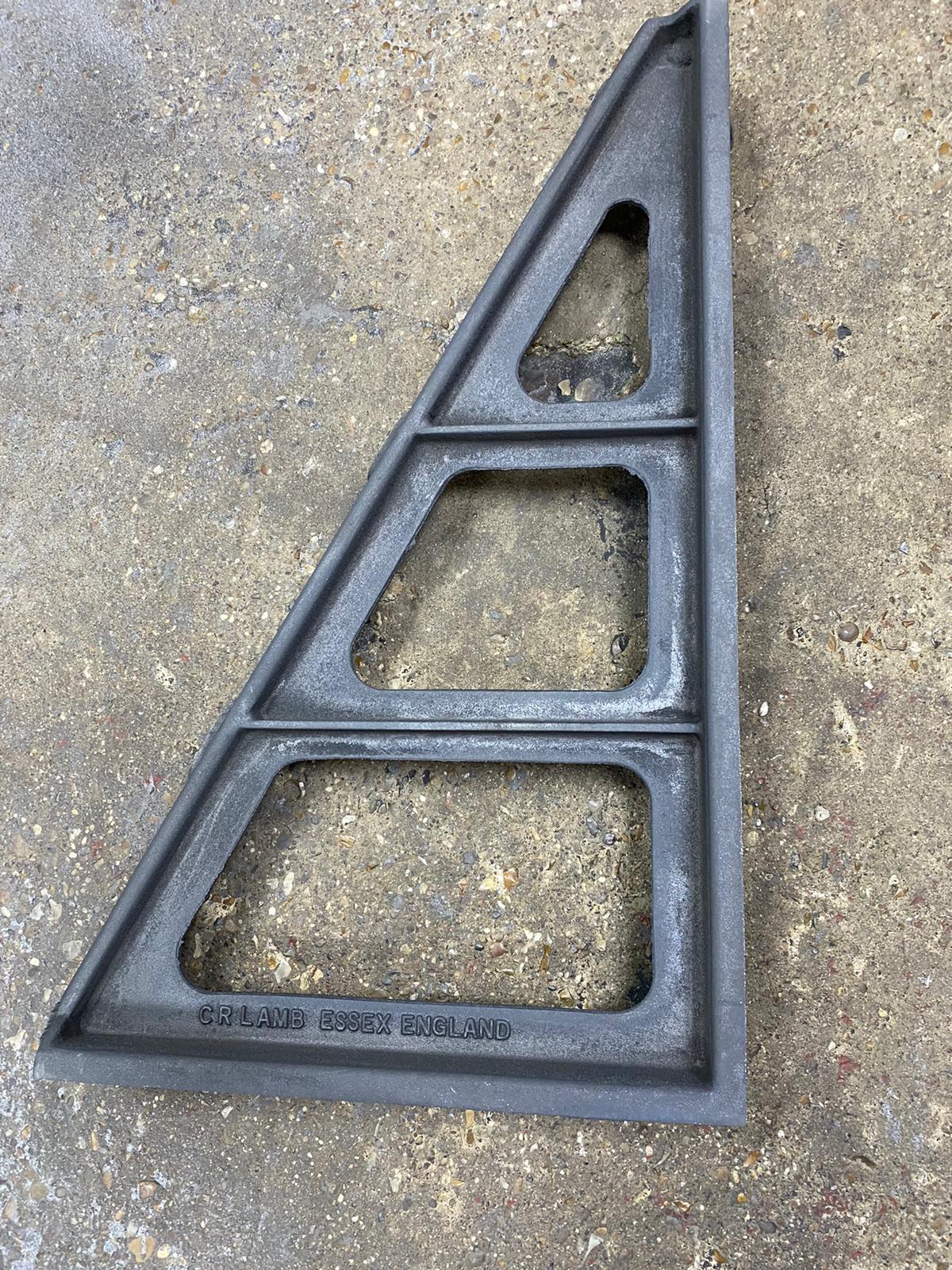

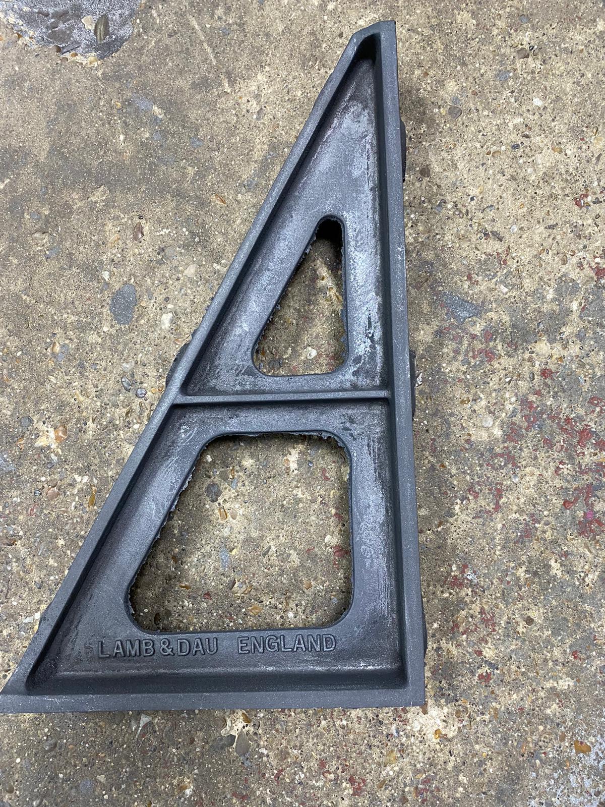

What size are they ?
12/18” and 18/24What size are they ?
