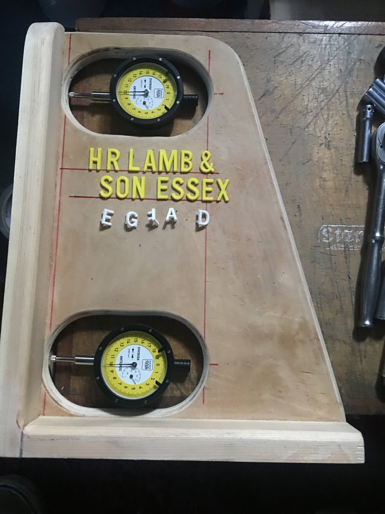

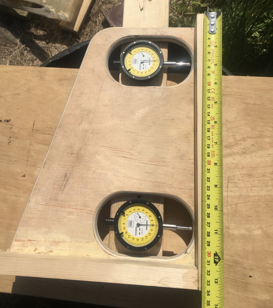

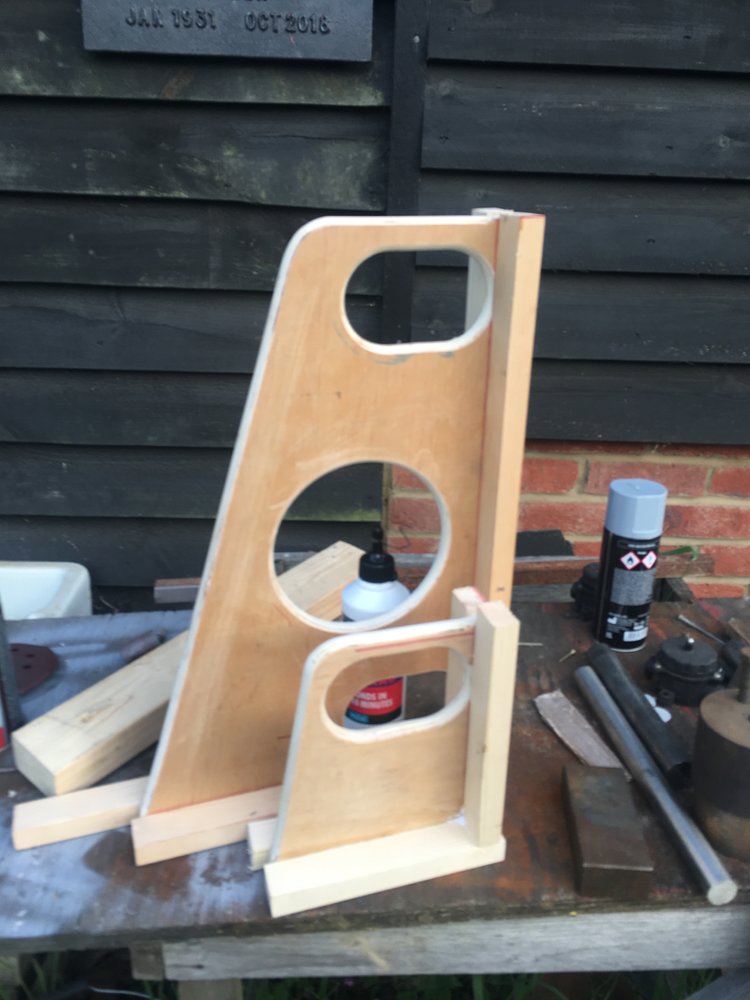

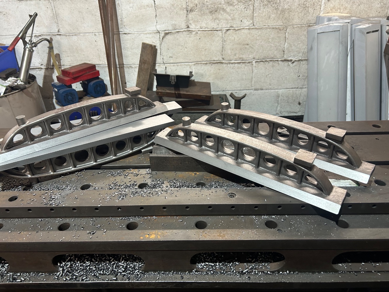

@pressbrake1 Have you considered doing some 8" squares ?? I'd certainly see a use for one and fits in scale with some samller shed/garage shops !
I hear that a lot but I’m sure they’ve read the situation wrong!Are these for sale Clive ? Asking for a friend who has a wife that really wants a pair for Xmas

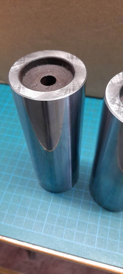

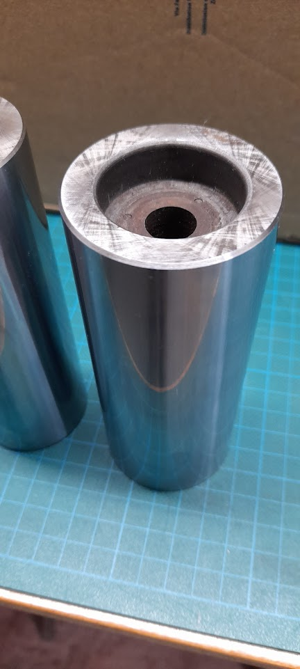

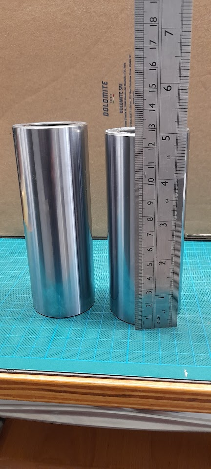

You do realise you will need to get some cylinder squares made now too...I’m outside in the garden making metrology patterns again

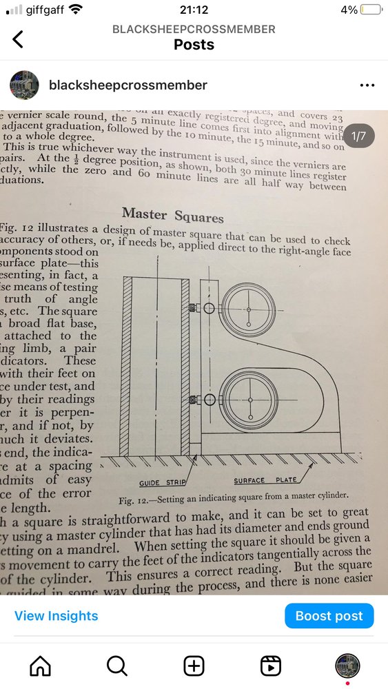

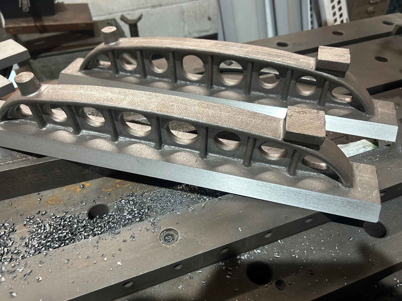

These are squareness comparators that you set off a master like a cylinder square then use to check work and actually give a value to work to.
I’ve set the top clock in on mine to give it some protection

Not with the price of toolsteel!You do realise you will need to get some cylinder squares made now too...
Just need two parallel faces that are roughly square.You do realise you will need to get some cylinder squares made now too...

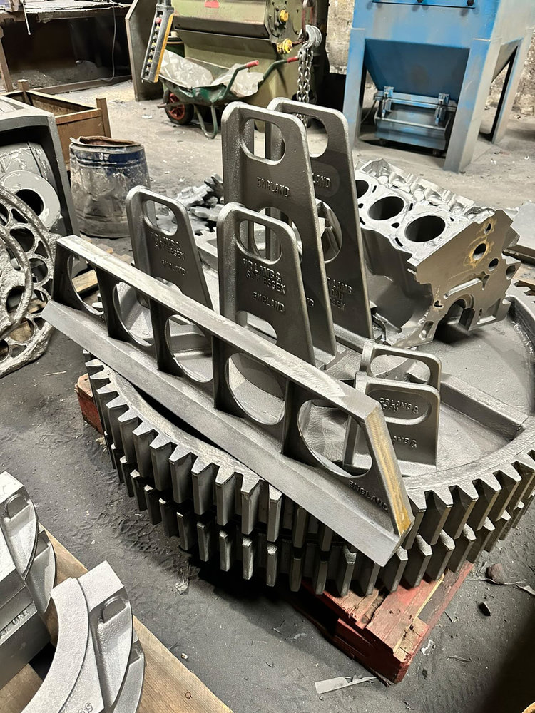

Did this come to fruition clive?I’m outside in the garden making metrology patterns again
View attachment 401321 View attachment 401322 View attachment 401323 View attachment 401324
I delivered patterns to foundry a very long time ago . Drives me nuts tbhDid this come to fruition clive?
