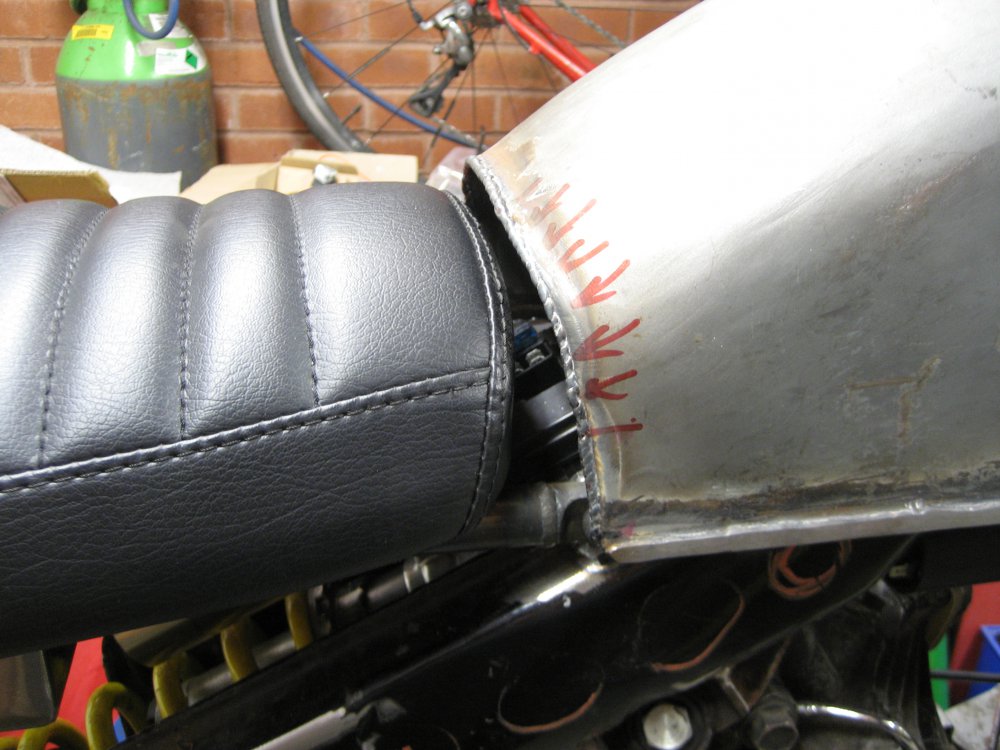

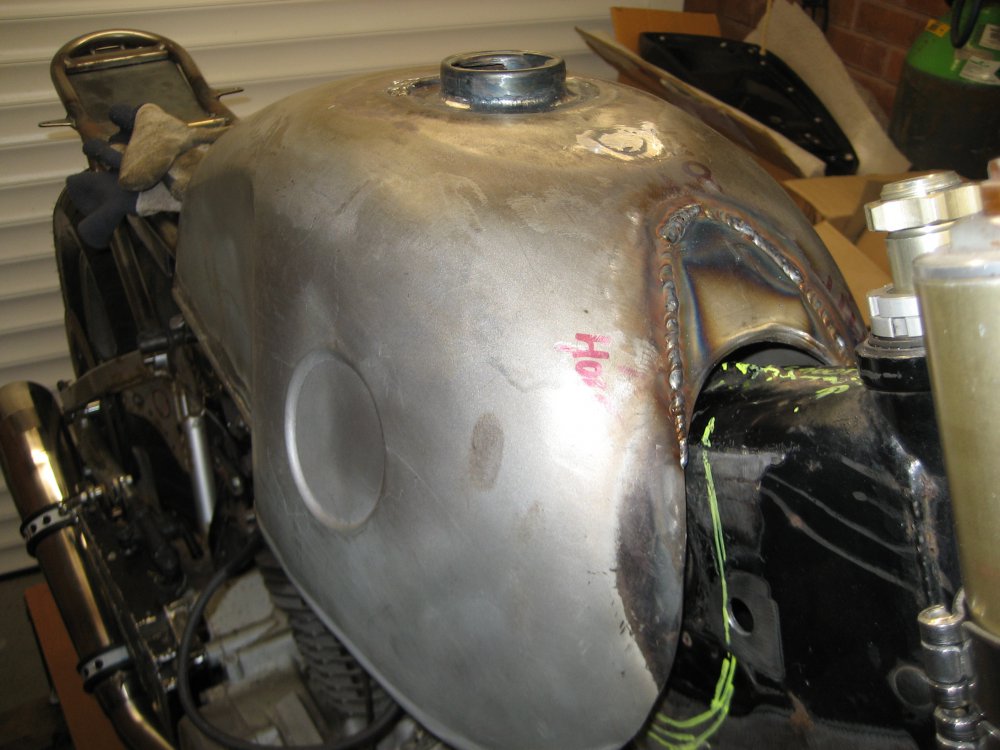

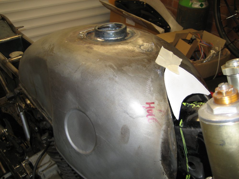

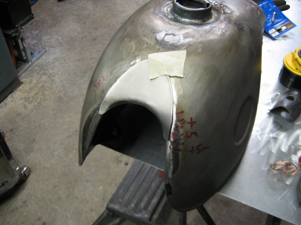

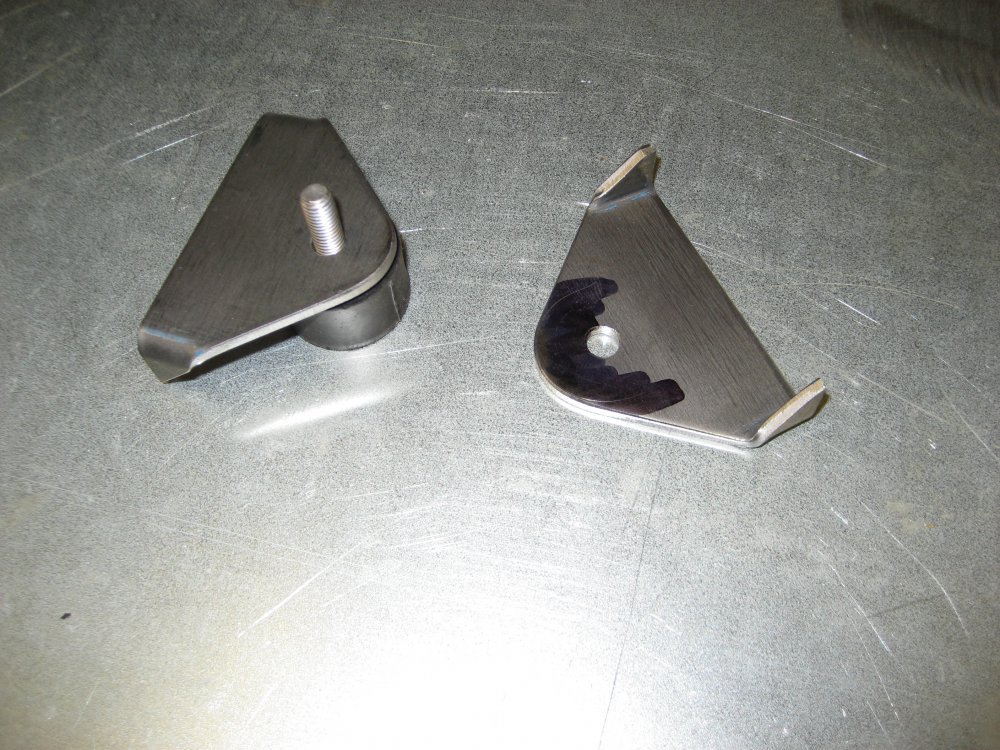

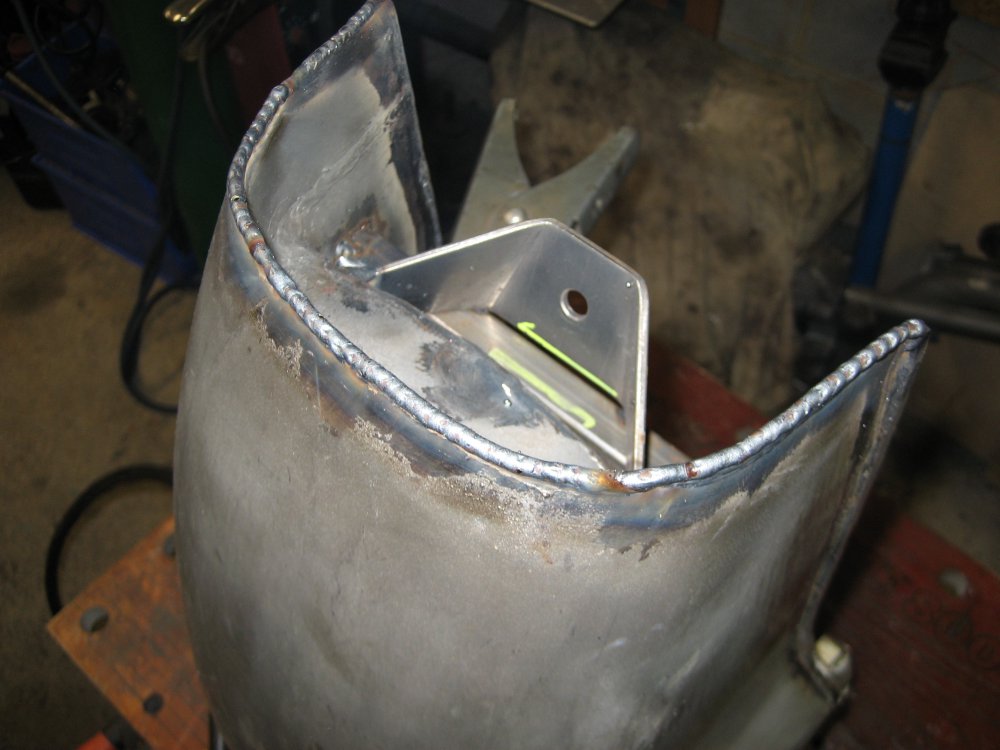

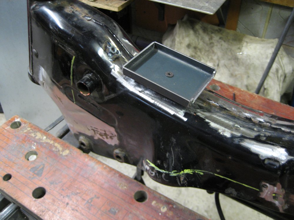

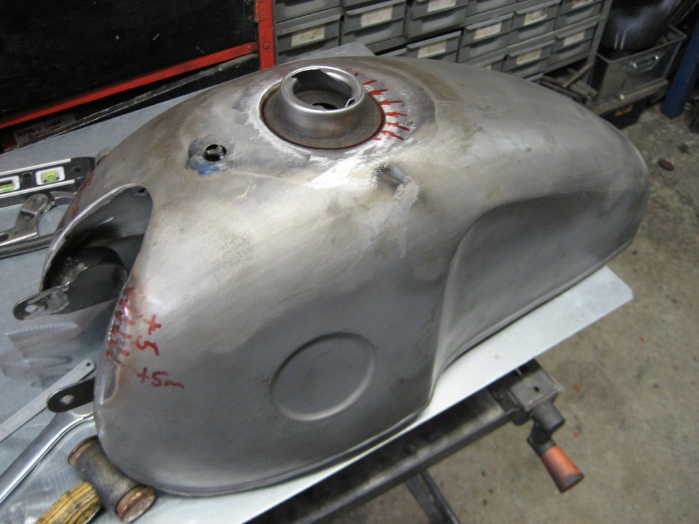

............its not very symetrical when you look at it from certain angles, so i set about filling in some of the errors with the mig. Bit more work required with grinding back but should come out ok?Placing the tags underneath would give you a cleaner look to the front of the tank.

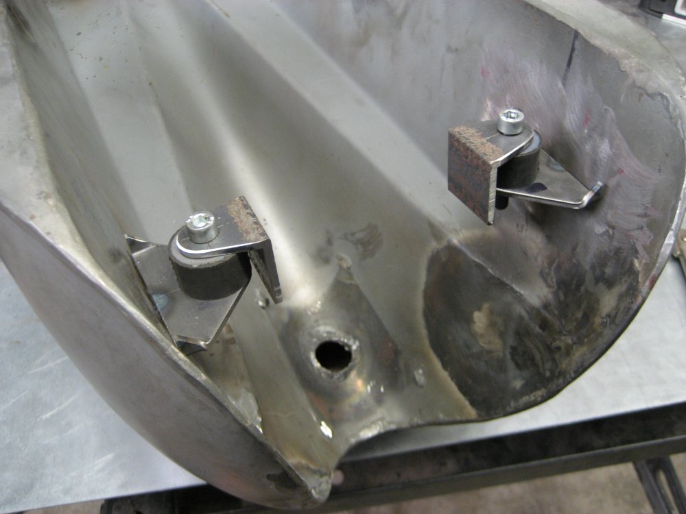

?A stud welded to the base of the tank and a bracket to receive it on the frame?
