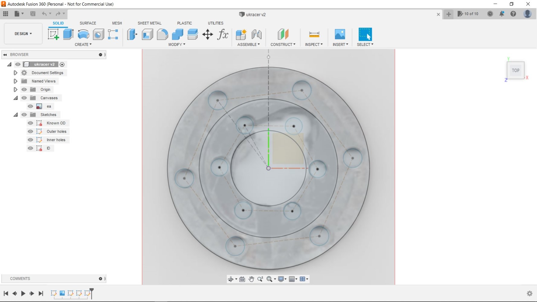

Here you go, I have (inadvisedly) released my drawing which will make things considerably easier. Here's what I used:

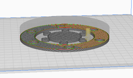

very useful mate.This version of the model will be easier to work with. The dimension version had a lot of solids taken out of it. It is a line drawing effectively. There is an stl . I have added a 1mm step because that's what the picture looks like but since the later picture shows a broken part suggests the whole ought to be closed in the centre, I wonder how useful any of this is.

Here's hoping for good news.I tried importing the PNG but the measuring tool (Inspect) does not see anything to measure.
What am I doing wrong??
Sorry my fault. I left a bulkhead inside the stl.very useful mate.
At least I can see what I am going to get if I drill the holes in the right place.
I have just got back home and tried printing the STL but the holes in the inner ring are free floating though.
I am now on my PC rather than phone and re read the comments. But as soon as I sat down on the PC my scan was still on screen and I can see what you mean about later pics show the center as a solid.
I acual fact I tried not to confuse everyone but by doing that I forgot to explain the 12 holes are in one solid piece of steel. (The center ripped out) so from the top view there are stepped holes 17mm wide and 11mm through hole set 8mm down.

forgive me if I seem ultra thick and I am tempted to clamp the old one over the new blank. BUT as I said to Hitch I love to learn, even if it does not last long in my head. But what exactly does the 100mm signify.
If I could get out to workshop I could trial and error check it. But baby sitting again.. LolYou could work from the centre... Set the dro to 0,0 on the centre, wind it out to -100,-100 and zero it again.
Then the above coords will work.
Or work from an edge.. setup finding the edge on x, Set the x dro to -half the diameter of the blank, same on the y. Wind out to -100,-100 and zero it off again to use the supplied coordinates.
