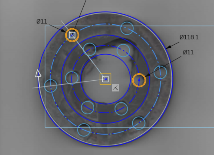

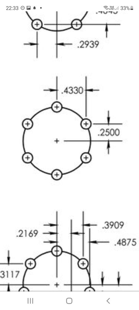

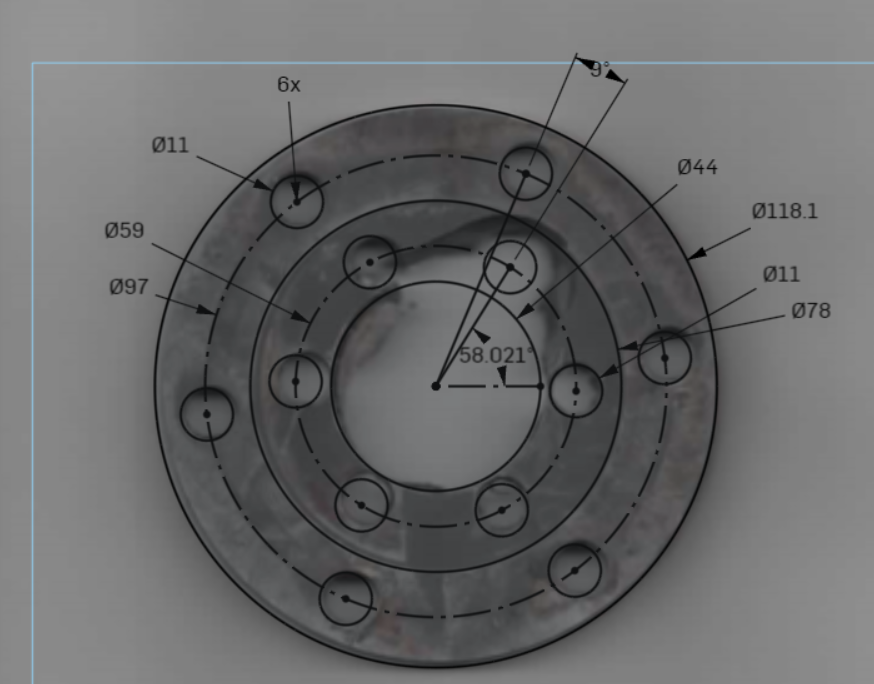

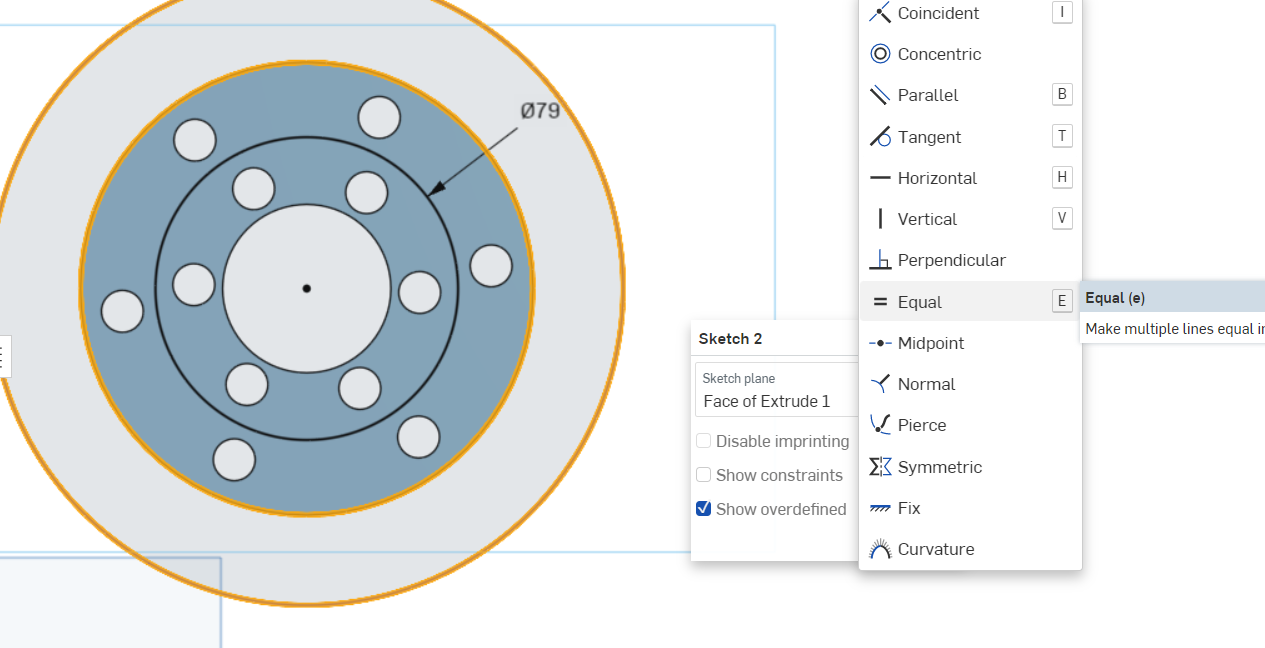

I could. It was one way of doing it.That's one way to do It... multiply the pcd by the .4330/.2500 to give coordinates, ie 100pcd would be x0/y-50
x44.3/y-25.5
x44.3/y25.5
And so on...

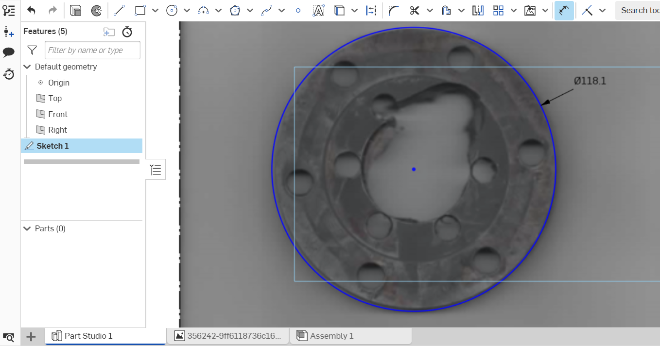

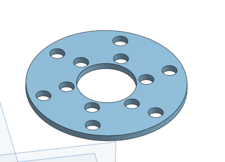

But as you've got it on cad now, you should be able to put all the hole coordinates in a table easily from whatever reference point you choose, hole or centre.
Just a suggestions... why not just clamp the old one on top of the new one and bore through... rotate one or two holes and reclamp to get the location of the damaged hole... no printing, no cad...no complications.

Thanks mate. I am grandkids free for a couple of days. But not near my mill so I will endeavour to get my head round the functions needed in my head.Would you like me to give you the XY coordinates?

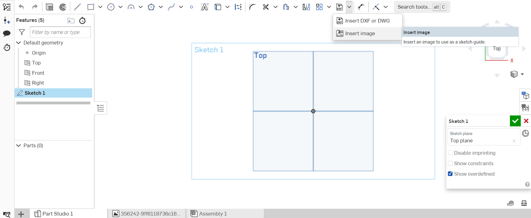

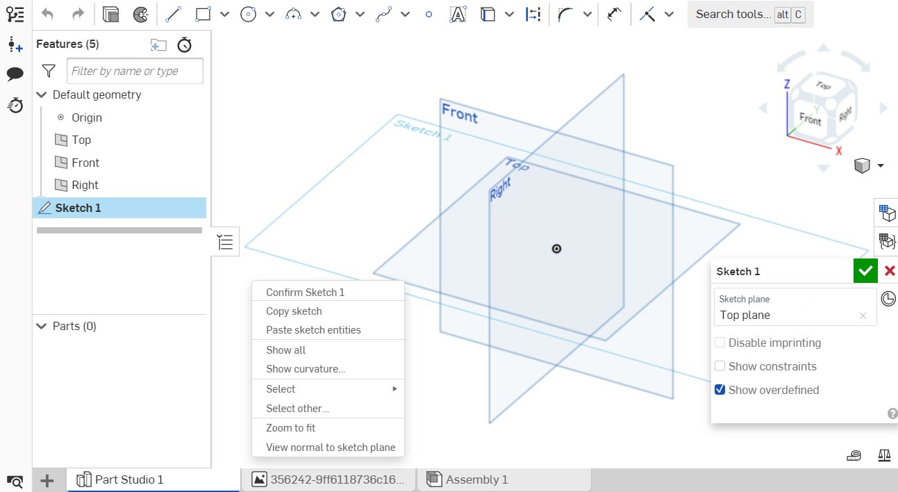

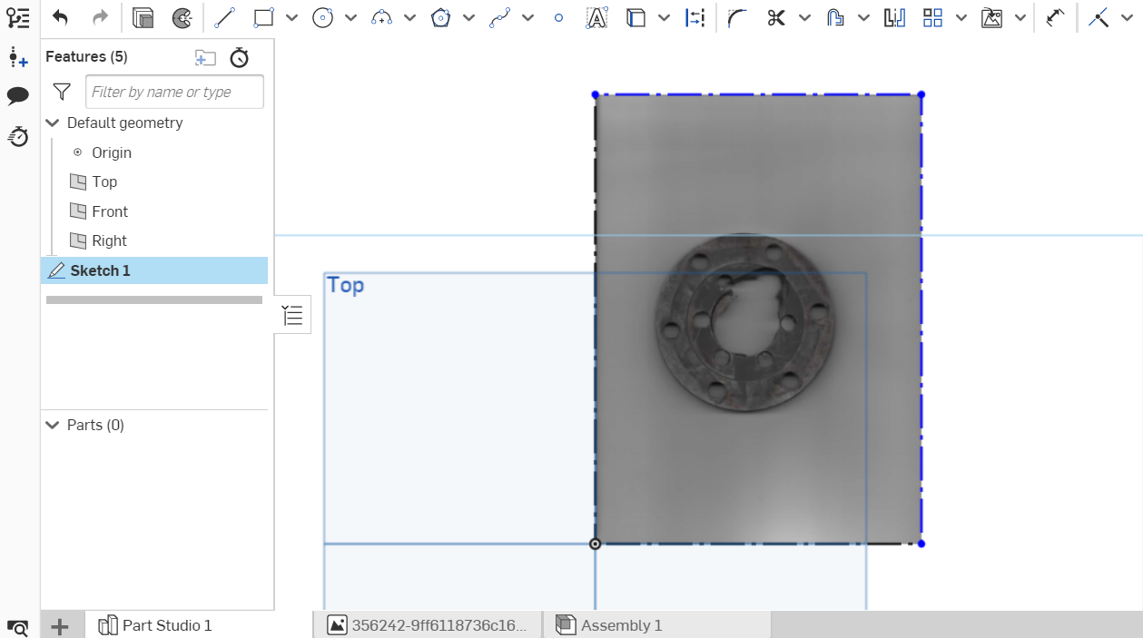

Is this available in sketch up. I have got a few hours today and would like to try messing about.?Like this?

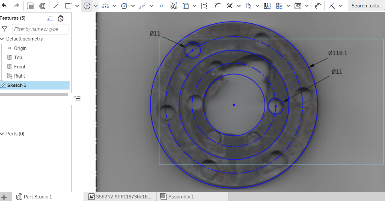

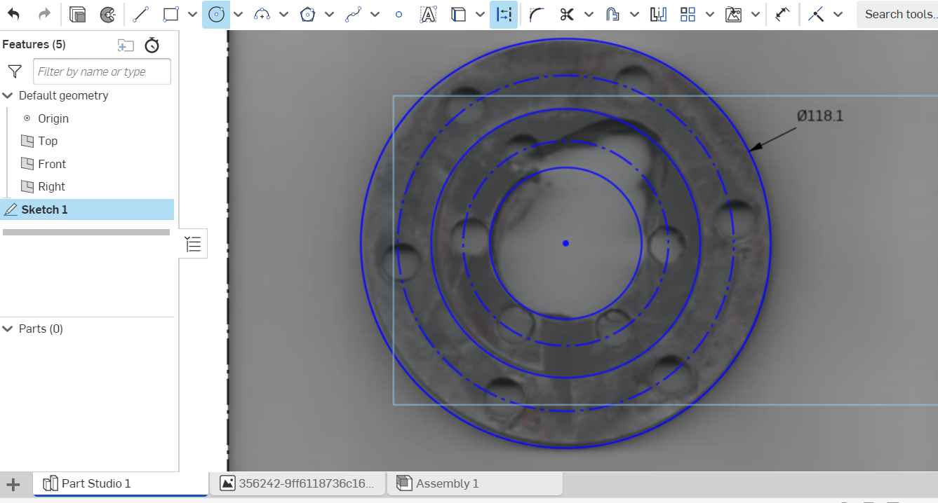

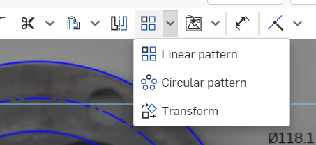

, this sort of thing is very easy in onshape. Sign up here (free): https://www.onshape.com/en/products/free
