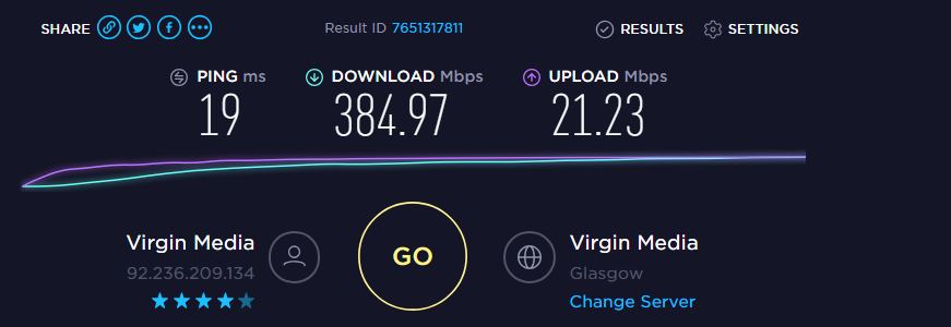

Thats not the point..lol I wanna know where my 80Mbps has disappeared to..lolI'd be happiest with your slowest result
look up the specs for the switch and the router, if either are the old 100Mbps then consider replacing or not using those

I am not that rich. lolThis is what I get using cat5e direct from the Supehub on a vivd 350 connection
However..I currently pay 57.30 for vivid 150 + tv +phone line which is no longer available as a package.This is what I get using cat5e direct from the Supehub on a vivd 350 connection
100>80switch is a netgear DS106...which is a dual speed one...sady upon further inspection its 10 and a 100 NOT 100 and 1000 as I first thought.
So that probably explains the low test through the switch...lol
