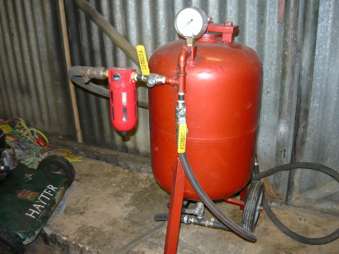

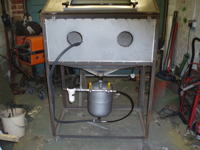

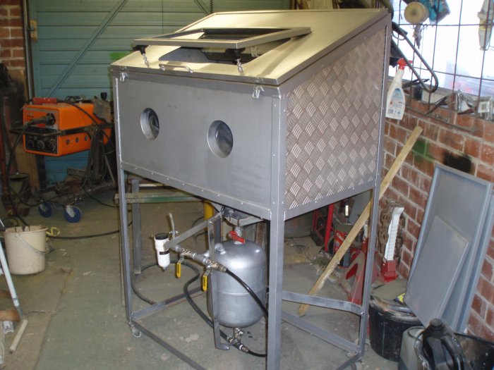

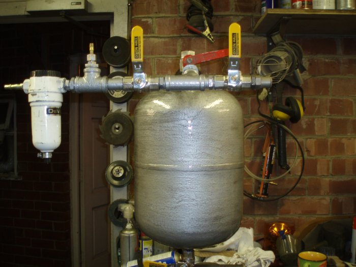

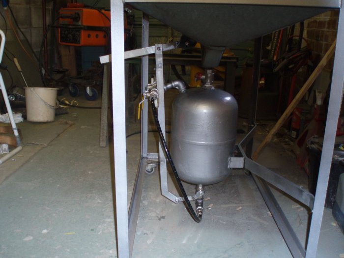

I have a 10 gall pot for bead blasting and I can do a Lambretta engine & magneto casing inside and out on one fill.
About the filling valve, if you opened it slowly with pressure in the pot it would blow a lot of dust out of the media and into the extractor - which would be a Good Thing.
