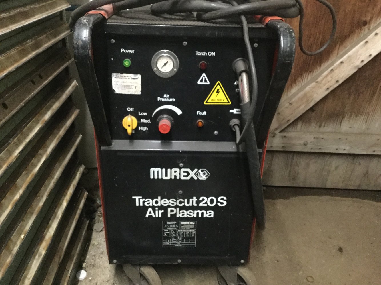

That looks like an older transformer machine.Hard to answer that, I bought a Murex tradecut 20s as spares or repairs for £100. Got it home and attacked the insides with an airline, it needed a new air regulator and that was about it. Been using that for about four years now with no issues. If it needed much more than that it would have gone in the scrap.

if it had needed more than that you also would have been out of pocket as well if it had of gone on the scrap pileHard to answer that, I bought a Murex tradecut 20s as spares or repairs for £100. Got it home and attacked the insides with an airline, it needed a new air regulator and that was about it. Been using that for about four years now with no issues. If it needed much more than that it would have gone in the scrap.
